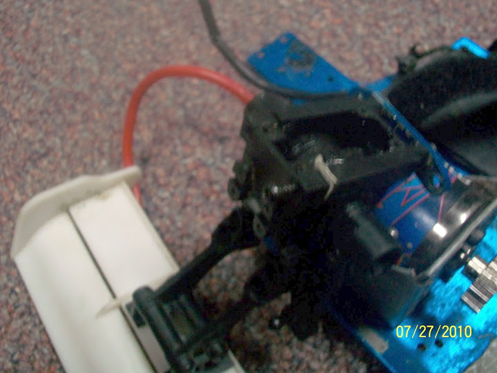

    well we finished things up today and it went very well
    first thing my paper washers... first 1, i then trimmed them with a knife
    sorry its kinda grainy but its a 100X better than it was before it hit the editor (btw the picasa online editor is super nice to have and very easy)
    here's a pic of the rear tower bolted up, and my super nice dog bone holder
    center diff in place
    the front end all mounted up...
    added servo arms and such...
    then majically and RX ESC and rear end apears on there (i forgot to take a few pics along the way)
    i knwo there isn't a ton on the outdives/pinions, i should've snagged a few more but didn't really think they were nessasary at the time but they would've been nice now that i'm posting stuff up... but its a pretty simple install like i said last nite, i'd set the bearings in the cases, (my front one got pulled out with the pinions) then pop the front pinion in holding that in place you should be able to get the outdrive in, they stay together decently, but can fall out, if you like hold it outdrive down it'll fall out...
    but i did shoot some vid, its okay, there is a good bit of gear/motor noise but the e chaos has always had that...
    [youtube]http://www.youtube.com/watch?v=CIEl2Q28aEQ[/youtube]
    was a bit squirly but it ran well, the diffs held up great, havn't pulled them apart yet, after the vid, but after some light running around in the basement, i took a peak, and they looked fine...
    now i get to really focus on setting up the diffs, i gotta see about de bonding the ca locker job i did on the rear... i hope boiling watter doesn't mess up the plastic... spun a driveshaft in the hub... i guess the rears don't need feul tubing in the outdrives....
    its a bad pic but you get the idea... thats why it was pulling one direction soo much in the vid under accel.
    thats all i got for now btw the lipo vs that 8 cell AA nihm pack, LIPO wins soo much lighter

    worK, I meant work. The e-Chaos is comming along nicely. So what exactly are the ring and pinions, and what kind of lube are you using in there?
    i used these pinions
    http://www.********.co.uk/metal-driv...-outdrive.html
    and i just used a dab of black grease on the gears but not a ton...
