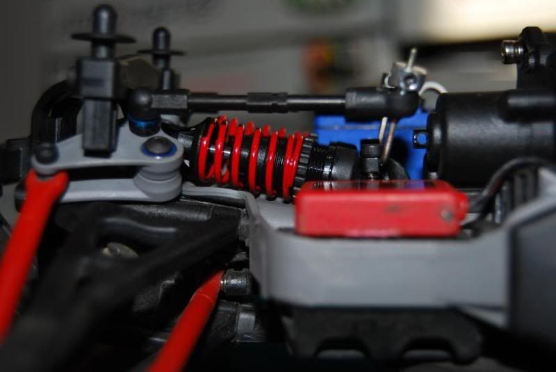

Just wanted to post some pics of how my progress has gone, so far ive already changed the Wheels, jumped the gearing MUCH TALLER than stock, cut some holes for air to get into the motor/esc, slammed the car on the ground, and im running 4S lipo ill get soem video soon but all i can tell you know is this bad boy FLIES!!!
PS i added a small fan to the ESC, i personally have never over heated the ESC but since ive read many people having problems i figured extra cooling is always a plus!

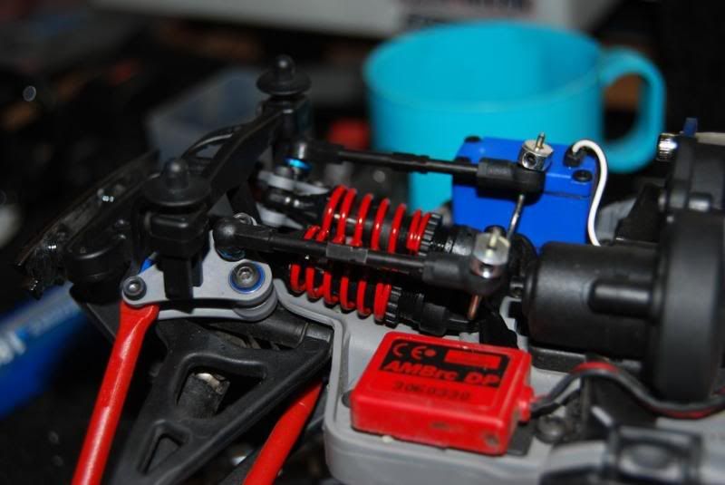

Ive been testing mine now app 3 packs, and i like it a lot, first pack, stock setup, way to soft.....im kind of pleased now running
100 in the rear with black springs
80 in the front with tan springs and swaybar.
i put in some drops of some real heavy diffoil in the front and less harder in the rerar app 2k o 5 not sure
with a 2s 1800 FLightmax it feels real good. using Goosebumps from jconcepts green compound 4wd fronts on Kyo rims. i hope i can take it to the local track soon
Swaybar like the bigger brother...working ace
