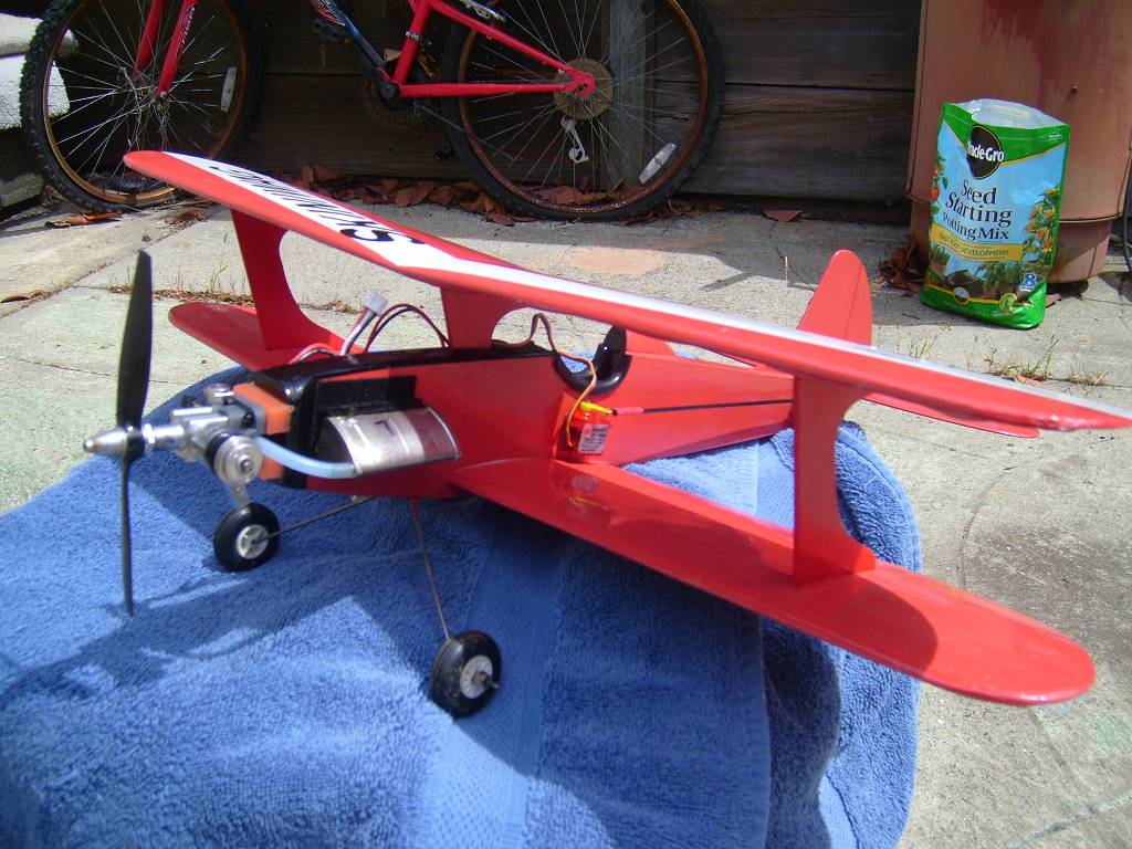

Thomas B .... What would you suggest using from Heads Up that would be behave like a Sure Start power-wise perhaps using a 7 inch prop instead of a 6 inch. 2 or 3 cell?

ORIGINAL: skaliwag
A Black Widow is rated just under 60 watts, but that only gets you into the ballpark. The electrics have so many combinations available that you can tailor for speed, duration or 3D. Here is a table that gives some data on how to match your motor with your needs.
• 50-70 watts per pound; Minimum level of power for decent performance, good for lightly loaded slow flyer and park flyer models
• 70-90 watts per pound; Trainer and slow flying scale models
• 90-110 watts per pound; Sport aerobatic and fast flying scale models
• 110-130 watts per pound; Advanced aerobatic and high-speed models
• 130-150 watts per pound; Lightly loaded 3D models and ducted fans
• 150-200+ watts per pound; Unlimited performance 3D and aerobatic models
It would really help if you let us know model weight, span and what sort of flight characteristics you're looking for. While I might have a Mini-Mambo and a flying wing that have about the same weight and span, the motor/ESC/battery combination would be completely different. The Mambo would be set up for slow flight with maximum duration while the wing likely will have a hotter motor, greater speed and much less flight time. The lekkies have opened up a whole new world in how we can power the planes as opposed to changing nitro content and prop size.

To replace a Sure Start on this 24 inch span bipe. Weighs in at 11oz. 200 sq in area.

A few possibilities
http://www.headsuphobby.com/Emax-CF2...otor-E-605.htm
http://www.headsuphobby.com/Firepowe...otor-G-555.htm
http://www.headsuphobby.com/Firepowe...otor-E-530.htm
That plane looks like a Ted Strader Chicken Hawk.

It does, but I don't think the Chicken Hawk had the interplane struts and I believe the top wing was close to 34", quite a bit larger than Steve's model.
Here's my hat in the ring (all from Heads Up):
HURC 250 Plus, 1300 KV, Wt. 20g
Propeller Test Data for the HURC 250 Plus Motor:
Battery Size Propeller Size Thrust (oz.) Amps Notes
3-Cell 11.1v GWS 7035 14.0 oz. 7.0 amps Avoid constant wide open throttle
3-Cell 11.1v GWS 6030 11.0 oz. 5.5 amps
3-Cell 11.1v GWS 6030x3 12.0 oz. 6.0 amps
3-Cell 11.1v GWS 5030 8.0 oz. 3.5 amps
2-Cell 7.4v GWS 8040 10.0 oz. 6.5 amps
2-Cell 7.4v GWS 7035 8.0 oz. 4.0 amps
2-Cell 7.4v GWS 7035x3 8.5 oz. 5.0 amps
2-Cell 7.4v APC 7 x 6E 8.5 oz. 6.5 amps
2-Cell 7.4v GWS 7060 8.0 oz. 7.0 amps Avoid constant wide open throttle
2-Cell 7.4v GWS 6030 6.5 oz. 3.0 amps
2-Cell 7.4v GWS 6030x3 7.0 oz. 3.5 amps
HURC 10A ESC, 1A BEC builtin (12.7g)
Use either a 2s 800 mAh (42.5g)or 2s 1000 mAh (57g)
A Sure Start with a 6x3 prop weighs 54g, so dropping the RX battery in place of the BEC, the fuel tank and throttle servo, weight would come close to being a wash.
I would be inclined to run a 2s, either the GWS 7035 or 7035x3 and go for duration.
