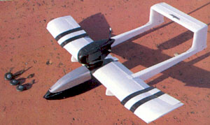

Hey guys,
Received my plans from AMA on a potential addition to my hanger. Plans call for a 0.15 O.S. Max with a low profile Tatone manifold mounted inverted and fully enclosed in a cowl.
Not familiar with this size of engine, do you guys have any recommendations for this or a different engine? Plans are from about '84 so I'm sure there are a few new choices in engines. Being a seaplane I could appreciate all the power for weight and don't mind stepping up to a .20 if the weight is comparable.
Thanks for your thoughts.

On the subject of torque vs RPMs, the plan on this bird calls for a 7"x4" Graupner prop. In this application I would guess that the high rev engine would be favored if only for the limited space allowed by the pylon atop the wing. Stretching the pylon would really screw things up. So I'm thinking the K&B might be the ticket. On the other hand, I see that the 1.15 BHP is with a tuned pipe and 30% nitro, AND the recommeded prop range is 8x6 to 9x5. My plan won't even fit an 8" prop and of course the tuned pipe is moot. Perhaps the K&B is simply too much engine? (I didnt think I'd ever say that.)

A few more specs on the plane:
Span - 40"
Weight - 40 oz
Wing Area - 250 sq. in.
Wing ld - 23 oz./ sq. ft
Airfoil E193, E193M
5 channel
flaps 65% span
Seems pretty heavy to only have a 7" prop. Since the K&B seems to have the power, would a three bladed prop be of benefit here?

I am guessing that the prop limitation is due to the engine pylons location. I have a norvel AME .15 in a sig wonder, which replaced the conquest .15. Both of these are speed type engines as opposed to being a lugger lugger.
I would think that a seaplane would need thrust more than speed, therefore the best solution would be a larger diameter lower pitch prop. Since you are limited to a 7 inch prop, my suggestion is that the lose in efficiency with a three blade prop would be acceptable due to the increase in available thrust.
Good luck.
Good luck.

That's my thought too Poodle. With the inability to add more blade area with length, the only other option is to add enother blade. Efficiency would suffer but might be an acceptable trade for thrust. With the K&B the power would be there.
I measured and there is only 1/2" clearance between the prop tip and top of wing. I even brought a pic for show and tell.

40oz!!! No way dude! You can do better than. Modern radio equipment and choice wood, you could bring it in at 32oz or less. That thing would fly with a .15la anyway. Nice planform and a big wing. The Big Mig would probably be my choice.
There's not much to be gained with a three-bladed prop at our sizes, if you can find one that is 7". Pick your engine based on weight if possible. The lighter, the better. (thus, the big mig)

Yeah, its kind of a tub, but the weight is all in the wood and the linkages (of which there is a lot) It calls for Futaba s-33 servos all around which are pretty small and only uses a 2 oz tank. But fully sheeted fuse and wings are the killer with lots of ply throughout.
Finding a 7x4P 3-blade is a pretty tall order too. No makey.
I'm thinking before I build a full size, I might knock off a really stripped version for an .074 for which I have all the equipment.

Be sure to use Lite ply and not birch for everything but the firewall. That makes a very big difference. Balsa doesn't really weigh squat unless they specify oversized stock. I've seen a .40 size plane that was planked with 3/8 and sanded to shape. It flew ok, but was heavier than my b..ls. If he had just dropped down to 1/4 it would have been a decent plane.
RE: Recommendations for a .15?
If I was to attempt this project with a .15, there would have to be some major changes. The plans would be there for outline reference, and to get some ideas from, but that's about it. The best flying planes off the water are the light ones too, the same rules apply as when flying over dirt ! If you were to raise the pylon just a little, you could run a MAS 8x3 prop a this will give the .15 its' best pulling power. I have an OS .15 / 8x3 on a 40 oz SSC plane and it pulls it around real good. Of course we're talking about a 64" flying wing where 80% of the models' weight is dedicated to making lift. After seeing what you were able to accomplish with your contest plane, I'll bet you are easily up to the challenge of building this plane lighter and just as strong.
