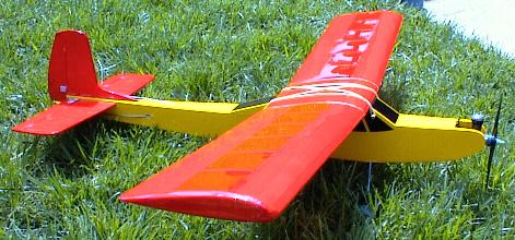

Here is a pic of the whizzard I have been flying. This has a replacement Ace wing on it, which seems slightly different than the original. 3 chhanels, R-E-M. Ame .049 with throttle. great flying little plane. It has a replacement wing because I flew the plane past the battery safe point last time and augered in.

Cool! I probably talk about my Whizard too much around here, but that's because it is an awesome plane in my opinion! Was yours kit built? Also, can you post some pics of your engine mount and servo installation? I suspect my servos are mounted too far back (or the pushrod setup I used is too heavy) so I have to tape a couple of quarters to the front of mine before I fly it!

Like the looks of yours as well! The white with red is a cool look.. With a TD, yours must really haul, and I think you're on to something with not doing the stock landing gear wire- that way, if you want to add a landing gear later you can, or for long grass fields you can go without. I too built mine from plans, and I think I will build another one, full-house this time. That way, if a newbie wants to train with my original one, that's ok, but for more aerobatic manuevers the full-house one will rule the day.
Judging from the sounds of it, I mounted my servos too far back (mine are just in front of the rearmost bulkhead in the fuselage compartment).. Perhaps if I switch out the black widow for the Norvel .061 R/C with the tank/mount, the added weight of the throttle servo up front (and I think the tank is bigger too), It will balance out OK.. Also, instead of the foam (which is probably 1000 times more durable), I built up my wing from balsa using my own design, but using the original airfoil, and the basic physical dimensions.. I think my wingspan is about 42" IIRC.
Love these little planes! What a cool fuselage design! Tabbed crutch, also the front end is extremely solid! I wonder how different the "Super Whiz Kid" is, or if it is the same fuselage and tail feathers, with an aileron wing..

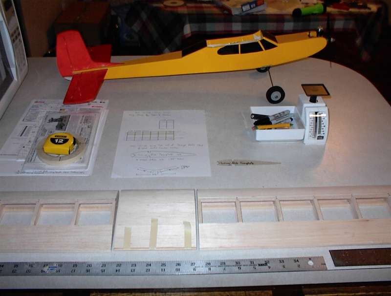

The plans don't explain how to build a wing from balsa, but the plan does have a airfoil, and I used that to build a built-up wing. I made a center section, and two side pieces. Essentially, I cut a ">" shaped notch into the face of each airfoil wing rib, so that I could glue in a 3/8" square leading edge. I sheeted the back end top and bottom so that it shaped a nice trailing edge. I then used spruce for an upper and lower spar, and they stick out past the surface of the wing rib the thickness of the balsa sheeting I used. Next, I sheeted a "D" tube in the front from the leading edge up to the spars on the top and bottom. Finally, I made cap strips for the top and bottom of the airfoil ribs.. Don't worry if I'm not making sense- a pic is worth a 1000 words(see below).. I sheeted the entire center section, and I made two 3/16" thick balsa airfoil ribs that I then tapered (thinner on top edge) to fit between each outer wing section and the center section, so that there was no gap when each outer section was propped up to give the wing proper dihedral. I also used thicker airfoils (can't remember if it was 1/4" or not) glued onto the end, and then rounded, for wing tips. I think this might have been 3/16" balsa though, to save weight. If I recall correctly, I just put 3 CD jewel cases stacked on top of each other, and propped the wing tips with those jewel cases on each side- High tech, huh? It came out plenty strong, and light. I'll even go so far as to say it looks pretty good too!
Here's some pics:
Also, you can buy a kit still- Thunder Tiger bought the rights to make some of the Ace simple series kits again, of which this plane is one of them.

Thanks for the compliments on the wing, guys! I was quite satisfied with it, although I bet it took me 20 times longer to build one up then it would take to just build the foam wing! I'm still working on an Ace T-6 Texan, and for this plane I think I might just build it with the stock foam wing.
