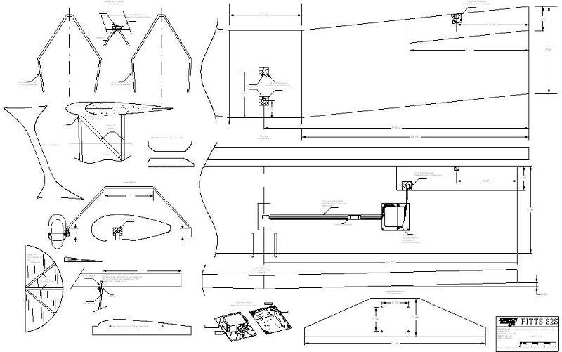

I'm starting a new project. It's not 1/2A, but it is SMALL, so I thought I'd do the build thread here.
I have a .30 four stroke that is looking for a home, so I'm building a small Pitts with a 34" span.

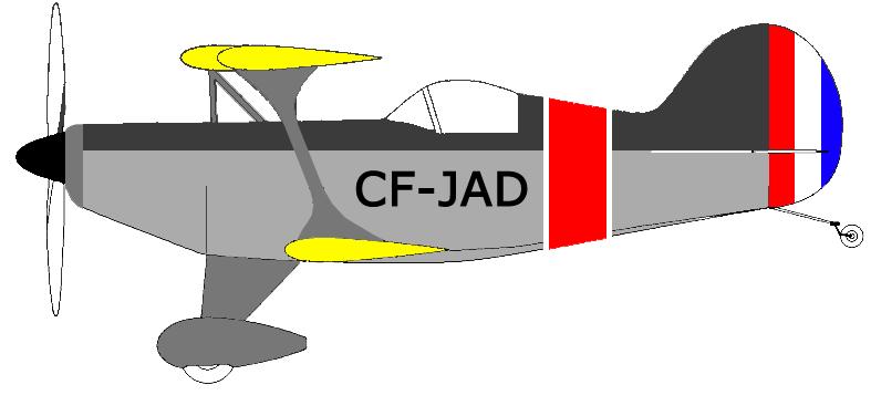

I'm going to do it in an early biplane trainer style colour scheme.

Are you making plans available? Looks like a fun project.

Where does the smoke oil tank go...? GRIN! Looks very cool...would like to see the ribs, though. I have the free demo version of Compufoil, about to buy most of the modules so I can start drawing a few myself...already have TurboCAD 3D, too.

Yes, I know it's a stretch. Me, building a biplane.
It's basically a scaled down, simpified version of my Bulldog Pitts and yes I do have wing plans, but no ribs. I don't usually build wings that way.
If it flies OK, I'll make the plans available.

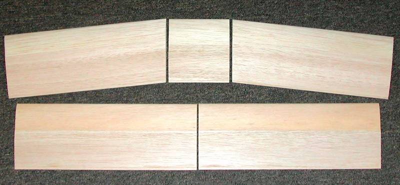

The wing cores are sheeted with 1/32" balsa and Polyurethane glue.

Default RE: Small Pitts
Trimmed for joining.

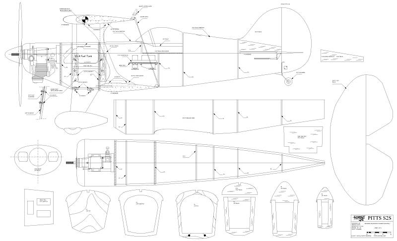

What I'm building is a scaled down, simplified version of the .40 sized "Bulldog" Pitts that I designed a few years ago.

I think I recognize that color scheme.... Sig Liberty Sport biplane?
(I've had two of those in the same scheme.... one sport scale (with a .46 and monokote), and one totally scaled out with a .60 and cloth/paint)

Yeah, the Liberty Sport scheme is the inspiration. I saw a picture of a Pitts done up like a Curtiss P6 Hawk (green instead of grey) that looked pretty good. Biplanes like the Boeing F4B-4, Curtis P6 Hawk, Grumman F3F and even the Beechcraft Staggerwing were done in similar schemes for the US Navy.

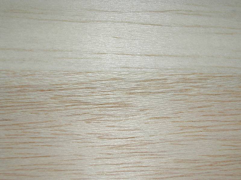

Hi Andrew, nifty lil' biplane there! I'm curious as to your sheeting process with p/u glue. I assume you spread it on the sheeting and scrape off almost all of it to get it as light as possible?? Prolly doesn't take much.

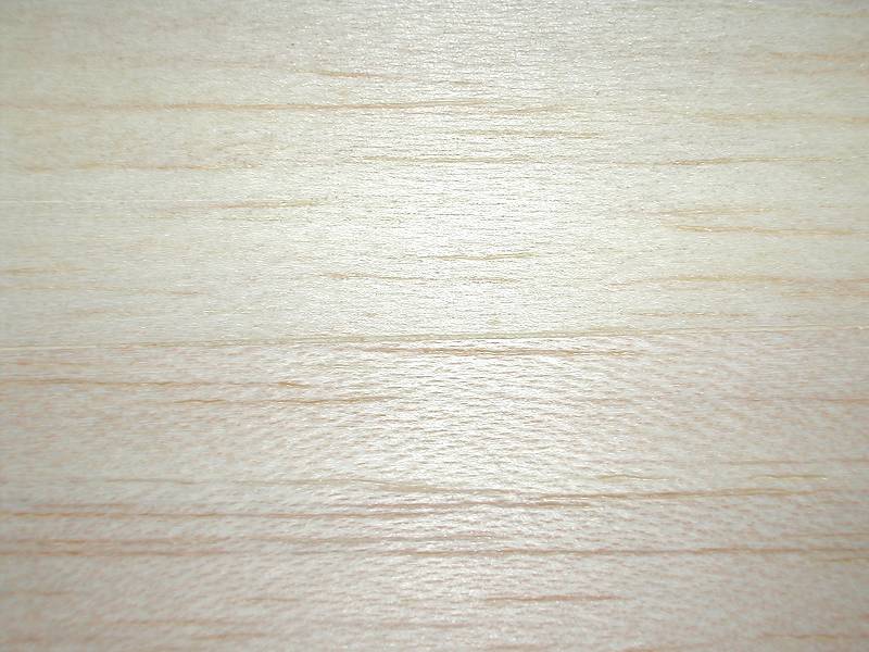

Yes, just run a bead down the centre of the balsa sheet and use a playing card to spread a thin coat; just enough to look wet. The sheets don't need to be joined before sheeting either. Just coat the sheets and lay them over the foam, tape the seams, mist the entire wing with some water, put them back in the foam saddles and lay a board on top with about 50 Lbs over night. The glue will foam into the seams and can be sanded flush the next day.
Here are 2 close up pictures showing the difference between a tight seam and one that has a slight gap. The polyurethane fills it for you.

I've started framing up the fuse.
