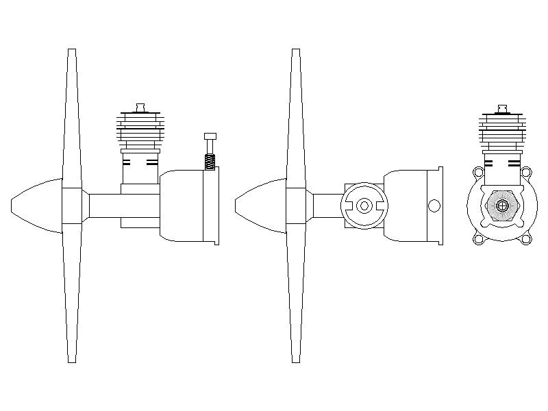

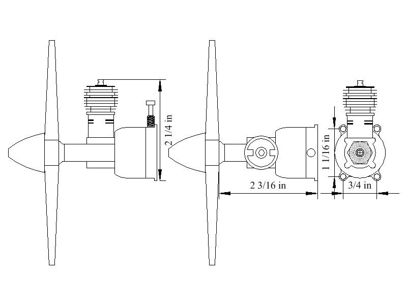

Kid, this is what I've got right now on the reedies. At home I've got some Surestart backplate measurements. I'll try to whip them up later. I'll put some CAD files on my site later also.

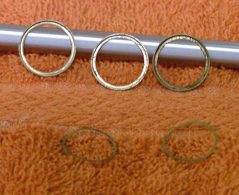

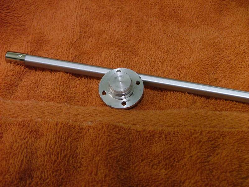

But wait...theres more.
Photo 1 is a Kavan fuel tank extention shown is for the Baby Bee. Seal these up with silcon sealer/adhesive.
Photo 2 is a crankcase plug for the 0.049/0.051 Tee Dee's. This may still be available from Texas Timers.
Photo 3 is of KK Timming gaskets. These were place under the cylinder to change the engine timing.
Enjoy - Steve B.

ptulmer- Thanx, very helpful for model planning stage.
Just got told the SureStart can't be used a s pusher because it lacks a thrust washer, but then the quality posters here at rcuniverse let me know I can retrofit a washer from a different motor on it. Perhaps this tip could have an indepth entry from the gurus here for others in my boat.
--edit- I see in the pic the crank has a spline for the driveplate, is that a hard press or can I get it of by hand. Etch a few radial oil lines in the face of the case, & cut a brass shim thrust washer. Then, the shim should go on and replace the driveplate? What does the propscrew tighten against... will it squeeze/bind the shim washer I install?

This FAQ is paying off bigtime already.
I wonder why Cox decided to omit the thrust washer on SureStarts if it's just a SS or brass shim... it can't be for saving them $millions for a two cent peice of punched stock.
Thanx Tim

Also AFAIK, none of my Cox reedies have this.
You won't need this in a pusher configuration at first. Just check that the crankshaft can not be pushed into the reed assembly, and supply said washer before it does. It may have to wear some before you can even get a washer in there. And that may take many hours of running.
It probably isn't worth the effort. You can toss the engine and replace it for seven bucks.
Just my opinion. Your choice.
George
Edit: Removed first paragraph due to Tim's correction below. Altered next paragraph...I don't have a Killer Bee.

George,
The back of the prop rests on the prop driver. The thrust washer is a thin washer between it and the crankcase. The Killer Bee uses this.
LAter,
Tim

Ive been running a Cox product engine ( your guess) as a pusher for some time and its got no appreciable end float in the crank , BUT!!! it has the bronze prop driver, and black plastic backplate. I think these motors with the bronze propdriver were intended to be used as pushers ?
Stewart

SGC, I think the bronze thing is just from a certain time period. I have one that's about five years old. That about right for yours?
gcb, I don't know about the pusher config, but they wear relatively quick when using a starter. Like you said, after they wear down some, the washer fits nicely!

Ye about 5-6 yrs ago i bought 1/2 doz out of a bucket of ex Cox warranty returns, there was nothing wrong that cleaning the needle/fuel inlet didnt cure.
Stewart

SGC,
I believe you are correct on the bronze prop driver.
LAter,
Tim

Thanks for the information on the Killer Bees thrust washer. I will look for it on the 1 I ordered with the Micro Bird. I use starters on everything now. My reflexes are just too slow.

ORIGINAL: Tim Wiltse-RCU
KE,
The crank is pressed onto the prop driver.....just screw on the prop bolt and give it a good couple hits with a hammer.....
Tim, Tim, Tim..... I'm shocked. You and I know that "a good couple hits with a hammer" means light taps that just move it enough to get it out but some folks may take this to mean "whack it like a 6 inch rail spike".....
I used to tap it off like you using a hammer but I found that I bent the odd prop screw and that the end would get peened down and not let the screwdriver in any more. Now I use a vise to push them off instead. I insert the prop screw all the way and then put the case and prop screw between the vise jaws using scraps of thin plywood or clean sheet aluminium as pads to prevent marking. Line it up so it's all in line and then push the crank out the back of the drive washer.
I re-install same as you do.
Some of the engines do not have much fore and aft play. For those it's going to be much harder to install a thrust washer. For the rest there's often a good 10 or 15 thou of play. You can test if the metal will fit by pulling the drive washer forward and inserting the chosen shim material. If you can slide it into the gap and there's still a degree of fore n' aft movement that you can feel then it's OK. I'd suggest something like 4 to 5 thou shim material. Even 3 thou would probably be fine. Any thinner and you risk the metal crumpling if something gets caught in there.
For the engines that are tight enough that you can't get the 5 thou shim in there and still have about 5 to 8 thou of play then you gotta get more serious.
A lathe would be the ideal solution to trim the case down by a few thou.
In a pinch you could use a drill press and a dremel end cutting burr to trim the case. In this method use the depth stop to ensure all the plunges are the same and take off only a very small little nibble at a time and then move the case about 1/32and take out another nibble to prevent the end burr grabbing and pulling it out of square. Just reduce the whole end by about the thickness of a couple of pieces of writing paper. That's about 6 thou the last time I checked.
You can even do it with a hand file. Pad and grab the case firmly but carefullly in a vise and take of a couple of strokes off the end with a fine tooth file. It would help if you put a scratch mark about 5 thou down on the outside and file down to that line. Use the crankshaft inserted from behind to check the progress for distance and rough squareness. Don't go too far and try to keep the cut end as square as possible. Now mark the filed end with a felt pen and push the crackshaft in from the nose end and turn it around a few times to scuff off the ink from the high spot(s) and remove. With a careful touch just file a one inch stroke off the shiny bits. Now re-ink and re scuff with the crank. Keep doing this until the high spots are cut down and you have an even scuff line over a good portion of the end face. Deburr lightly with the file on the outside and an xacto knife on the inside as you go to allow the crank to go in easily. As a final step I suggest a bit of 400 grit wet or dry with a hole punched in it and placed over the crank and use that to polish the end face a little and level out the worst of the remaining high points. Now wash it all up well with some hot and soapy water, dry, oil and assemble. The whole thing will take you about 20 to 30 minutes. Work slow and attentively and try to feel the seating of the file. It's fussy work but with the ink and some reasonable care similar to what you use already for general model building it's very doable. The key is to use the inking and scuffing to sneak up on the whole fit in very small steps. Especially when you start getting lots of shining points from the scuffing as that means you're REALLLY close to a great fit.
