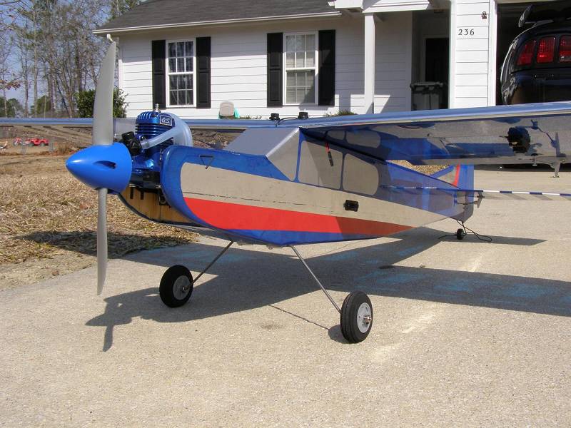

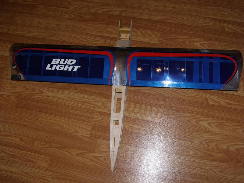

I have been working on a Herr Cloud Ranger off and on now for the last couple of weeks... more off than on Any way this has been a build of inspiration and my inspiration is duely noted on the plane

I picked up one of those kits too. What did you think of the kit? It seems like it'll be a bit much for a .074, I'm tossing the idea around in my head of making a trimotor out of it using 3 AP .061s....

An .061 by it's self would fly the plane. Just not all that exciting, it's a trainer afterall. However mine will be outfitted with a OS .10 and I have converted it to a bolt down wing. Your project sounds like it would be a real rocket.

Alright! I finished it Today was a beautiful spring day and a perfect day for a maiden flight. Although the Cloud Ranger is technically a trainer. I have it set up a little more sporty. Outfitted with an OS .10 LA w/ an APC 7x3 and rediculous control throws this little booger is a blast. Pretty quick and snappy. Ground handling was easy for me but my buddy had a time with it when the wind kicked up a few notches (the only 2 minutes that there was more than negligable wind today). I found that the rudder is highly efective on this plane and will roll simply with the rudder only... an ugly roll, but a roll. To much dihedral for a good snap roll though. and to stable to put into a decent spin. I have the CG a touch aft (1/4 inch) of the recomended. I also installed the fuel tank (4 oz) pretty close to on the CG instead of the normal forward location. It has Hitech HS-81 servos and a Hitech 6 Chanel receiver. All in all a great little plane. I think this plane is why Rog is not allowing .10's in the unlimited class for the CC races, because it will start and stay running long enough to finish the five laps. I have to go to Jersey for the next to weeks but will get a video posted when I get back.

Hey guys, I took the Cloud Ranger, aka Miss Bud Lite, out again today. This plane is just a lot of fun. I would recomend it to anyone with a .10 - .15 laying around and $35 for the kit. I did have to reinforce the lower part of the rudder due to the tail wheel wire breaking out of it. I just laminated two peices of lite ply on both sides just big enough to add support where the wire goes through the rudder. Thought I would bring that up for those of you that build one.
