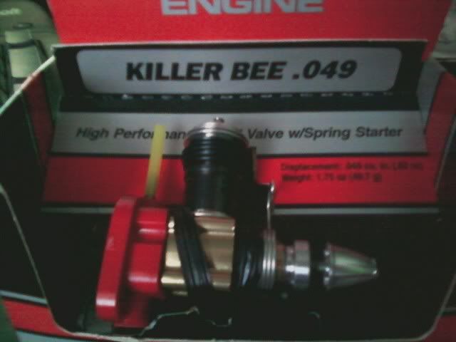

I'm finally getting around to posting my Mixed Parts 049's
The Black Widow is the most "Frankensteinized" (I have 2 identical copies of this one):
