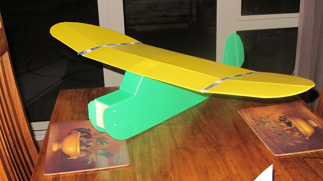

In the end I think the Coroplast is to flexiable as the pane flys pretty badly. So I rebuilt the Fogey in foam board

The Turnigy L2210 1650kv should solve the problem for another 26 Grams well forward, and I get double the thrust. I still needed to move the GC forward with the 24 Gram so the bigger 50 Gram motor solves that without adding ballast.

Progressing mounted the servos on the outside so they areaccessible. Now with a yellow rail fin with Bamboo spars, still nice and light.
Motor mounted and made a hatch over foam nose structure for the RX and any other bits. The ESC will be on the bulkhead in the air flow
The 610mAh battery ismountedwell forward withVelcroto get the CG forward, the CG seem stubbornly to far aft will probably need some balance or a 1000mAh 3C to balance her out.
Myglue lessCoroplast and25mm thickextruded Polystyrene foam construction using high strength double sided tape and Bambooskewers
Currently theair frameweighs 376 Grams bare, not servos, radio, motor or battery.

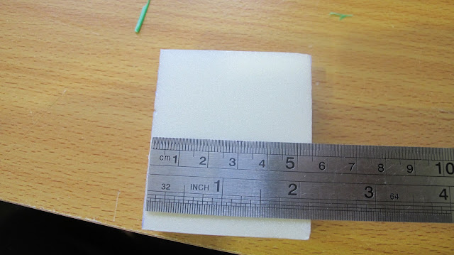

Cut a 55mm piece of foam for behind the screen upto the leading edge
55 X 64 mm
Fixed and chamfered to accept the wing section
