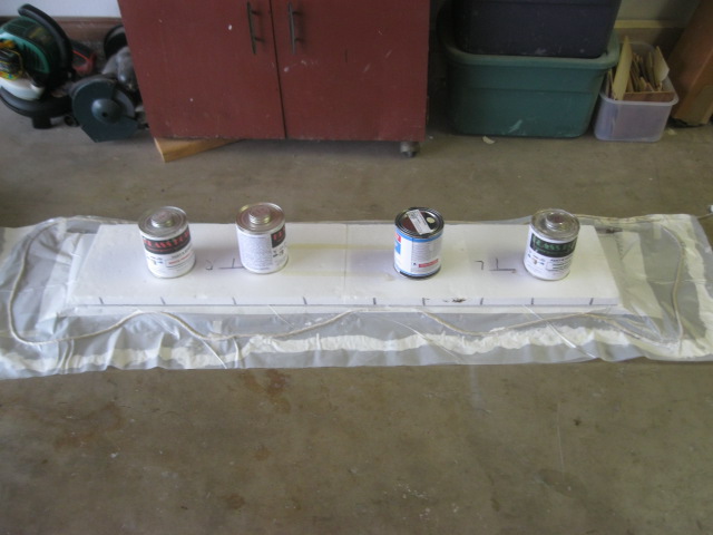

The wing is then placed between layers of peel ply and placed in the vacuum bag.
After most of the air is removed, the vacuum bag was placed between the wing shucks.
Weights were applied on top to hold parts in place.
The vacuum was then turned on and parts were then allowed to dry. The pump pulls about 6" of Hg vacuum.
