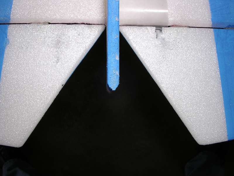

I just couldn't stand the tape hinges at the tail anymore so, With the post and a PM from Mups53, I Tried a couple of options for hinging. Thanks for the help Mike. It made everything go very smoothly. I hapen to have a balsa stripper, so I didn't have to make the tool that Mups discribed to me as a #11 blade CA'd to a piece of ply that would cut the hinge slots nicely. Either way would work great. I decided on the DuBro small barrel hinges although the CA hinges would do nicely as well. At $3.50 for 15 of the barrel hinges, I figured it was worth it. I flew it this afternoon and let me tell you, controling the tail hinge line was a bigger help than I thought it would be. When I started, I was only going to double bevel the rudder but decided to do the elevators the same while they were off.
Here is some pics of the well worthwhile update to your flat foam planes tape hinges.
First I used some 220 sand paper and a flat piece of ply to sand the other side of the single bevel into fuse and stab. You can see the elevators are already done and the beveling for the rudder is ready. The wax paper is to keep any joiner wire epoxy from getting on the stab.

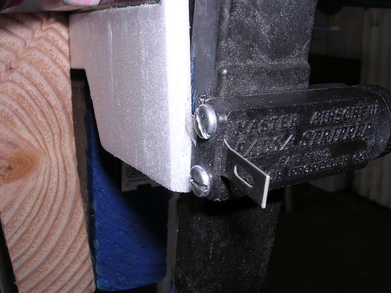

This shows how I set up my balsa stripper for 3mm and used it to center the hinge slots. At Mups suggestion, I set the depth to be just a touch more than the inserted part of the hinge. this worked very nicely even on the prebeveled surface. Mups53's tool would work fine as well if you can get the foam flat on a table or hold a flat surface against it. I just happen to have the stripper.

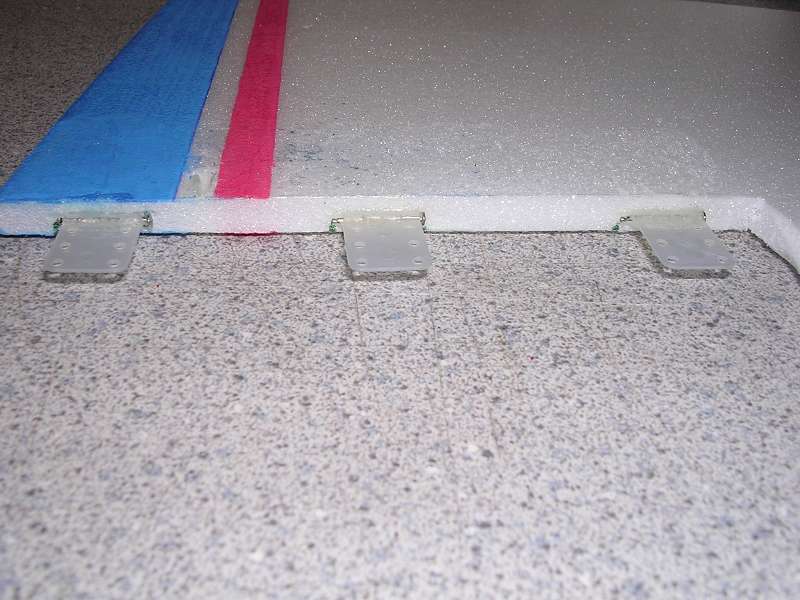

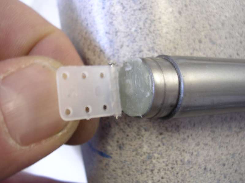

It is important not to get any epoxy in the barrel of the hinge, rendering it worthless. I reached into my pocket and applied some soft chapstick to both sides of the folded hinge barrel. This works excelent. Just don't get it where you want the epoxy to stick.

I was using 5 min epoxy, so I first put the hinges into the control surface and left the barrel completely exposed. This gives the greatest deflection. I used a "T" pin to put some epoxy into the slots before inserting the hinge that I coated the first 2/3ds of. Once the three hinges were inserted and the epoxy was just going off, I folded all of the hinges against the edge of the control surface and aligned them by eye to have the same depth and hinge line. Not that hard but kind of critical.

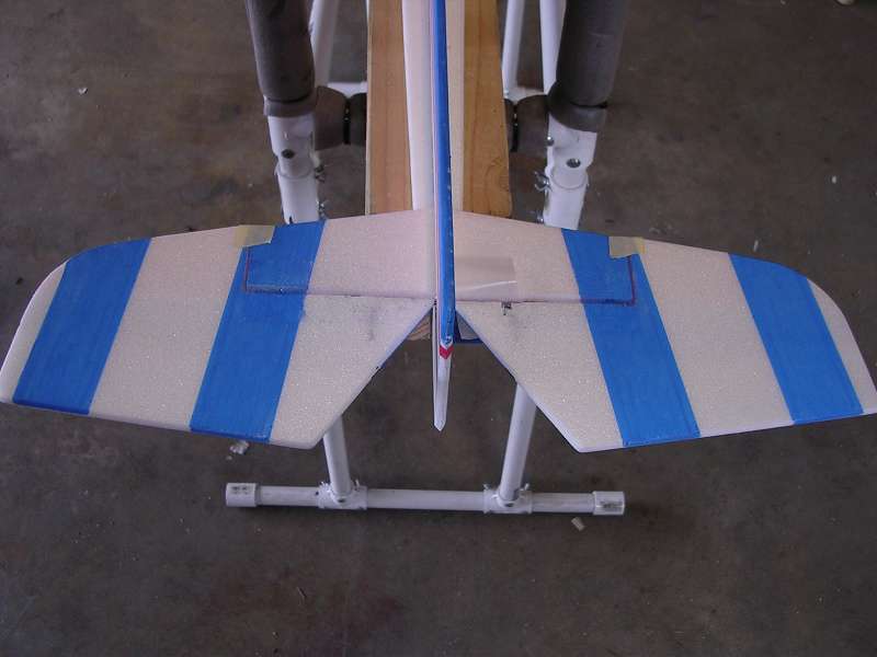

I installed two hinges on each elevator half and used a music wire joiner. I epoxied the joiner to one of the halves first. After that half was firmly attached to the stab, I attached the second half in it's place and taped both elevator halves to the stabilizer so that the epoxy in the holes for the joiner would dry with both elevators at the same angle. After this inexpensive upgrade, the hinges are very free and hold the center line great. You can tell in the air even though such things are not supposed to be that critical on these planes. The pull/pull system stayed in perfect adjustment for the flight when it would not before. I noticed that one of my ailerons is starting to pull the tape up now. Guess I got some more upgrading to do.
If you find $3.50, some epoxy and some free time, I would highly recomend upgrading your Foamy this way. I had to do a little touch up on the paint where the tape pulled it off as well but I think it was worth it.
