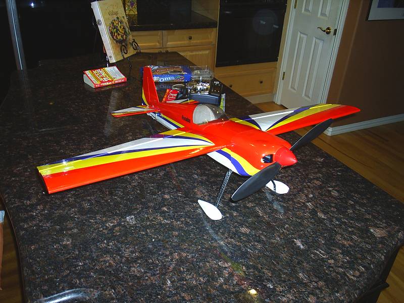

Hey Guys
I just got my Edge going. Here is what i got:
1. Blue Birds All the way around ...not sure which ones.
2. Castle Creations 25
3. Hacker A20-20L
4. 3C Li-poly 11.1 2100
5 5 Channel FMA Reciever
I had to ad some weight to the nose. Even with everything forward. I purchased it RTF minus Batt. and Reciever. for $200. It was an ok deal not a great one. AND HOLY %&^%^&% THAT EDGE DOES THE BEST KNIFE EDGE SPIN I HAVE EVER SEEN!!!! IT LOOKS LIKE THE PLANE WILL BLOW UP!!!!!
