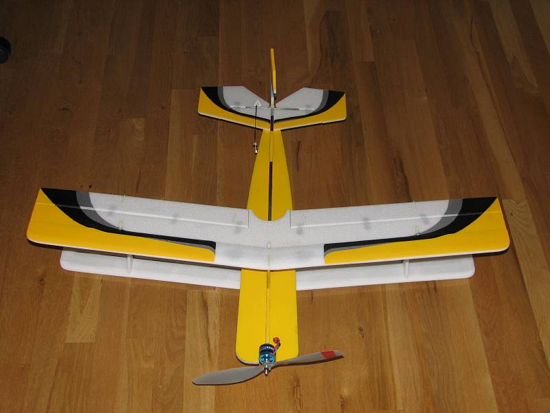

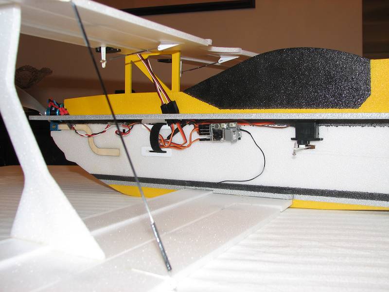

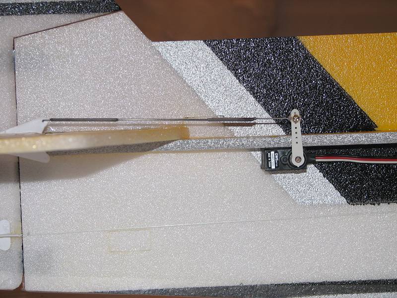

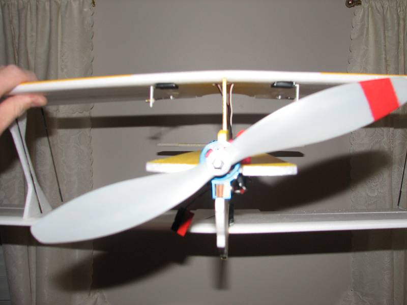

Well the airframe is now 1 piece. It's all glued together and wow is it rigid, especially for a foamy. There were no surprises gluing it together, basically just run some glue on the parts being assembled and dang near snap them together. The aileron cross connects are completed, and the other pushrods are all assembled. The rudder is going to be pull-pull using monofilament line. I decided to use a pushrod on the elevator.
The rudder and elevator servo locations have been altered from the current design to nearly match the original locations. I just prefer them and by moving the rudder servo forward I can use pull-pull and eliminate a servo extension.
This plane should fly by this weekend.

I've decided to set up the motor with no right thrust. A lot of park flyers are that way now with little effect. I can always shim it later if need be.
The ailerons are done, the elevator is done, the motor and ESC are installed. I just have to pick a spot for the Rx and get the rudder servo setup.
Depending on the weather and how I'm feeling I hope to fly it this weekend. I don't care if it's cold(I like it cold), but I prefer fairly calm winds for a maiden flight. Also I currently have a broken vertebrae, T1(located at the baase of the neck). Somedays I'm okay and somedays, like today, I can barely move my head.

I tried really hard to keep it light shooting for a target weight of 13oz AUW and it weighs 12.5oz without the battery. So I will end up at 14oz, about 1oz over the target weight. There's really not much I can think of to do to drop the weight, heck Levi designed the plane such that there isn't really anything I could to do the airframe to reduce weight(he did a really good job) except be cautious with the glue. I mean I could get new servos at a cost of almost $100 and save .5oz, I can't get much lighter than a CC10 ESC and my Hi-Max motor is not a heavy motor. I'm already gonna run TP 3S 730mah li-po's on it. I may end up swapping my Hacker A20-20L in of my Skeeter 30 with the Hi-Max. The A20 will be huge power with only a .25oz weight gain for the CC25 ESC. FWIW, the advertised weight is 11.5 - 15.5oz so it's certainly within that range.
All that's left at this point is to determine where the battery needs to be located for CG and glue on the plastic plates that keep the velcro strap from cutting into the foam. I did at least end up slightly tail heavy as I planned to without the battery so it can be mounted near the CG.

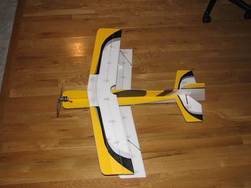

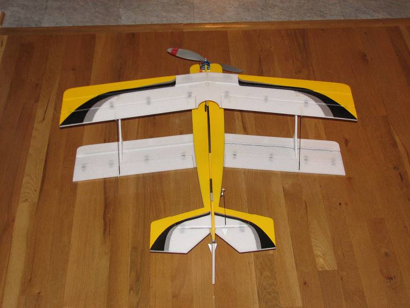

Well it's ready to fly. My Hi-Max 2812-0650 will have enough power to hover and pull out a little. I suspect I am gonna want more power since after flying my 14oz Skeeter 30 with the Hacker A20-20L I have been spoiled by rediculous power.
I have some pics to upload of the completed plane and a few close ups of the electronics. I need to get some 3" extensions for the aileron servos, but for now 6" will do.
I'm really impressed with the way the airframe turned out. It's very rigid, it can be picked up by the wing tip with very little flex in the wings. I have high hopes for the flight performance. All that's left to do is a range check, wehich I expect will be uneventful as this ebtire setup was in another plane until a couple weeks ago, but we'll see. If the wind cooperates I will try to get it airborne tomorrow.

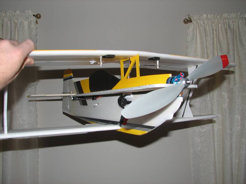

Well against my preference I decided to swap out the hard mount for my prop for a rubber band mount since my Advantage does not have landing gear. This is my first plane without landing gear in about 15 years. The rubber band mount doesn't hold the prop very tight, of course not like a hard mount will. So how many times should the rubber bands be wrapped over? Currently I have the 2 rubber bands that came with my Hi-Max motor simply doubled over. Ya know, looped on 1 side, wrapped around the other side and lopped back onto the opposite side. I question whether this will hold it well enough since I frequently hear the prop flexing in flight when I pull hard on my park flyer planes.

I know the rubber bands don't hold well. This is the first time I have ever tried them figuring they wouldn't hold well and they don't. Hmm, the O-ring still flexes enough to protect the prop and prop shaft on landing? I've got several O-rings around here so I'll see what I can come up with. Thanks.
