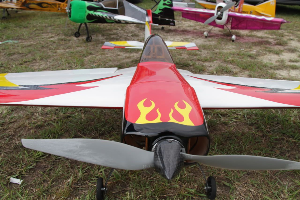

Default RE: Precision Aerobatics Katana MD Build and Fly
My KMD....
