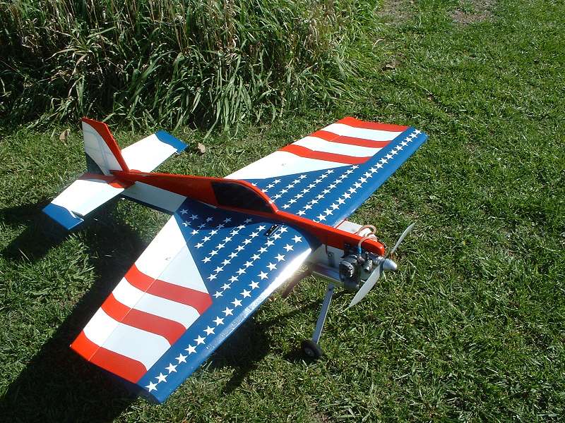

Posts: 224
RE: .46 Thunder Tiger and 3D Airplane
Here's my sledge I flew it over 25 times in the first week and did not have any proplems getting it down on the deck hovering [:-]
