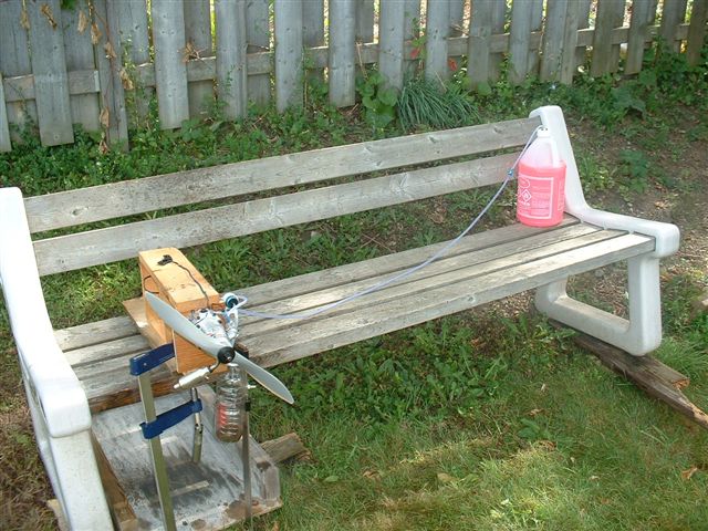

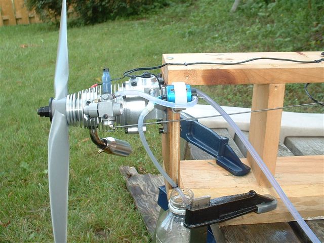

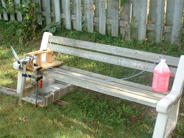

I have the VP-30 pump with an RCV-90 4 stroke. The pump can draw fuel pretty far as seen in the pics. The first pump i had was defective and sent it back and received an replacement free of charge. I don't have any info on the VP-20 or the satio 180 requirements.
