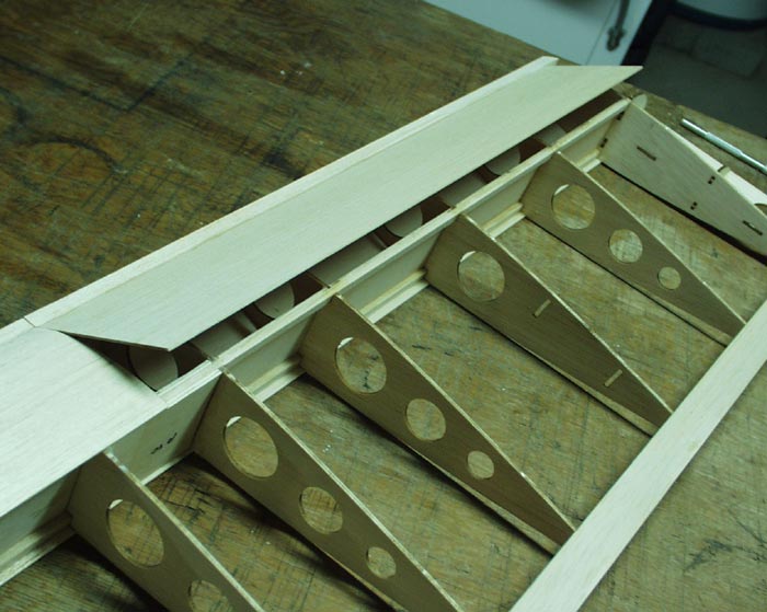

sorry for the delay, again. i kinda got side tracked by getting my electrostreak electric going. anyway, i got the third sheeting panel on, and i will now do the third when it is all dry. here's how i did it.
First , using medium CA, i glued downthe leading edge, slighty cocked up to get it good and angled in. then i spread 30 minute epoxy all over the rib and spar areas to be sheeted. finally i used about 4 punds of blue masking tape and blocks to hold it all down correctly. i will take several pics, one with tape on, and several showing joints, etc. at about 10:30 when the epoxy has hardened well. i have found that while it takes over-night to fully cure, after about 4 hours you cannot break 30-minute epoxy if you did a good job. i might do the other half tonite if i feel like getting only 3 hours of sleep before i wake up at 4:45 to go to Key west for the weekend. either way, i won't have another post after those pics until sunday night/monday morning. c ya in a couple hours. This is hard work for a 13 year old kid!

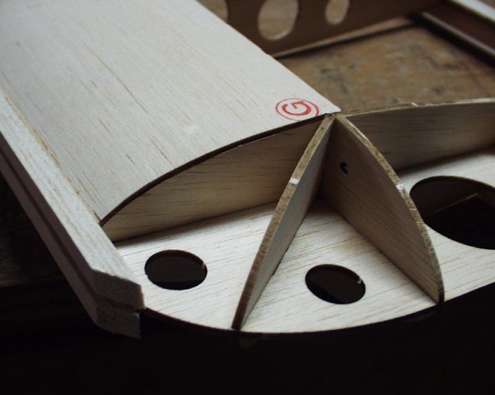

ok guys, the final (probably) post until monday morning...
i just finished taking the tape off the first bottom sheeting and i also CAed the leading edge of the second piece for the bottom. here are 5 pics depicting certain aspects of the wing in this order:
the center section of the bottom side after 1st half of sheeting.
the second part of my method for putting on the sheeting.
what the first half of the bottom sheeting looked like when i took the tape off.
the first part of my method for sheeting application.
the front of the wing tip (leading edge blocks not sanded or shaped yet)

oops i messed up...
that last one that just said "..." was what it looked like when i took the tape off
diregard that list in the base post. i will describe them as in their respective posts.
here is the first part of my sheeting method.

finally got them all posted. sorry for the confusion but i'm sure that you can, in your infinite wisdom, figure it out.
anyway, how do ya like em? this is most likely the last post from me till monday so c ya!! hello KEY WEST!!
Crazy Mike
