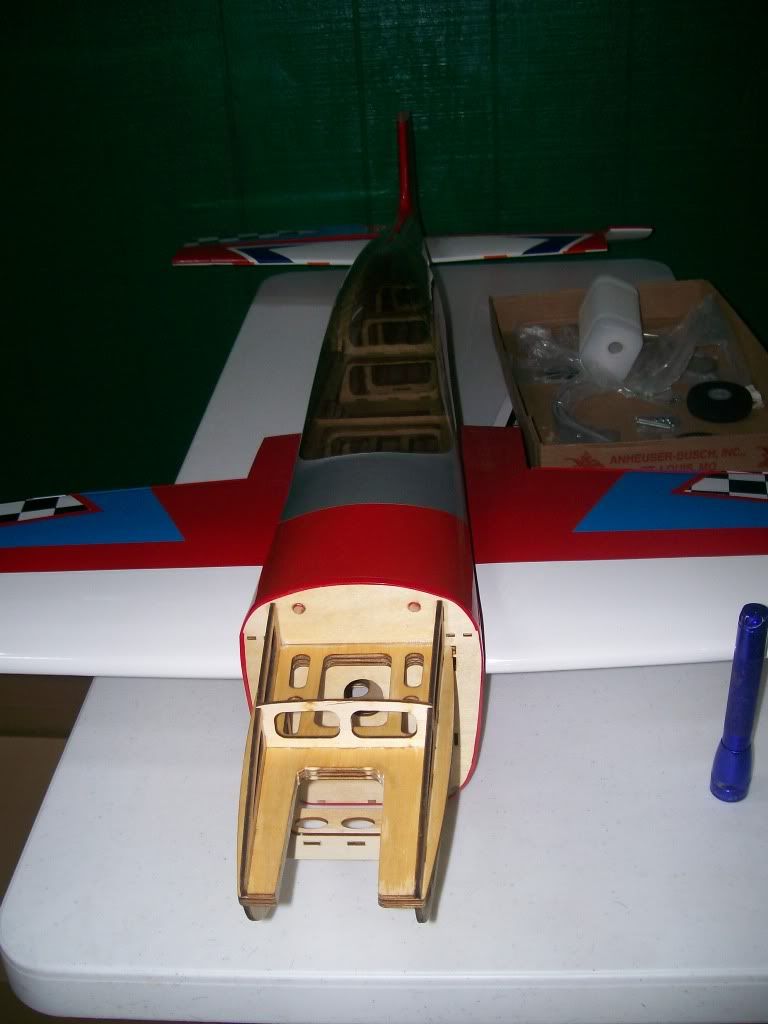

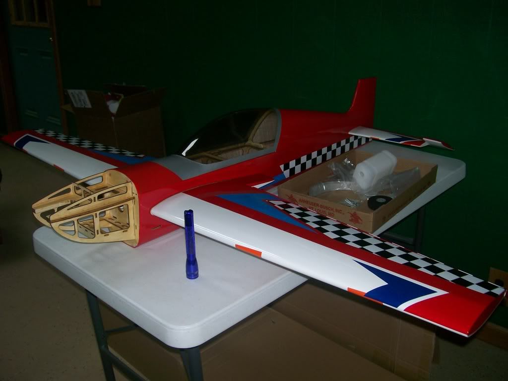

here are few pictures of my build. if anyone has any assembly info. please let me know.

couple tips:
throw away the included tank (mine leaked all over making a mess)
throw away the included hinges.
Other than that, no asembly issues with mine.
The gear is very strong, I had a hard landing last weekend that bent the metal legs up and back, but did not rip out the block! I just put them on the vise and straighted them out and kept flying.
Its a very fun plane!
What engine and servos are you going to use?

look inside the plane toward the tail section, you will see two small tubes out each side of the tail section... you can use a small needle to clear the monocoat from the holes on the outside...

Thanks for the reply warnberg, I've looked the tail section over and have not seen anything that resembles tubes of any sort. Maybe they forgot them on mine! lol! How many inches from the tail edge where it meets the rudder is the holes actually located? From the top of the tail also please.

its even with the leading edge of the horizontal stab. exactly 2 inches up from it.
you cant miss it....but then again you did.

Thanks for picture and info mshay. Ill check mine at that location.
