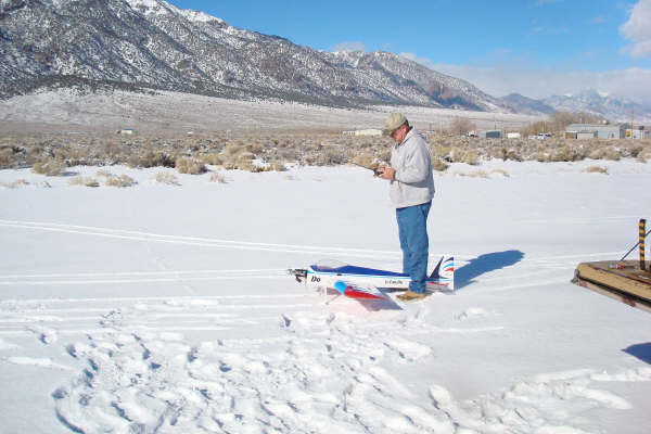

Hey Rob, Barry, and guys, i just tried out my snow skis on my 60 size and man what a blast, here in my new enviroment in Nevada we finally got enough snow to go out and it was great, they didnt hinder the flight caricteristics hardly at all (just made my flatspin a little wobblie. great day though

Gary...That's awesome?????!!!!! You inspire me. Maybe I'll have to try that. I have a couple of friends that fly off snow, but I'm afraid of the cold.
