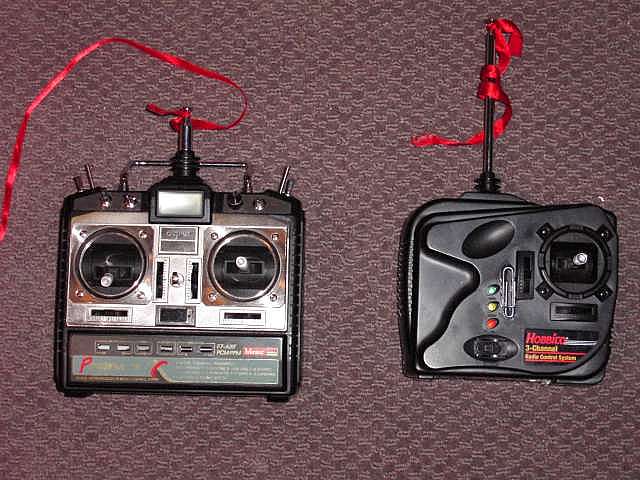

First we have examples of two radios. One is a dual stick, typical of radios with four or more channels. The other is a single stick typical of two to three channel radios.

The Transmitter
Finally we get to the star of the show, the transmitter. This is the part of the radio system you hold in your hands. It has those lovely sticks and switches and things that allow you do what you need to do to fly a plane that is hundreds or thousands of feet away while you are standing there on the ground.
Transmitters come in a wide variety of prices and capabilities. Of all the investments you will make in getting started in RC flying, your radio transmitter is one of the most important. Which radio you select will determine how easily you can set-up your plane, how easily you can adjust and trim it and how complex a plane you can fly.
I divide transmitters, typically called radios, into two groups, standard and computer radios. Standard radios retain the settings for the currently flown plane. If you want to use that radio to fly a different plane you must manually make adjustments to match the new plane. With computer radios, you can store the settings for many planes in what we call model memories. You select the plane you want to fly from a menu and the radio resets everything to match that model. There are many other features that computer radios bring to the hobby, but for the moment this one feature adequately separates computer from standard radios.
Like all areas of electronics, new models come out often, with each having more features and usually delivering those features at lower prices than the previous generation. Features that were only available in high end systems just a few years ago, like elevon and V tail mixing, are now standard features on some of the lowest cost radio systems on the market.
