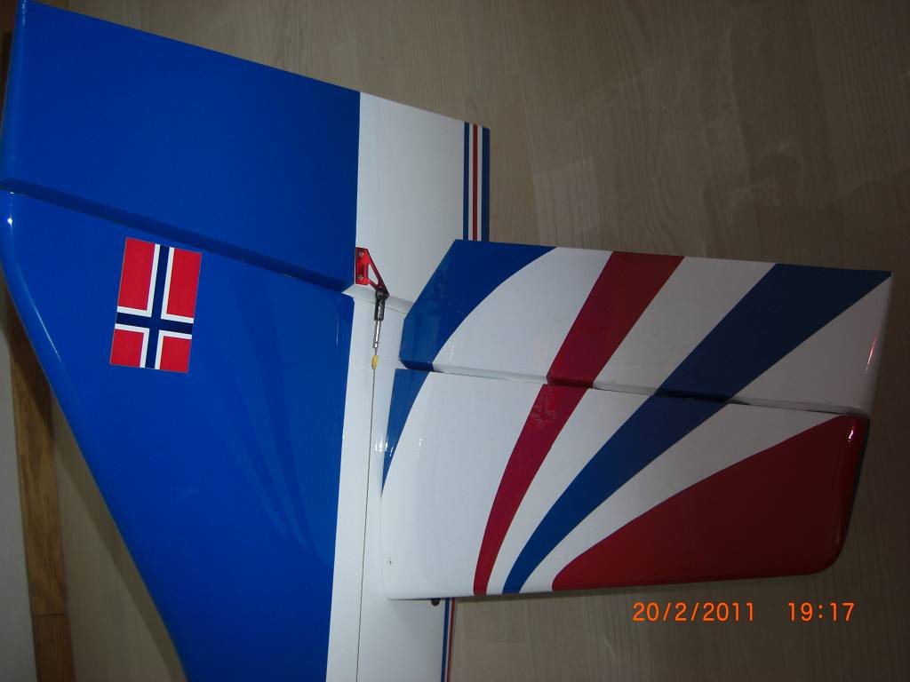

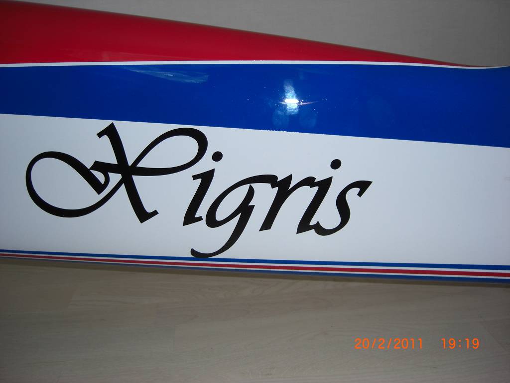

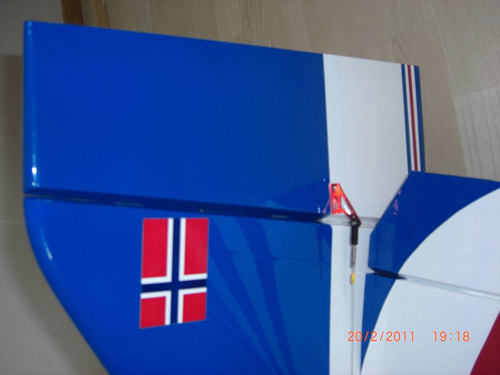

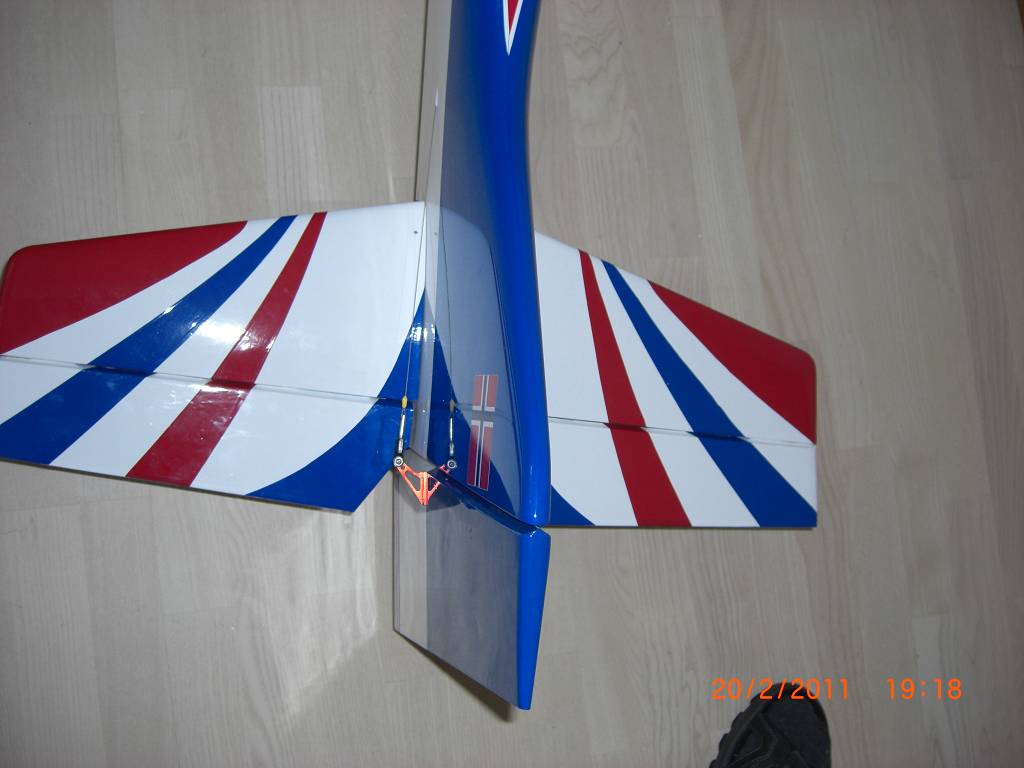

Hi,
Some photos of the re-build.
Regards
Trouble with up-loading!
