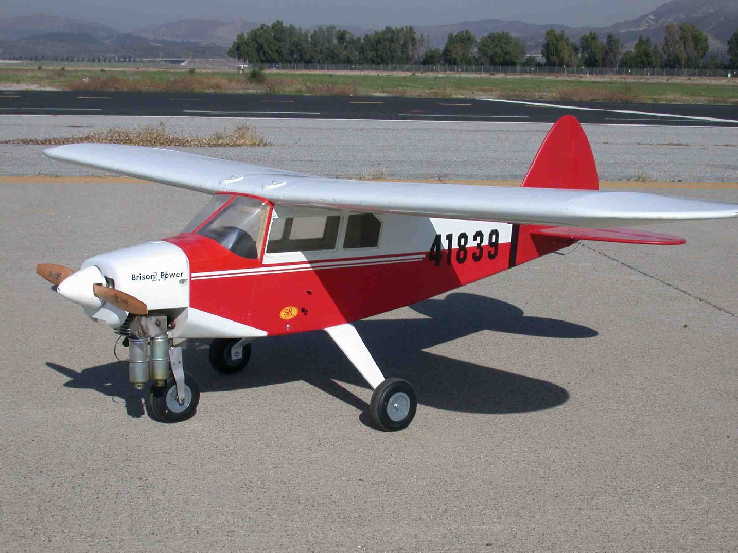

I have a question. Many years ago I made a model Piper TriPacer from a Sterling kit, about 56" span. Maybe I over powered it ,but the first time I got it to fly,it went into a steep climb ,got up to maybe 100 feet ,stalled ,came down and crashed. I don't think that I held it in the climb mode,maybe I just didn't know how to handle a model[I had flown full scale],so maybe it was just my mistake,. But I have been thinking of getting the model in shape again[I rebuilt it] And see if it will fly now that I have more experience in flying models. My question is would engine down thrust have anything to do with why it went into a steep climb,I other words should it have more down thrust than it had?

I built this 40cc Tripacer with everything set at 0-0-0. The CG is set at 30% of the chord. No trim was necessary. Dan.

I took a look at plans for the pacer and the wings have a flat bottom with a positive incidence, both conducive to a high climb rate.
This configuration is made to climb with a increase in air speed (normal) I believe it was designed as a free flighter also, but over powered and not closely monitored you will get what you got.
down thrust will help but maintaining a proper angle of attack is the way to go.
ALL day dan
your wing appears to be of the symetrical type and shouldn't exhibit the high climb tendencies of the sterling kit.
Old 04-29-2017, 03:28 PM
All Day Dan
All Day Dan's Avatar
Join Date: Dec 2002
Location: MANHATTAN BEACH, CA
Posts: 4,606
Donny, you have a sharp eye. Yes it is symmetrical. It's the NACA 0013.5 set at my usual 0 degrees. It flew straight and level with a little a click or two of the trims. I gave it to a guy when I ran out of room for the new planes. He gave it to another guy and he gave it to another guy. They all loved it as much as I did watching them fly it. I had one of the large Sterling kits on single channel. Never did get any decent flights on it. Dan.
