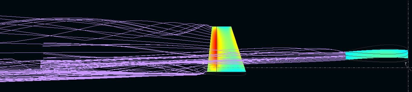

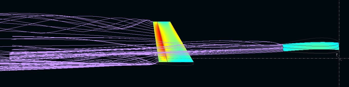

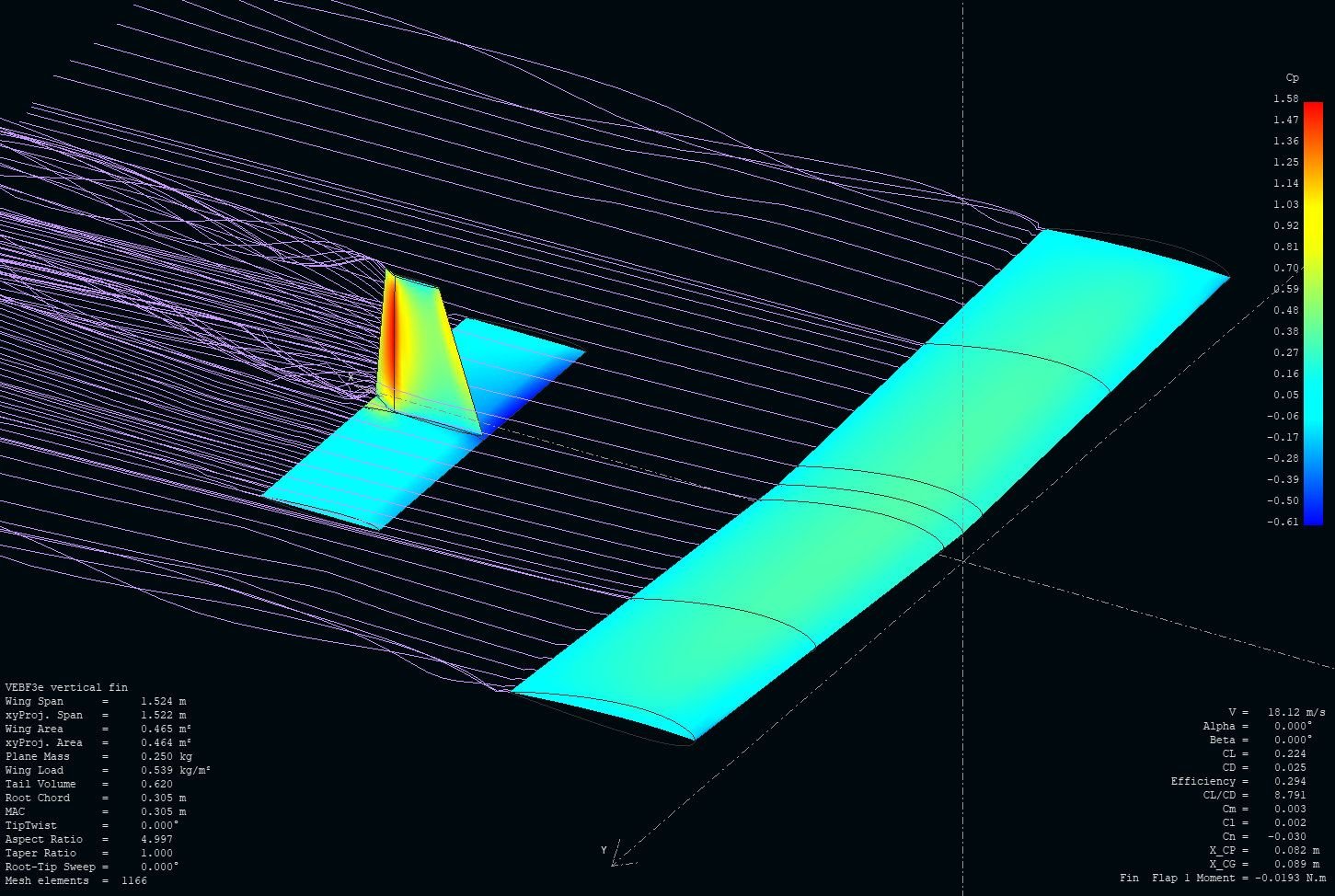

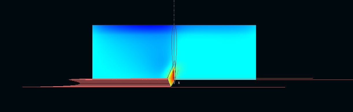

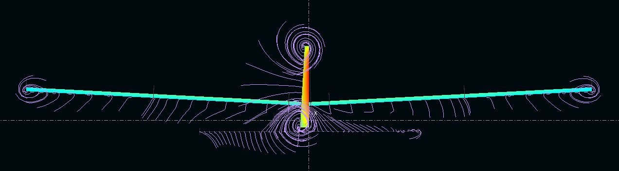

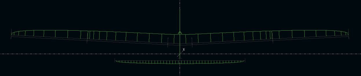

BMatthews, your CAD drawing is intuitive but it didn't let me rest because my intuition was that things are far more complcated. I put my old trainer model in CFD (XFLR5) to see what happens. The model is very simple, its rendering is crude, and I wouldn't trust the computed results too much. The only result I trust, though, is that things are too complicated to draw any firm conclusions. Look at this example:
The 5:1 aspect ratio, 60" span wing has NACA 2415 airfoil. The model weighs 75 oz and flies 40 mph at 3 degrees AoA. On top of a square horizontal stab sits a tapered vertical stab which is swept 25 degrees at its 25% chord line. Rudder is 30% of chord line and deflected 30 degrees to the left. Both stabs have NACA 0009 airfoil.

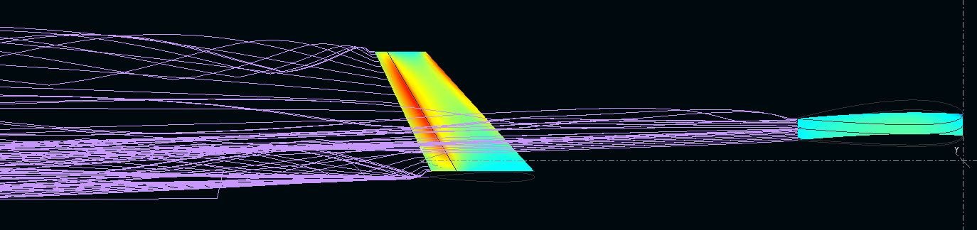

The total view shows pressure coefficient values as colours (warm is positive, cold is negative) and streamlines from the surfaces' trailing edges. Strong vortices on the tail.

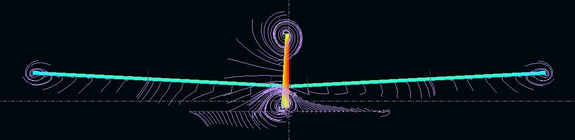

The vortices seen from the rear bottom left side, no general direction noticeable except sideways.

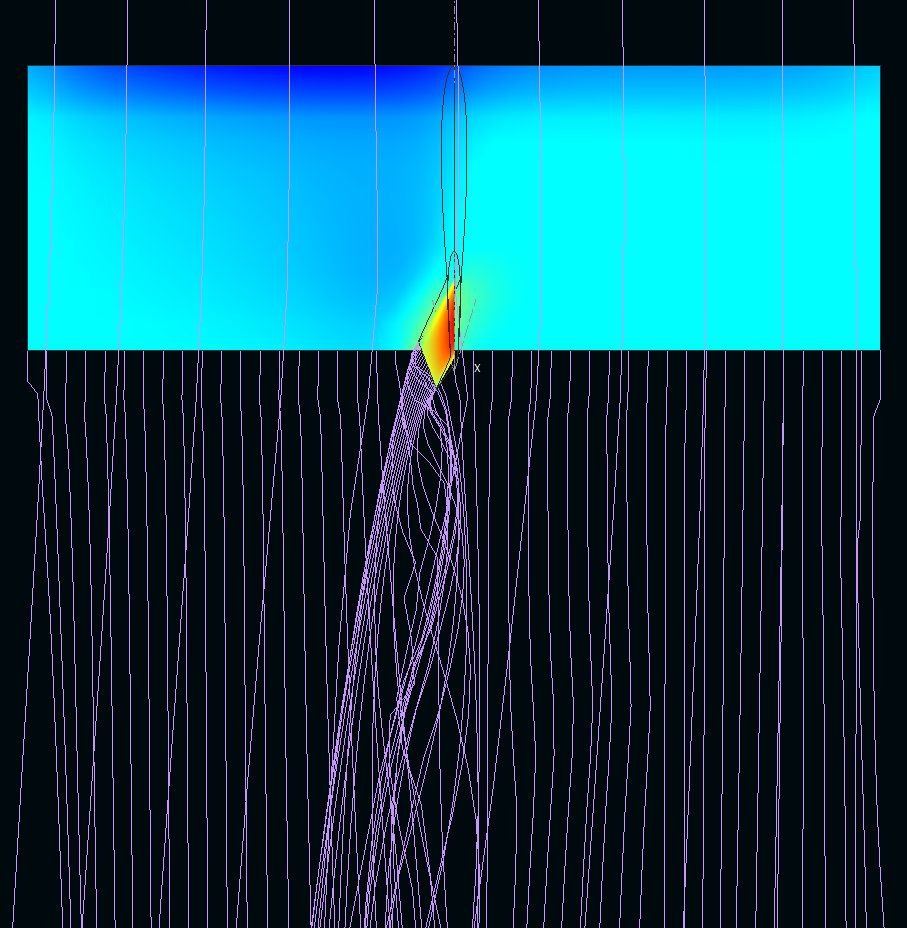

Top view shows streamlines of vertical and horizontal stabs, and even wing, are intertwined.
Side view shows streamlines from wing and horizontal stab as bunches. Strong vortices on top and bottom ends of rudder. Streamlines from rudder trailing edge go both upwards and downwards following the vortices, no identifiable net flow.
Same in rear view, but interesting is asymmetric flow on the horizontal stab. Its left half blows down, its right half up. Even the wing's wash is influenced by the strong tail vortices.

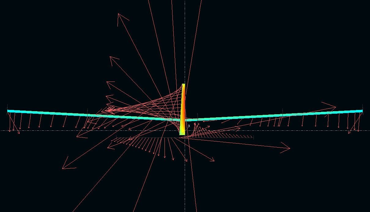

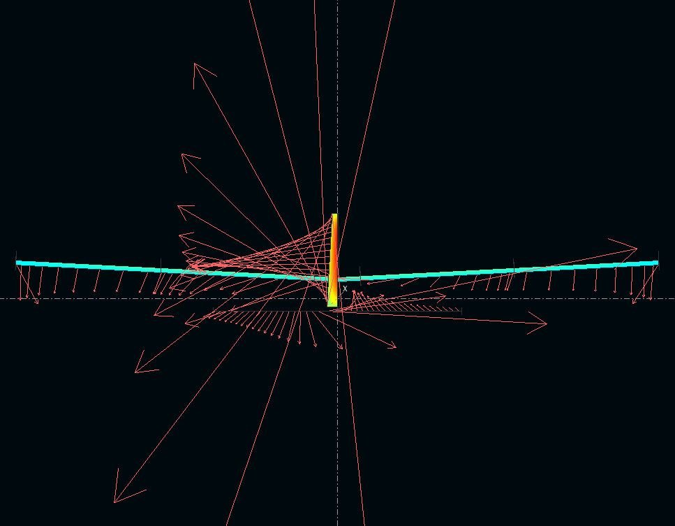

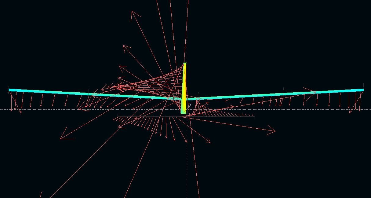

Now what is called "downwash" in XFLR5. The side view shows only vertical vectors, top view only horizontal. That means only the stream components across flight direction are shown. All vectors start at a stab's trailing edge, both vertical and horizontal. Those of the former are much bigger due to deflected rudder.
Rear view shows very long vectors coming from the tips, where the vortex centers are. Can be disregarded here. The vector field from the rudder's trailing edge is what I would call counterintuitive. I couldn't tell any net down force, for me it rather looks like a pretty much horizontal force. (The moment is specified in the first picture in the bottom right corner.)
For what it's worth.

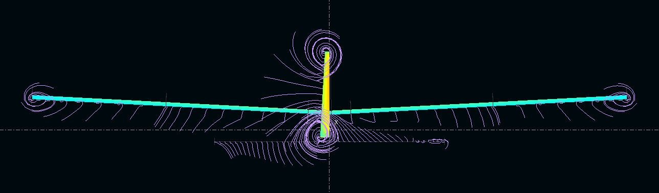

Here you go: Vertical rudder hinge line looks only slightly different. One could be tempted to believe that the downwash vectors on the rudder trailing edge make for an overall down component, meaning the airplane's nose would go down as well. And - more downwash from the left elevator half than upwash on the right. Does that mean a down-pitching moment and adverse yaw? Anyway, rudder trailing edge seems to be more important than hinge line.

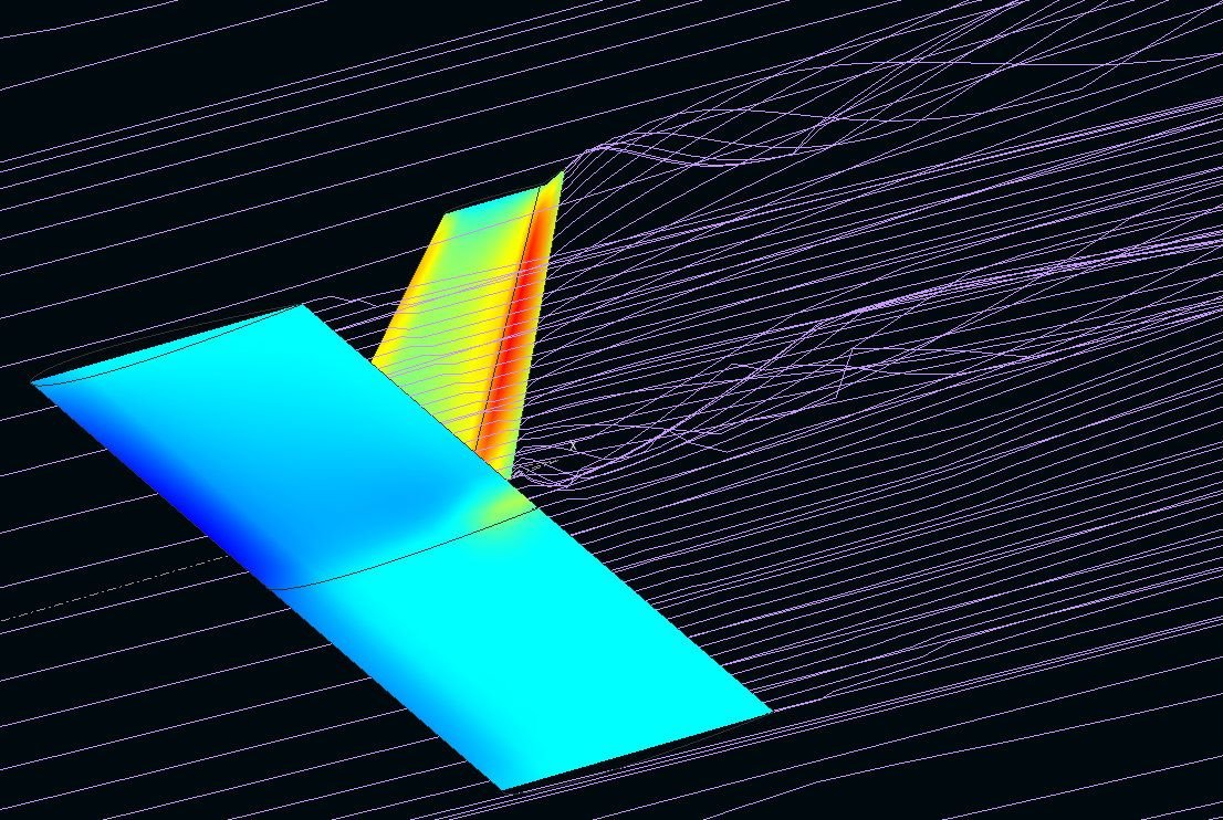

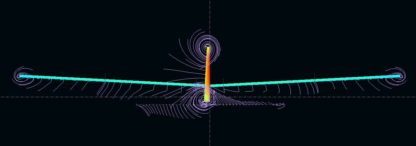

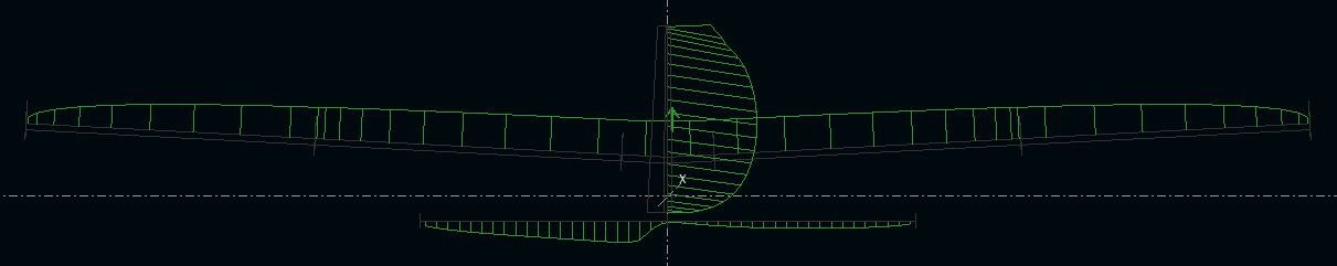

Next experiment, with rudder hinge line swept by 30 degrees (was 15 degrees in the first experiment and zero in the second).
Net downwash seems to go more upwards again, so there seems to be a small nose-up effect of swept rudders.
The rudder moment (see lower right corner of total view pictures) is smaller on swept rudders.
Again adverse roll not only from vertical tail but from horizontal as well. (Was that the original question?)

Last experiment: Rudder hinge line now at even 45 degrees.
Net sidewash from rudder trailing edge again a bit more upwards (compare how the arrow heads are above the wing).
The effects on the horizontal tail seem to be bigger at more sweep, more downwash left and less right.
Rudder moment again smaller with more sweep. Maybe that's why aerobats have vertical rudder, it's substantially more effective (-0.0118 swept 45, -0.0193 unswept). I didn't find an explanation of this parameter yet so I'm not sure if it's really effect or simply the "shorter" rudder moment arm.

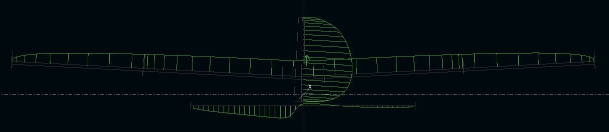

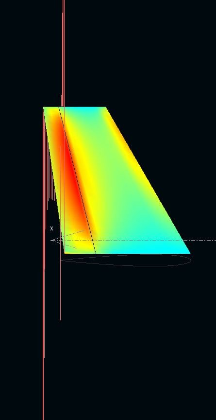

Comparison: Lift distribution on wing, horizontal and vertical tail for 0/15/30/45 degrees rudder hinge line sweep.
There is a downforce on swept rudders.
Swept rudders are less effective than vertical rudder.
Lift distribution on horizontal tail is most distorted by vertical rudder.
Last picture shows stab's unspoiled lift distribution (rudder not deflected).
The differences are best seen when the pictures are downloaded and scrolled in the picture display program.

I'm not quite sure if all these calculations are correct, especially regarding the interactions. But yes, what we see should be a rolling moment of the horizontal stab. It's especially clear in the first two cases where the right stab half has virtually no "lift" but the left half has substantial "lift".
Wing lift is drawn upwards, stab lift downwards. I think that means it's pushing down because it's hit by the wing downwash, which is distorted by rudder deflected to the left. So the left stab half pushing down (the right half not) would make for a small rolling moment to the left (we are looking from behind).
The rudder's "lift" is drawn rightwards, and that is correct since rudder is deflected to the left. The vertical stab pushes the airplane's tail to the right, its nose to the left, so the left roll moment by the stab makes for a bit proverse roll, in roll direction. This view exactly from behind is hard to interpret.
