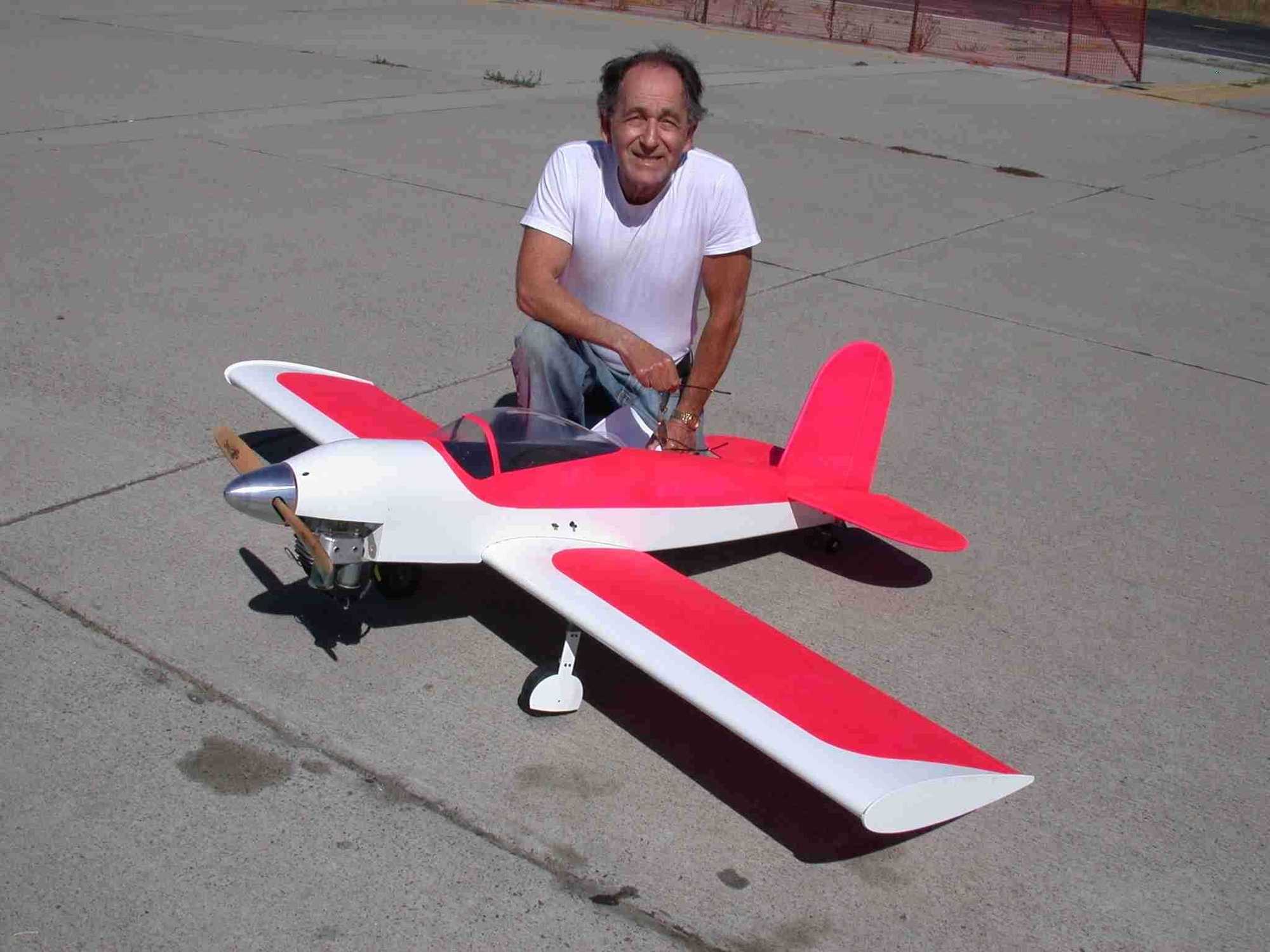

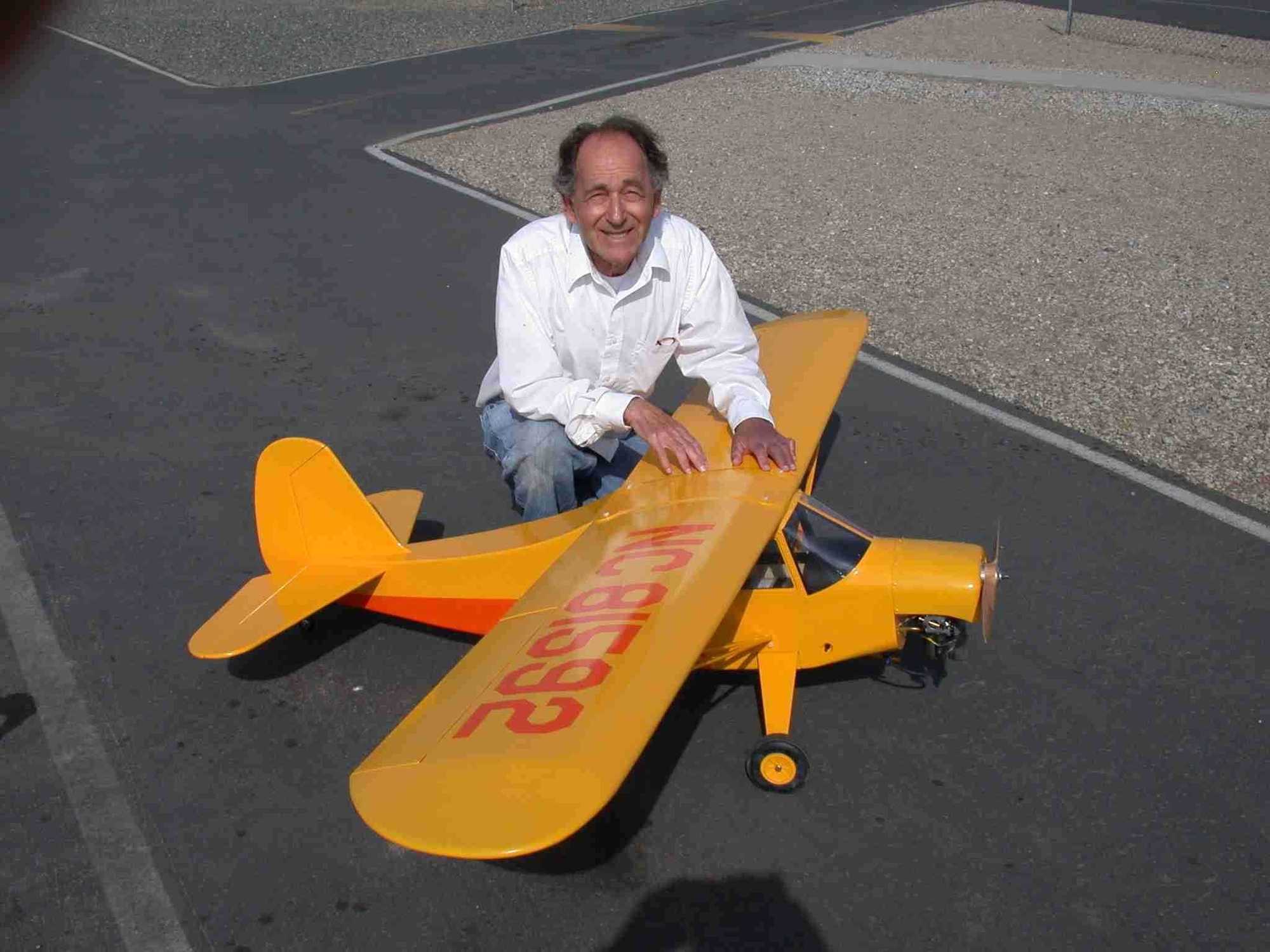

Here's a couple o my models that I used that 30% number. Dan

Nice Planes dan keep flying
