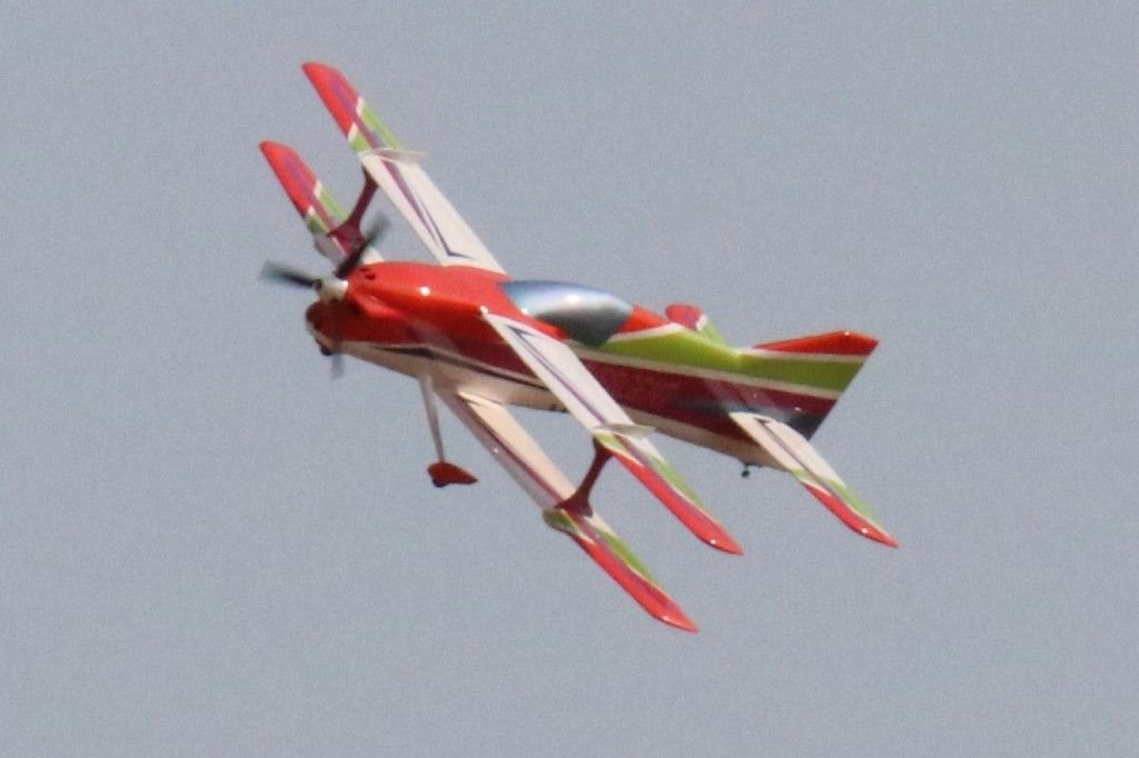

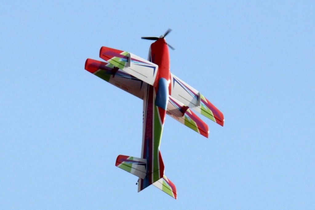

Old 09-10-2018, 05:27 PM
speedracerntrixie
My Feedback: (29)
speedracerntrixie's Avatar
Join Date: Jun 2010
Location: Sacramento, CA
Posts: 6,493
Gallery
My Gallery
Models
My Models
Ratings
My Feedback
Not sure if this will answer your question either but what the hell. On my Divergent design the wing platform is a bit unique. The inboard panels both sweep but the outboard panels have a straight TE. To be honest I did not take any of that into consideration when setting the incidence of both wings. The upper wing was set to zero using the motor thrust line and stab incidence as reference points. Initially the bottom wing was set to .75 degree positive. After initial test flights it was determined that the lower wing needed a bit more incidence and it was increased to 1 degree positive. The theory behind this is that in level flight the bottom wing does most of the work until the AOA is changed and then the benifit of more wing area kicks in. The combination is working well as the airplane has what I call " true control " which simply means it has virtually zero control cross coupling.

Old 09-11-2018, 08:09 AM
speedracerntrixie
My Feedback: (29)
Join Date: Jun 2010
Posts: 6,493
Gallery
My Gallery
Models
My Models
Ratings
My Feedback
Personally I would think the sweep angle on a bipe has very little affect on the incidence requirements. If you were to refer to the pattern forum there is a thread on this subject that will demonstrate there is no one size fits all on the subject. You could also pose your question on the modeling science forum on RCG and end up with pages of theory. I doubt that given the tone of your responses that anyone here would be interested in offering you any further advise.

Old 09-11-2018, 10:33 AM
speedracerntrixie
My Feedback: (29)
Join Date: Jun 2010
Posts: 6,493
Gallery
My Gallery
Models
My Models
Ratings
My Feedback
Sweep should have more affect as observed dihedral effect. Although both wings on my pattern design pictured above are perfectly flat the airplane exhibits a slight dihedral effect while in flight. As a result the next one built will have 2-3 degrees of anhedral to eliminate this unwanted trait.
My pictures posted IMO is simply an effort to illustrate that there was considerable consideration on a great many details while in the design phase and not some simple hap hazard design. I stand by the idea that pictures can add to the credibility of the information presented.

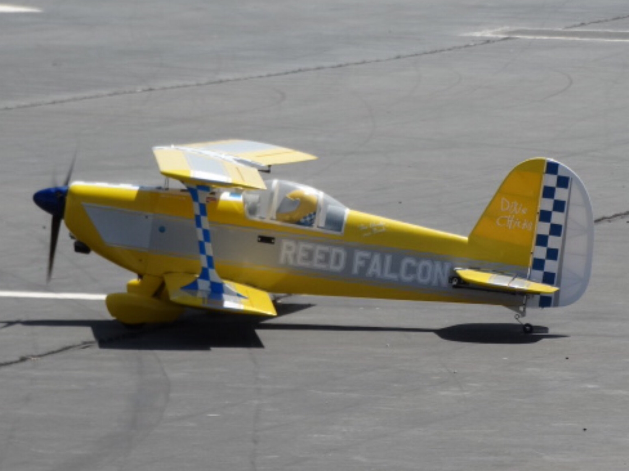

Old 09-11-2018, 12:32 PM
speedracerntrixie
My Feedback: (29)
Join Date: Jun 2010
Posts: 6,493
Gallery
My Gallery
Models
My Models
Ratings
My Feedback
Thinking about this a bit more, this picture of my 54" Reed Falcon illustrates the wing sweep well. Both wings and stab set to zero as per plans however the engine is set to 2 degrees upthrust also as per plans. Both the Carl Goldberg and Dave Patrick Ultimates ( both designed by Dave Patrick ) have the engine and both wings set to zero but have the stab set to positive 2 degrees. No set way to skin this cat.

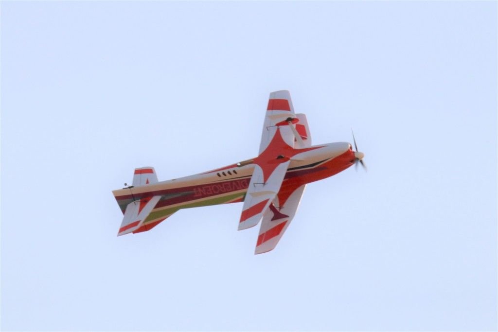

Old 09-14-2018, 02:48 PM
speedracerntrixie
My Feedback: (29)
Join Date: Jun 2010
Posts: 6,493
Gallery
My Gallery
Models
My Models
Ratings
My Feedback
Allan, I see where you are coming from and to a certain degree will agree with you provided we were discussing full scale design theory. Let's take Dan's airplane for example. It appears that he has the engine, both wings and the stab set to zero. He does not indicate what airfoil was used but for conversation let's assume symmetrical. We know that a symmetrical airfoil is not going to support the airplanes weight at zero degrees. This means that the airplane will need to carry some up trim to provide the required force to hold the wings at enough of a positive AOA to support the airplanes weight. Two things result, the airplane as a whole will be flown at a positive attitude and the airplane will never hold a pitch trim over different air speeds. For a sport model most guys would be perfectly fine with all that.
Now let's take my Divergent as an example simply because it's flight performance is under a much greater scrutiny. As I have previously stated I have everything set to zero except the bottom wing which is currently set to positive 1 degree. The philosophy behind that is I am aiming for the bottom wing to be supporting the bulk of the airplane weight while in level flight while upright. While inverted by keeping the upper wing at zero my theory is that less fuselage AOA will be required to maintain level flight as now the top wing is doing most of the work. No way to avoid some fuselage AOA while inverted however the theory is that in that orientation it's not as noticeable to the judges. Since there is no up trim required for upright level flight and the fuselage is being flown level also no engine up thrust is present in that situation as well along with a properly adjusted CG the model will hold a constant pitch trim from 1/3 power to full power.
