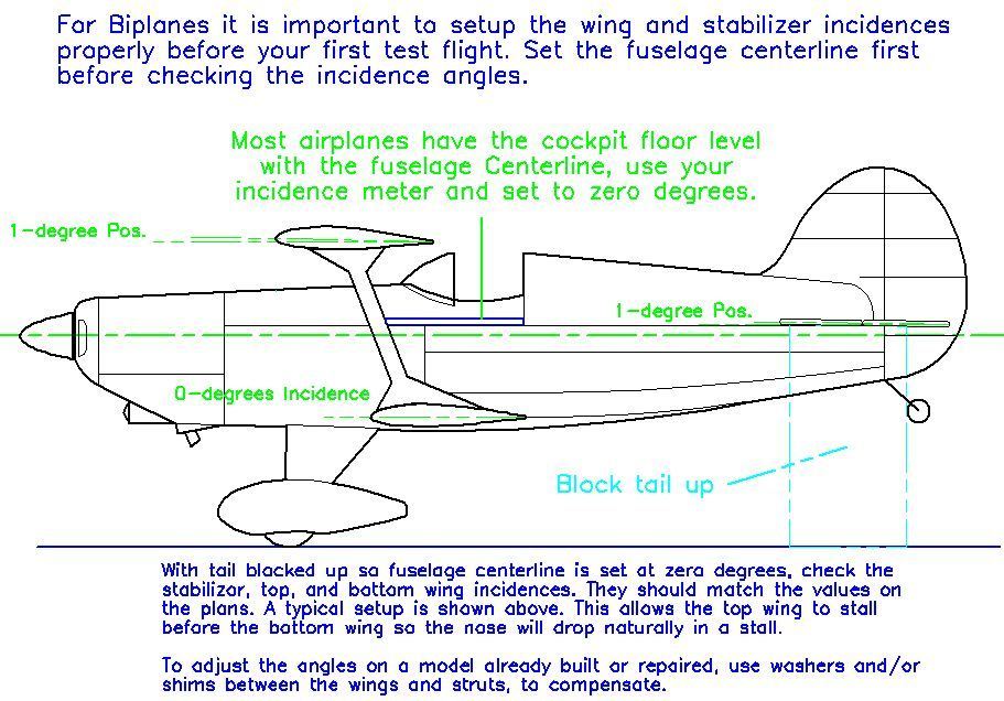

Yes, I agree, trimming a bipe is not just about stability.
Back to the original question, during the 20s/30s, according to an old timer, it was common to rig bipes with some washout. Some of them had fairly high aspect ratio wings even though they were bipes.
Itís common to set the top wing a little negative to the bottom wing (pos. stagger). The idea is that down wash from the top wing causes the bottom wing to fly at effectively a lower angle of attack, so setting the top wing a little negative evens it out. One pretty experienced bipe flyer on this forum says that by testing he has found it works well on all his aerobatic bipes. I set up my own that way.
Itís also common to set the top wing a little positive to the bottom (pos. stagger). The top wing stalls first and the bottom wing, further back, is still flying. I donít do that because thatís making the lower wing do the job of the stab. I want the lower wing to carry itís weight. It would make it hard to do snaps too.
Gordon Whitehead, who has published many scale designs, explains these theories and uses no difference between top and bottom at all, and he never mentions washout. Hard to argue with his success as a scale bipe designer. Jim

if one wing is going to stall before the other,...I would think you'd want the bottom wing to stall first. it carries more weight per foot because it is usually smaller and when stalled, you still have the secure geometry of a parasol wing arrangement with the top wing still flying. I guess i look at the importance of the plane being more snap-roll friendly with the top wing not flying as insignificant in the scope of overall handling. I would much rather have good landing approach manners than snap-roll readiness.
I wonder if Mr. Whitehead has the right idea,,,, both wings should be contributing their proportion to flight equally and the bottom wing will quit all by itself when the time is right, simply because it is usually smaller and more heavily loaded.
wash out or not, probably depends on how you look at the "which wing stalls first" aspect. if the bottom wing gives up first, then I'd want some wash-out in the top wing. I can't see an instance where I would want the top wing to stall first,....to me,.... that just doesn't make any sense in the scope of stability.

Mr. Whitehead did not make the incidences the same because both wings would contribute equally. He knew they would NOT contribute equally and explained the reason. This has been known since NACA days decades ago. He just made them equal as a sort of compromise between the two ideas. The lower wing will tend to stall a bit later than the top wing if both wings are set to the same angle because it flies in the down wash from the top wing. For the same reason, it contributes less lift.

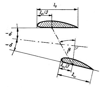

Originally Posted by r ward View Post
makes sense,....never thought about the vertical flight and trim,......I just can't see any downwash being produced in an airstream that is negative pressure under the upper wing's airfoil. that and the stagger isn't great enough to allow the lower wing to be in any part of the upper wing's wake. many books have been written on theories that are just a bunch of sentences to fill the pages between the covers.
Of course, the lower wing isn't in the upper wing's wake, it's in its downwash (two different terms and concepts). As to theories, this is all knowledge from the 1920s and 1930s, well tried and proven in practice. The two pictures from a 1950s Swiss aerodynamics textbook may suffice to explain the concepts, the pictures are in English after all.
If you are familiar with the concept of circulation, the upper part of the first picture tells why the upper wing's lift is bigger than the lower wing's. Any wing retards the airflow beneath and accelerates the airflow above. Superimpose both airflows and you get the airflow (streamlines) in the picture's lower part.
That is to say that on a biplane with two equal wings at the same angle of incidence the upper wing has always more lift than the lower one. That is the case even without stagger (second picture), but positive stagger has the same effect in addition.
If the lower one of the two equal wings has a certain amount of more incidence than the upper one ("decalage"), both wings have equal lift what minimizes overall induced drag. If there is positive stagger, there has to be even more "decalage" between both wings. Up to 3 degrees of decalage (angle delta on the left side of the second picture) are common. Total lift and total induced drag are independent of stagger. An equal distribution of lift on both wings just makes maximum total lift bigger (delays stall).
As to aerobats, if both wings have the same incidence, the upper wing has more lift so it stalls first. If there is also positive stagger, stall on the upper wing lets the center of lift shift back what makes for a down-pitching moment and helps recovering from stall. If the lower, rear wing would stall first, that would boost the stall and probably make for violent snap rolls.
Look here for a 3-view of the BŁcker 133 Jungmeister. It has two equal wings, cambered airfoil, and a bit positive stagger. The lower wing seems to have a bit more incidence. There's also a bit dihedral (more on the lower wing) and some sweep, but no washout. (A swept wing with dihedral may look like washout in the side view.) The German Wikipedia says it had a "clean stall behavior" - now who here can explain why? (I can't.)
I just presume that this configuration makes the airplane's stall not violent, not self-enforcing what it probably could be due to the thin airfoil. Washout may be not needed because there is no taper. On the other hand, there must still be a decent stall if asked for. The stall maneuvers in question are spin and snap, or better flick roll - both are autorotations which are commenced and maintained by a yawing angle in turn maintained with rudder. The wing sweep should help asymmetric stall in this slip motion.

speed, I discussed the full-scale BŁcker because it had been mentioned before and I find interesting that its special snap-ability seems to come just not from a violent stall. Sorry for the digression. Your explanation of model stall maneuvers is very good, and I didn't mean the BŁcker's behavior would translate to model size.
Of course you are right in that a biplane's decalage has to be chosen for a certain design point, a certain angle of attack that is. That is done to minimize drag and/or minimize stall speed, but for an aerobat there are different purposes. I just presume that your model has a good-natured stall because, if the lower wing stalls first, it produces much drag making for a pitching-down moment. With symmetric airfoils, that holds even upright and inverted. 1 degree decalage is not much, though, so it could be the airfoil as well that makes for a good stall.
Only in one point I disagree: Wing loading alone is not enough to compare models and full-size. You'd have to consider cubic (and for some movements even quad) wing loading because the airflow is the same if angles of attack are the same. Most models are rather heavy (seems to me) but 2-meter aerobats could be an exception since they are quite lightweight and are flown rather fast. That would indeed mean that biplane decalage has to be small compared to full-size. It's also true that models (at their low Re numbers) stall at lower angles aof attack and lift coefficients than full-size. But otherwise: same angle-of-attack, same airflow.
And yes, the original question has been not explicitely answered: Washout has nothing to do with biplane. It's just used to make a wing stall gentler (or reduce it's induced drag), independent of biplane or monoplane configuration. It could even complicate things on a biplane because it could make the lift coefficients vary over span. It may be even good for a non-tapered wing if it makes lift distribution elliptic and stall even more gentle. But that's not good for an aerobat since it works only upright and would be outright bad inverted.
,......so the question is,..... what about wash out ?......do I need it ?......top wing or bottom wing or both ??.
I've found two plans that I like.......the 62 inch "Lazy Ace" and a 52 inch Pitts Special from R/C Modeler Magazine
I would recommend you borrowing or buying a copy of the following book: "RC model aircraft design" by Andy Lennon.
According to chapter 5 of that book, for the rectangular wings of the Lazy Ace, the stall always starts by the central area and progresses toward the tips.
Also the normal low aspect ratio of the wings of biplanes, makes the wingtips very ineffective regarding lift: no much lift = no much lift stall.
That would make any wingtip wash out unnecessary, it seems.
The sweptback pattern of the top wing of the Pitts Special tends to induce a stall that starts by the wingtips and progresses toward the fuselage.
Since we want to delay any stall for the aft wing regarding the forward wing (for the reason discussed in above posts and hoping for a nose down-pitch in the event of a stall), washout of that lower wing only may be advisable.
I would follow the specifications of both drawings, setting all decalages and incidences using an angle meter, if you have one.
According to this article and its link, most full scale biplanes have no difference in the incidence angles of both wings:
https://en.wikipedia.org/wiki/Decalage
