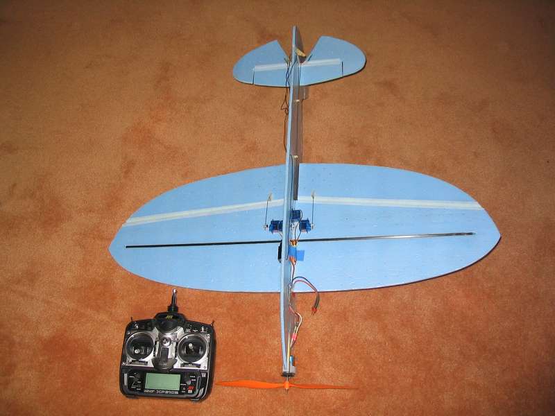

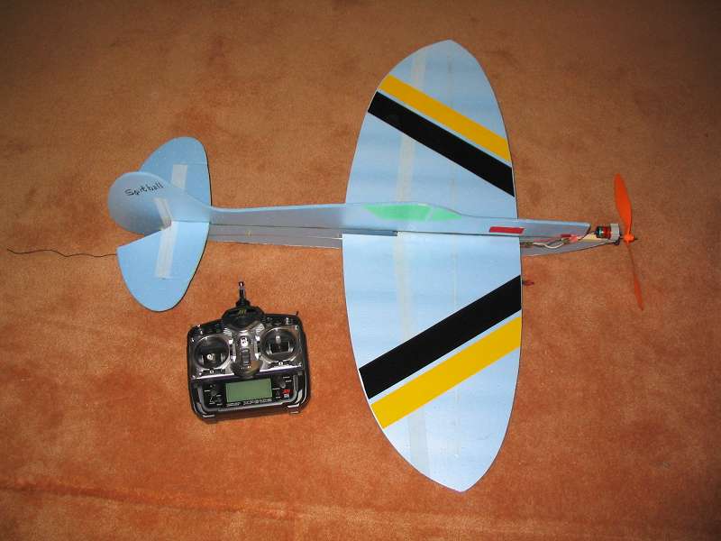

I really do not understand all the reasons why the flat plates work so well but the fact that they are tnin- means that they can be stalled at low speeds -and these can be commanded to do very precise snap rolls - yet they are very docile.
I have a friend who, along with his son - live in Merseyside are active club members and he also acted as a Team Cap. at the prior Polish World Champs
both he and his son fly my designs in competition
An EMC2 and an Ariel FAI aerobatics and a Staudacher I whipped up for scale aerobatics.

Certainly in the v. low Reynolds number regime of indoor fliers, flat plates do remarkably well. There are a lot of Gottingen studies of flat plates and curved flat plates at low Re, and they seem to be pretty good at v.low Re - e.g. sub 60 000.
Am I right in saying these sections work because the more boundary layer is a more significant component at v.low Reynolds number rather than high reynolds number. Is it because the boundary layer is laminar at these Re's?
Curved plates work well, but real airfoils work better. Often times, a turbulator will be used to energize the boundary layer to prevent separation at high Cl. This turbulator can be as simple as a length of thread glued to the upper surface of the wing, at about 15% chord. Attached is a pic of a couple airfoils suitable for the Re = 40k-80k range. Less camber is normally used at lower Re.

I said early on " If the thing is light enough -cg doesn't
matter -and if it is too heavy -it still doesn't matter".
Watch a close up of an F16 tailplane as the craft takes off - it is wiggling to keep the craft from going ass over teakettle .
OR fly a tiny flate plate wing aerobat with wing loading measured in a few ounces and 2-3 x thrust from the motor.
With a proper computer (or some quick thinking) and these parameters , you can rethink the old rules on flying.
The flate plate wing has a characteristic of going from low drag (at a low AOA) to instant high drag at a fairly low AOA. (predictable also)
on a very low wing loading - this provides a wing that will fly fast -then instantly snap on command.--OR if slowed and power is increased - it allows you to steer the model around like a surfboard.
Low wingloading and high power loading means everything on these designs.
The cg - -oh somewhere convenient -further aft the more fun.

OK here is a setup - remember you drop the wing loading to zip -then add 2-1 power capabilities -the result is a model which will fly at about any attitude.
the SPEED is so low and the angles of flight are so high that flight is basically thrust with guidance by the ailerons etc..
These are really crossbreed copters and fixed wings.
at low speeds they are still very controllable, in level flight --but they ain't freeflights -by any stretch of th inagination.
It is a bit like some full scale fighters - where the computer keeps em from "departing".
There are thousand of these types out there now and the market is really growing.
The CG can have a very broad usable range.
The more one goes to high angles (vectored thrust) -the furher aft it can be located.
They are goosey but they do fly .
The model here has under 5 oz loading per sq ft and power is at 30 ozs thrust -for a 13 oz model.
Not calculated - tested
Note the control setup under the wings-with the radio used, I can instantly choose sensitivity or mix of aileons and elevators etc., to give slight trim changes ailerons (droop or raise) to flaperons or add flapperons on a fully integrated basis.
Sound complex but it really isn't.
These integrations are pre programmed and one switch selects combos.
a momentary push switch , adds trim in small increments .
you can do all this easily.on the "fly"
Does that mean that CG location is totally irrelevant for a stable flight?
But thanks for the pictures anyway.
