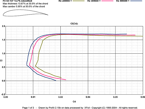

I need some data for the Franz-Xaver Worthmann profile FX 63-137. I don't mean the coordinates but aerodynamic data. I could find a lot of information on lift and drag for different Reynolds numbers but nothing on the moments cM. Does someone have this information. I need it for the layout of the horizontal stabilizer.

We are planning to build an UAV aircraft with relatively high wing loading and low approach speed, that means high c_Lmax. That's the reason why we think about the FX63-137. Minimal Reynolds number is about 200.000.
As far as I know the airfoil was developed for low Re-numbers, is that right?
I have data for lift and drag for different Re-numbers but no information on moment coeficient (must be quite high). Would be nice to have Cm0 and Cmalpha (moment gradient) to estimate the stability of the wing/tailplane configuration and to calculate the right c.g. location.
My idea was to use XFOIL to determine the moment coeficients for diferent angles of attack, but I have only very few experience on XFOIL. Perhaps there is someone out there, that could help?

Here you go. These were calculated with XFoil, using Profili as the interface.

Hey Frank, if it is for SAE, what school are you competing for? I'm from Mississippi State and we'll be competing for the first time this year. Oh, and as for the XFOIL data - don't take it for absolute - we've got the Selig books with that data in it, and they say that XFOIL overshoots some of CL values at such a low Re. Something to keep in mind.

from
http://www.nasg.com/afdb/plshow.phtml?n=6&file1=fx63137b-100800-uiuc.dat&comm1=FX63137(Re=100800,UIUC)&file2=fx63137b-155600-uiuc.dat&comm2=FX63137(Re=155600,B,UIUC)&file3=fx63137a-200100-uiuc.dat&comm3=FX63137(Re=200100,UIUC)&file4=fx63137b-200700-uiuc.dat&comm4=FX63137(Re=200700,B,UIUC)&file5=fx63137a-299500-uiuc.dat&comm5=FX63137(Re=299500,UIUC)&file6=fx63137b-308600-uiuc.dat&comm6=FX63137(Re=308600,B,UIUC)
and as far as I know, Dr Selig and co's data is freely available - you can get it all in pdf format online.

I am trying to run simulations in Edge on this profile for my master thesis, but realized on the way there that the coordinates available on the web give a 'wavy' geometry. Do you maybe know if there are different set of data available for the same profile, or how to get the function itself?

Just try this, it's called "FX 63-137 13,7% smoothed" but I have no idea if it's really smooth. Rename .txt to .dat, it's the common dat format.
Addendum: Maybe it only looks wavy because there is no antialiasing in the programs you use to display the outline. The pixel steps might fool us. Here's how it looks converted to DXF and displayed with the SolidWorks viewer. And here's the coordinate table and pencil drawing from the wind tunnel department of Stuttgart University where FX Wortmann worked.

Thanks! I think this one is better than the one that's easy to find onthe web. We actually run a simulation on that one already, and youcould see the wavyness on the pressure. Hope this one will work though!
