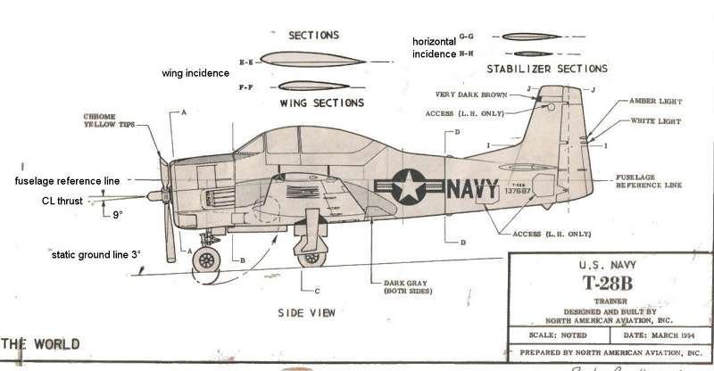

I've read a number of threads and still do not completely understand wing incidence. Firstly, how is it defined and secondly, how is it measured? If wing incidence is measured in relation to the fuselage, then where is the reference line on the fuse? In my way of thinking, it can't be arbitrary because you could end up with no difference between the wing and stab (zero decalage?), but could (exaggerating to make a point), be 90 degrees to the fuse (obviously absurd) and still have zero decalage (mono-wing, wrong term perhaps?).
Maybe I'm getting mixed up with angle of attack. Please help me understand this as I'm going nuts (already gone?). Thanks.

Incidence -is- arbitrary. A designer selects some point on the plane, or off.. In full scale, a "waterline" designated WL00 is where everything else is mearsured from.
Usually this is well below the fuselage with the landing gear extended.
The incidence (of the wing) is important relative to the incidence of the horizontal. For ease of use, it's common practice to set the horizontal at 0 degrees incidence. The arbitrary fuselage reference line (FRL) then is placed parallel to the fore and aft extended chord of the horizontal.
For optimum aerodynamic performance, generally at a chosen weight condition and airspeed, the wing is set relative to this FRL for most efficient use of the wing.
Models seldom have the speed range between takeoff, landing and cruise/highspeed flight that full-scales experience, so precise determination of the wing angle is usually determined first by what has worked, and second by flight testing, with the elevator trimmed off 0 (faired with horizontal) as the situation requires.
On this factory drawing of the T-28, the FRL goes thru the motor, parallel to the horizontal. The motor has signifioant downthrust, and the wing significant positive incidence.
But essentially, a line is placed for reference. It might be no more than the bottom of the sheet the plan is drawn on, the horizontal drawn parallel to this, and everything else fitted.
For example, on the Lockheed S3A, the WL00 was placed 200 inches below the lowest part of the airplane., if memory serves. Why? Who knows.
As long as all measurements are done properly from that point, it's a moot question.

I think I'm starting to get it. Still confused, though. Dumb question: What is "the horizontal"? Horizontal in reference to what? Maybe an imaginary line that runs through the geometric center of each fuselage former? I guess I'm screwed up on the definitions.
I think that what you're say is that when specifying wing incidence, the angle of incidence can be in reference to some arbitrary zero. But suppose I had an R/C model for which I had no plans. Would it be possible to measure wing incidence or stab incidence?
It seems that the designer must have had some relationship between the fuse and the wing in mind when he arbitrarily decided where zero was going to be on the drawings. Seems like the line along the length of the fuse (WW00, FRL, etc.) must be defined in relation to some feature or geometry of the plane. Right- or am I missing something? Thanks again for your help.

Yep...(Agreeing with Paul)
The datum line or "waterline" is just an arbitrary reference. I think in commercial aircraft, this would most often be the "deck angle", (angle of the floor/seats) so the designers can come up with a zero or near-zero deck angle for cruise. The wing, engine, and tail parts might all have different angles, to make the thing work.
My approach to designing models, using a typical planform with a forward wing and standard or "T" tail is:
I try and calculate the lowest drag position (typically my "zero" reference) of the fuselage, and then, using known airfoil data, try and figure the wing's angle of attack at cruise speed, so that in cruise configuration, the fuselage is in it's lowest drag position. Then I mount the wing on the fuselage at that cruise-optimized position. (usually a degree or so positive for symmetrical airfoils, and usually zero or slightly negative incidence for cambered airfoils.)
I believe that stabilizer incidence is arrived at by what the "zero trim" angle for cruise would be. (to reduce drag on the stabilizer) CG variations, different airfoils, and varying airspeeds will change the amount of download on the tail too, of course, but the general idea is the same.

Ok, that makes sense. So you're using some sort of minimum drag on the fuse to get your zero and wing relationship. Right?
So back to one of my obtuse questions: Is it possible to measure wing (or stab) incidence on a plane for which you have no plans (and you're not an aeronautical engineer)? Thanks.

Mike makes some good points about designing for a purpose but many models are set up for general fun flying and fuel efficiency isn't really a major factor for us anyway.
Here's another term for ya... Decalage (deka-laj). The word has a French origin and hence the pronunciation. It refers the the angular difference between the wing and the horizontal stabilizer and takes no notice of any arbitrary reference line. It's also sometimes innacuratley refered to as "longitudinal dihedral" as it's a key factor in pitch stability of the aircraft. For models where you don't have any reference to work from this decalage angle is a good place to work from.
On a model that's already built you can measure the decalage angle using something like a Robart Incidence guage. Ah, another bad use of the term incidence in naming this guage. It actually registers the current angle of the wing compared to level as set up for the test and NOT the incidence angle. The only way it would actually measure the arbitray incidence angle would be if the model was proped up in a jig so that the reference line is level. However if you measure the wing angle and tail angle with the guage without moving the model then the difference between the two is the decalage angle. It's most usually a negative number since the stabilizer always (or usually always) has a negative angle compared to the wing.
The more negative that number the more forward the balance point needs to be. Aerobatic models often have 0 decalage while a trainer may have -3 to -5 degrees. The more angle then generall the more the balance point needs to be forward. High decalage angles with forward balance points tend to produce models that tend to want to climb as power is added or in a dive they tend to want to nose backup. Taken to extremes the model becomes hard to fly with each speed increase causing the model to balloon up or cutting the throttle making the model want to dive. Taken the other way the model is very neutral and requires much more involvement from the pilot. Like in the 3 bears the bowl that is just the right temperature is the one that most people prefer.

Yes. Place the plane on a flat surface. Using a bubble level (easiest) or measuring up from the surface, set the horizontal to level.
Measure the wing leading and trailing edge distances from the surface. That's the wing incidence, relative to the horizontal.

Thanks everyone for your comments. Tall Paul:
The only thing I could see that was parallel to the FRL on the T-28 was the border on the drawing, so I wasn't sure where to start. Based on Mike James' suggestion that the designer may have intended the FRL to be 90 degrees to the formers, it looks like on the T-28 drawing that the FRL is perpendicular to section lines B-B and D-D. Maybe the formers are parallel to those section lines. So once the FRL is drawn perpendicular to the formers, then in the drawing, the whole plane is oriented so the FRL is parallel to the drawing border- "the horizontal".
Thanks for your responses.
