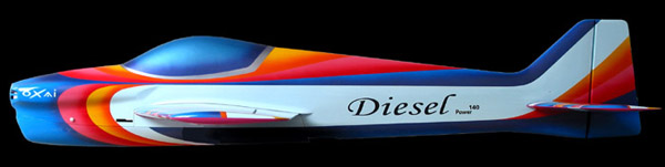

Here's a plane designed for fully neutral aerobatics with a cheap wacker conversion motor by a friend of mine. THe vertical looks too small, but is the size settled on after plenty of development flying. I've flown it myself and it's really perfect with much response and very little wagging on a hammerhead downline - no more than any sport or aerobatic plane I've flown anyway:

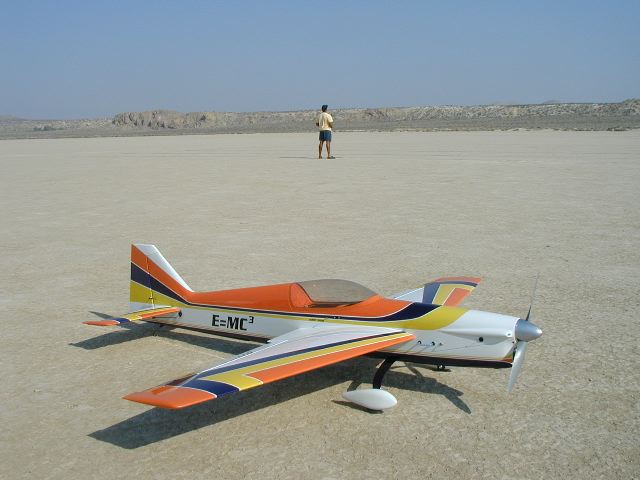

RE: Vertical tail size getting smaller??
TheEMC 2 (photo below is a version with the wing elevated ) was designed for slow flight
Most "pattern" guys were into going fast and playing follow the leader --
anyway the lateral area setup allowed for rolls which required little trim chage during rolls at slow speeds .
I learned this doing the Jungmanns for TOC in 1989 (flown in 91-)
Steve thought the rudder fin was way too small -I was adamant it was plenty as the fuselage setup (being between the wings ) afforded excellent lift(lots of uninterrupted area) and the rudder simply had to act as a trim tab - (sorta).
A larger rudder and fin INCREASES AOA on fuselage required for knife edged flight .
The lateral area distribution goes to pot.
Geo's comment on the torque also caught my eye - I thought the same thing but I suspected it had nothing to do with being out of the "torque band of the engine".
Props know nothing about torque bands
Also- I can shift the max torque band on any good gas engine -by retiming and pipe setup -
I must ask George exactly what it meant --
Chip's 1/2 degree thing is a carry over from when ever --
1/2 degree is 3/32 in one foot (aprox).
if one trims ailerons a hair - effective symmetrical airfoil -goes out enough to cancel that -
I see errors of 1/2 degree in models all the time . (not mine of course)
I setup my big planes as zero as possible - and some have high thrust lines - some ar zero.
The real fix of course is ----------- low wing loading which = low trim drag changes and lots of power which fixes all of my other screw ups .

Thanks Dick, That is the most number of really good words you have ever written and I find myself nodding in agreement. Thanks for the reply. Let me know what George says. The EMC2 certainly looks fine.
By the way, if that is your flying field, whow!
