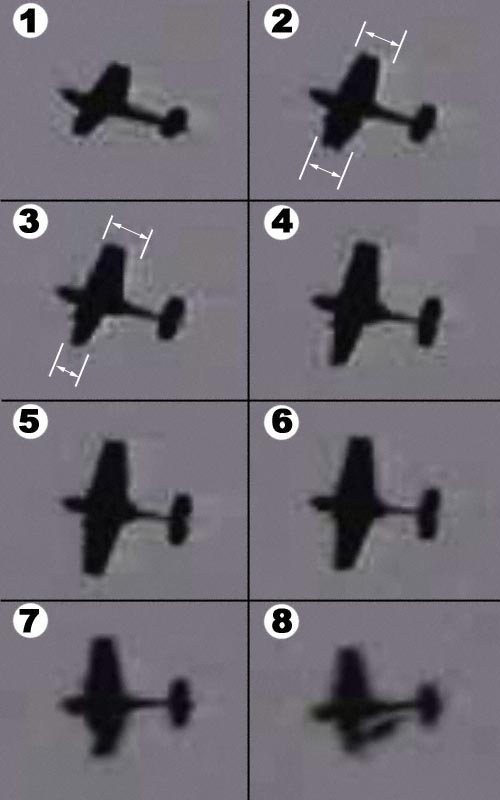

Intro... Mechanical Engineer, flying RC for less than one year. Several patents on the wall. Expertise in mechanical design and innovation. Out-of-the-box thinker...
I brought this whole discussion up in the "Funtana 90!" thread several months ago, but it was way too technical to draw interest. See the launch of the discusstion here:
http://www.rcuniverse.com/forum/m_16...86/key_/tm.htm (post 2575)
The thing I think you guys touched on that I believe is on track, is that of the wing and aileron acting as a "system". If you go back in the F90 thread, there is a photo sequence that was clipped frame-by-frame (see upload) from a video of a flutter failure on the F90. If you look very closely, you can make out the wing twisting (resonance) just before catastrophic failure.
There is so little post-mortem evidence to see, but this is pretty valuable. you can see the WING is occilating, probably initiated and excited by an aileron flutter.

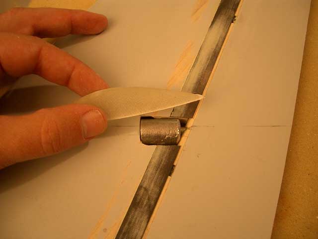

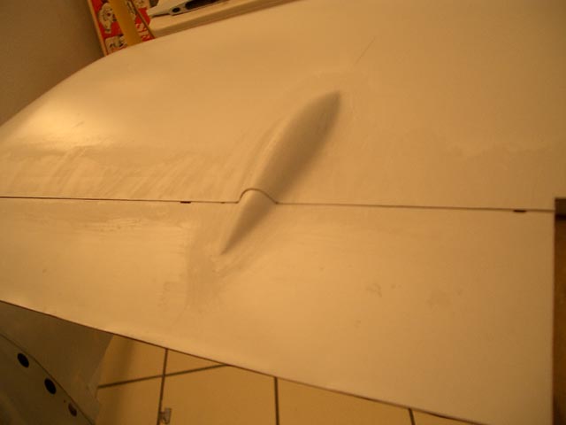

After a supreme lack of motivation I finally finished the mass balancers. They are untested as yet but I can already hear the improvement. The servos nolonger grumble under the weight of the ailerons as the mass balancers help them keep those barn doors level.

As I posted on the F90 forum, the mass balanced F90 has flown successfully without flutter. Unfortuneatly the fix included upgraded HD control horns so the experiment doesnt really prove that the balancers are the solution, maybe part of it at best. No signe of any strange quirks as a result of the balancers design, which was questioned by at least one person who thought they would induce turbulence. So far so good...

F5D aileron flutter - my initial suspicion is that the tape on the outer aileron half is dampening the oscillations, ie. it is more a mechanical solution than an aerodynamic one. How about some discussion - see what others think.
One way to test it is to provide for friction free gap sealing on the aileron outer end. If there is no flutter then the solution is aerodynamic and if the flutter persists then the solution is mechanical.
