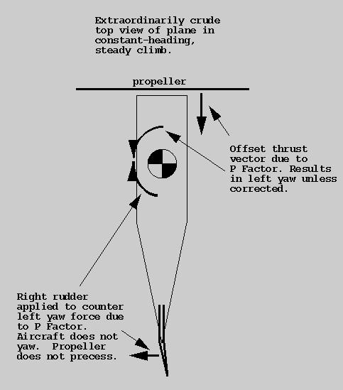

Well said msae, and I may add that right thrust is not there to contrast P-factor also, for the same reason: when flying upright, there is a momentum towards the left due to P-factor, and thrust is towards the right: so far, so good. But if we are in inverted flight, P-factor still generates a momentum towards the left, but now also the right thrust become left thrust!
This is true at least in an aerobatic plane, perhaps it could be used to contrast p-factor in non-aerobatic planes.

The right thrust is not added in small GA planes just for slip stream or P factor, but to over come the 3 most basic charteristics of an airplane wanting to turn to the left. An of course as you change the angle of climb this will effect all the forces involved
The slip stream does spiral around the aircraft and at slow speeds the slipstream is tight and close together as it slips around the aircraft it will make contact with the virtical stabalizer forcing it to the right and turning the aircraft left. As te aircraft increase speed this spiraling mass of air will elongate out behind the aircraft and have less effect on the virrtical stabalizer
So in GA right thrust is put to overcome P-factor also? I mean, some manual explicitly states that?

Right thrust is added (if it is added) to get the plane to fly straight at cruise (by far the most common flight condition), regardless of the force(s) that would otherwise make it fly crooked.
