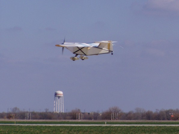

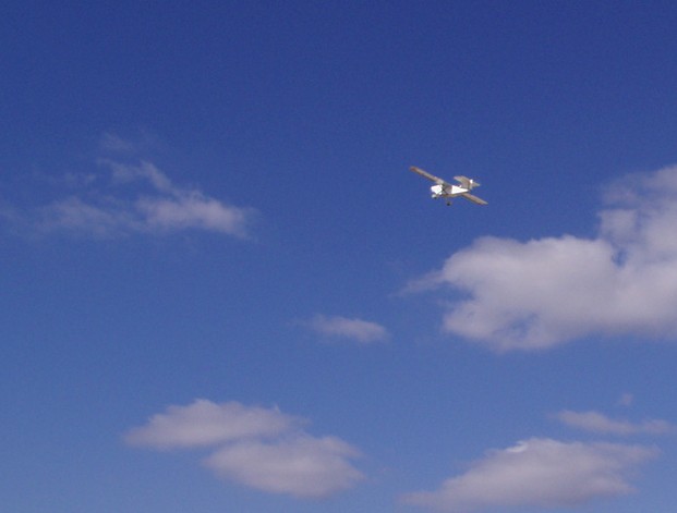

The UIUC "Chambana Belle" had her maiden flight today, and managed to leave the ground and return to it intact. Modifications are needed, however, as without the expert hands of Mike Cross on the sticks it probably wouldn't have managed the return.
The plane needs a bigger fin, and the extension is going in the bag tomorrow. After wobbling around the sky for a bit, it spun down and was recovered and landed by Mr. Cross (THANK YOU!!!!)
For those that weren't following the side discussion in the SAE Aerodesign thread, the Belle is a moldless composite aircraft. It is powered by a geared Astro 60 turning an 18X18 on 40 CP1300s. It has a wingspan of 8 feet and an overall length just shy of 4.
It is UIUC's entry into this year's AIAA Cessna/ONR Design/Build/Fly Competition: http://www.aae.uiuc.edu/aiaadbf/
Pictures will follow - must cut them down to size.

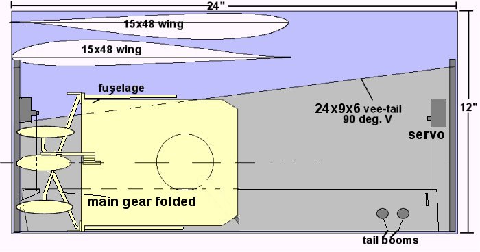

But it'd take a while to put that together - remember that's part of our score.
Originally posted by Tall Paul
Fitting mine into the box....
Lots of room!
Lots of room!

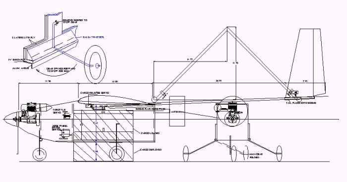

The four foot inside box length determines that, if you don't want a two-piece fuselage.
The teams are scored on assembly time as part of the grade.
Lots of parts takes longer.
It is a tad or two shorter than I'd care for.
And maybe a bit of dihedral to aid lateral stability, since it spun in. Lots of washour also.. or skip a seperate horizontal completely, make it a wing and pod.
And put a trike gear on it.
That's what neat about these competitions, there's any number of ways to meet the specs.
But the plane MUST fly also.
The easier that is, the more likelihood of a good placement in the results.

It's definitely short, but has no problem with longitudinal handling.
Let me 'splain what we were thinking:
Lateral stibility isn't what determines "spinability" - rather, it's directonal stability. Anyway, as a high-winger, it actually has a positive dihedral effect, and the directional stability has been addressed with the extended fin.
Trike gear don't have quite as positive a grip on the ground, and ground handling is implortant here. Plus, the taildragger configuration has *much* lower drag.
As to the flying wing, we considered it, but they can't acheive very high Clmaxes. That 120 foot takeoff is a killer!
Mike said that he liked the plane except for the weak yaw stability, so hopefully all will be well. We've more than doubled the tail area, and nearly tripled its AR, so it should be about 3 times more effective now. We fly again at 8:30 tomorrow. I'll let you know how it goes.

I usually end up cutting vertical area, when the propensity to an uncontrollable spiral dive... not a spin, occurs. There's too small (spin) AND too large (spiral dive) for verticals.
One of the SAE planes in 2000 never made a successful takeoff due to lack of vertical area. It swapped ends every time the wheels left the ground!

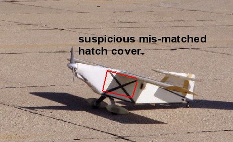

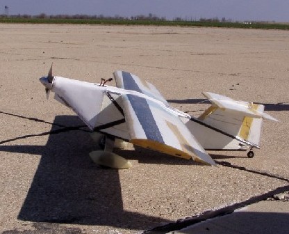

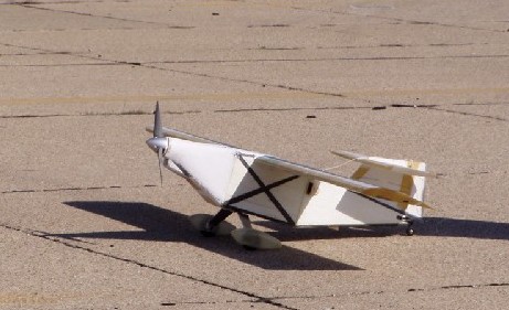

Modified plane flies!
After adding to the vertical area, the plane flies BEAUTIFULLY! Mike flew her around the pattern a few times, tested the radome configuration, wrung the plane out with full load, let me try her in the air, and pronounced it good. At that point, I took over as P.I.C. and did some practicing with the plane.
It flies so nicely now - tail follows the nose around, even in 85-degree hard turns. Unloaded, the plane just won't spin - loaded, you have to ask it very nicely to spin, and then if controls are neutralized, it recovers in about 1/4 turn.
The biggest difficulty is the fact that the High-AR wing really floats out on landing - I did break a prop trying to force it down with high alpha flight.
Paul, you're right that a bigger fin will lead to spiral instability, but the time to double on that mode, even with our tremendous vertical, is 92 seconds. That means that if I rolled it to 5 degrees and left it alone, it would be at 10 in a minute and a half - more than half the mission time. That's why, IMO, for these competitions, where the plane only stays steady-state for maybe 10 seconds at a time, the fin should be huge!
ilikeplanes, we are already using a symmetric airfoil (NACA 0009) for both the vertical and the horizontal. No self-respecting aerospace engineer would put plank tails on a plane this big. No reason for it. As to the triple-tail thing, we considered it, but the aspect ratio for each tail remains extremely low, which really kills their sideforce performance. The single tall tail works great, and doesn't really add anything to our assembly time.
Interestingly enough, the plane has "proverse" yaw performance with only about 20% differential. In fact, with elevator input, it hooks hard to the inside, meaning that I have to bank, *then* yank. Roll performance remains excellent even in a stall.
All told, it's a real joy to fly - now if I can just convince it to land where I want it to!
It even drops the payload (anybody figured out where it comes out yet?)

UIUC AIAA Design/Build/Fly Project
If you're not equipped with ailerons
the doubling time comes up -REAL- fast!
I've been flying some aileron-less airplanes which are quite picky as to vertical size.
They can achieve some unusual attitudes when you let them go, which can be timeconsuming to escape from!
You have a slight indication of this with the "proverse" situation.
