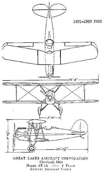

Hey guys, I've seen several threads concerning CG but never for a biplane. I'm restoring an old Scale Line Models kit of the Great Lakes 2T-1A and I'm lost as to where to try my initial CG.
The bottom wing is straight but the top wing is rather seriously swept. As opposed to the bottom wing, the top wing rear tips are maybe 10% in front of the bottom wing rear at the wingtip, but at the center point of the aircraft the top wing trailing edge is at about 30% behind the bottom wing leading edge.
Now guys, keep in mind that I've built lots of planes over the years (50+) and most have come out just fine with my limited aerodynamic knowledge, but this is a new one - I've never done a biplane before, let alone one with staggered wings. Wouldn't trust myself with that CG calculator I saw on another thread either, I need to keep it simple if possible.
I'm attaching a 3-view of the plane, just for reference. My mind kinda tells me that the CG should be in the neighborhood of the rear of the center-brace, by the front cockpit.
Any opinions on just how close this might be?

Cg will be where it's always sposed to be, on this sort of model 25~30% MAC. There is a calculator as a 'Sticky' on this forum somewhere, but if you use your drawing, measure 1/2 way out on the combined wing plan from the centre (treat the top and bottom wing as one with a straight trailing edge and swept leading edge) draw a line parallel to the fuse centre line from L/E to T/E and measure between a 1/4 and 1/3 back from the L/E, this point, when projected back to the centre will be pretty close.

Pimmnz's method may well be an effective shortcut, but it's not one I'm familiar with so let me ask you something:
Are you comfortable calculating the exact CG location for each wing independently? If so, you can simply "average" the two locations PROVIDED the two wings are of the same area. If they are not, each CG will have to be weighted according to it's area.
If you prefer, I have no reservations about calculating it for you. I just need dimensions.

Don, I really appreciate the offer, and I'm going to take you up on it. This is the first biplane I've ever even been near (other than a ride in a full-size 2T1A when I was 16 - 44 years ago) and with this being swept-wing, I'm lost. If it was a straight wing (like a Jenny or something) I'd just go with my normal practice of averaging the 2 center spars (which normally gets me pretty close), I'm sure that's not going to work with this lady though.
Everything I've gotten on her so far: Wingspan (both) 56.75" constant chord (both) 8"

Any plane has a CG that it likes and may in part be due to your flying style. The quick and dirty methed of 25% to 33% holds true for a starting point on any plane be it single wing or bi-plane. On a bi-plane you treat both wings as one and go from the LE of the top at center to the bottom TE and figure 25% to 33% and mark your CG. After you fly it, you may want to move it forward or back depending on where it is and your feel of the plane. I uasually start at 25% and go from there. That is a safe place to start and will not give you a touchy plane in pitch. Starting at 25% is safe and gives you a chance to see how it flies and you can adjust it after flying it to you likes. You can go through the math and still wind up having to change the CG on most planes because there are to many things envolved in determining the GC to say it is always going to be this point. It won't. It will be where the plane likes to fly and you are at ease with. It depends to much on to many thing to say it will always be this point and never change. It will change from one plane to the next even if they are the same kind. With a two wing plane it is going to look further back on the top wing then you will see on a single wing, but that is because of the bottom wing. Start with 25% and you will have a plane that is easy to fly, but probably a little nose heavy. Safer then tail heavy and not as hard to control.

http://www.geistware.com/rcmodeling/cg_super_calc.htm
If you want to have some fun playing around with numbers, go there and have a ball. You can get your CG figured out by inputing a few numbers.
