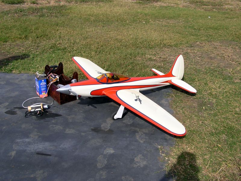

I am in the process of designing a airfoil shaped horizontal stabilizer to replace the slab design on an Sig Somethin Extra I am building. Here is the questions I have:
From an aerodynamic standpoint is it ok to go from say 3/8 thick at the root (thickest part of the airfoil) and taper that to 1/8 or so at the tip, to reduce drag. The theory I am working with here is the sheathing at an angle to the tip and root should add a bit of stiffness to the stabilizer and the reduced frontal area should reduce the drag.
The second part of my question is, will this reduce the effectiveness of the elevator where it is essentially a high aspect ratio wing given the overall deign of the stabilizer/elevator combo?
I am also considering treating the vertical stabilizer and rudder in the same manner, am I going to cause myself any problems by doing this?

There will be no aerodynamic differences that you will notice while flying by using a symmetric (zero camber) section on the tail surfaces. The tailplane/elevator is actually just a variable camber airfoil anyway, not two 'wings' hinged together. The fin/rudder is essentially the same. No doubt there will be plenty of other opinions, but the proof of the pudding etc. is when you fly the thing anyway.

Look again at the wing on the Sumthin' Extra. Now tell me again why you're worried about reducing drag in an airfoiled stabilizer?
As for thick vs thin..... Normally a thicker section tends to stall at a higher angle of attack than a thin one. But with stabilizers and fins it's a different story since they are variable camber sections due to the fixed and moving portions. So the rules the wing follows don't totally apply. The variable camber means that a thicker section isn't as important. This is why a lot of classic planes can happlily get away with flat tail airfoils.
All that being said it's possible that the airfoil nose will help keep the air more attached up to a point but given the deflection angles used in a not of 3D airplanes avoiding a stall is near impossible. But just because the tail sections are stalled in the rear half doesn't mean the tails stop lifting. They still do that very well.

Here is a fair example of light building. It is my scaled ups and stretched KenHi Panther. 84" foam core wing
And the remainder is balsa. The airfoil for all surfaces is the old NACA 0015. Total weight 17 lbs with a Moki 1.8 for power. Flys like a pattern plane that is lazy in the rolls and lands like a Big Stick.

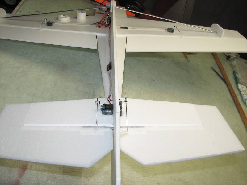

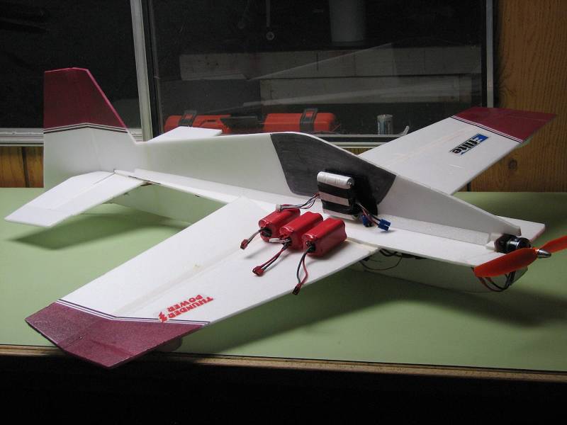

anyway -on this 16 oz (all up inc batts ) flat foamie which uses 4, A123 VPX cells - the wings are almost totally twist proof- the tubing is 31 grams for this size and they have smaller ones too which are perfect for tail bracing -just flatten the ends
The cross section makes em more rigid than any shape I have tried. far better than CF dowels or tubes.
This funny looking flat foam model, has a fuselage with same lateral area as the wing area .
The result makes for a really interesting aerobatic setup; You can do "flat" turns as fast -and with no apparant skid --as a banked turn.
So knife edge flying and maneuvering is much the same a s level flight . The other trick--I found--balancing the fuselage vertically- by placing the batteries above the wing. This improves rolls and knife edge flight .
I have adopted tricks I larnt from the funny fla tfoam models --to my big gassers - ( balance - power to weight - Low wing loading , the models really do fly better - -not as agile as the flat foam but better than they were before I started adopting learned techiniques from the flat foam stuff.
Of course the bigge was the "airfoil"- and importance of "shape".
I found that the lightest thinnest wing which was strong enough - was the best -- Look at Que Ques Biplnane flown to win the last F3A aerobatics - those airfoils must be only 7-8 %
That contest places a premium of acccurate smooth flying.
get the qeight down an you can reduce the airfoil thickness -and ofcourse the bipe configurationis a better beam load setup. (but a PTA to do -trust me on that one.
