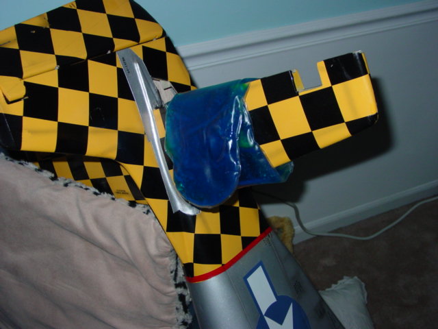

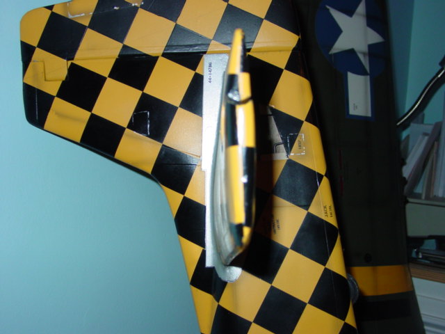

I started a 65" WS Royal/Marutaka P-51 Sr. when I was young and relatively inexperienced as a builder, then put it aside for decades. About 10 months ago I decided to revive the project. In the course of construction or during the various moves and storage over 23+ years there appears to have developed a twist in the left horizontal stabilizer.
Unfortunately I didn't notice this prior to glassing it 23 years ago or during the recent finishing stages until I started checking(yes, late...I know) elevator alignment and decoulage. As you can see painting and detailing are also completed leaving me with a real conundrum.
Is it possible to correct the twist without damaging the finishing work that has already been completed? If this were a simple Iron-on covered area the solution would be equally as simple but I have never had this kind problem on this type of build/finish.
The construction is much the same as a typical main wing, LE, TE, and ribs but NO spar, then sheeted, epoxy glassed and painted. Wondering how this would respond to heat and opposite force or just long term, gentle opposite force bracing?
The pics are a bit "busy" with the checker pattern but you can see the negative LE washout at the tip in relation to the root. The elevator is neutral at the root, and is flat and true, so the relationship is pretty obvious at the tip; looks like down elevator.
The twist measures at @ -3 deg. at the tip. Is this enough to worry about? Should I just let it be? How much would this affect the flying characteristics?

RE: Stab twist: one side. Effect?
I have fixed warped wings, stabs of various types -including those like yours
Pattern planes at one time were glassed and painted and this same situation occasionally arose.
The trick is to determine which way the twiat must be made-then - on the bottom surface, make a diagonal slit thru the covering from LE to hinge line
this MUST be done such that the twist will close the slit when pressure is applied.
Block the stab into position after feeding in slow thin drying epoxy along the entre slit- then wiping excess awy with a damp rag -or with de natured alcohol
The result will be a a hairline crack on the surface if you were careful.
can you twist it back to the normal posistion by hand without cracking anything?
if you can, and it has been epoxy coated, then twisting it back to normal with the use of a heat gun is going to help immensly.
epoxy will allow movement quite easily with the use of heat.
we repitched our epoxy glass props in Free Flight with the use of boiling water all the time to get the rpm and speed we wanted.
it works on finish surfaces too..........the trick is heating the surface evenly and patiently...........it may take 15 minutes of time to heat both sides evenly as you don't want to get it reall hot, just thoroughly heated so you don't burn paint off which you will do if you try to go too fast. then it's a matter of holding the surfacing in the new posistion till it cools.
the other trick is to use a heating pad (wrapped around the stab) and jig the the surface to stay in posistion.
once it cols, the epoxy will take on a new memory, and the wood too.
the method Dick just mentioned worked well on our pattern palnes as most of them were always foam/balsa sheeted and heat would not be applicable. with the Royal kit, the stab was sheeted over a rib structure, so the only precaution to take is to put a couple pin holes (bottom side) between the bays so hot air escapes and doesn't lead to puckering during the cooling off period.
if you leave the warp in and compensate with aileron trim, then you have a model with offset ailerons that really looks bad on the ground. 3* will cause some unhappy flight characteristics that i don't don't think you'll be happy with................it's your call
The amount of roll induced by the stab twist will be very, very minimal. It's the sort of thing that a pattern flyer would notice but most others would not ever be able to detect with any degree of certainty.
However what you ARE going to find with that twist is a strong tendency to climb that will require a pretty good amount of down trim to equalize.
Go easy on the heat if you try that option. I strongly suspect that by the time you get it hot enough to let the wood and resin ease up to twist it back that the paint will be bubbling and peeling off. You may be "stuck" with Dick's option along with a bit of paint touch up.
Not that it's going to matter since this twist IS getting fixed, whatever the method, but I would like to make sure I understand D Hanson assesment/logic. I think that the better one understands the hows and whys the better one is at (in this case) building, flying, and CORRECTLY trimming a plane...seen far too many rudder issues "corrected" w/ ail and vice versa... along with other miscorrected probs.
so, in this case, the simple issue is;
1)the Left stab will have greater induced drag which increases toward the tip where the negative inclination is greatest [fig 1] moment offset by arm
2)the center of that drag will attempt to move to the right in order to be at the centerline of travel (much like a brick on a string dragging behind a bicycle) 3) this causes the nose to swing left and would require RUDDER correction. [fig 2] moment attempts to establish linearity
compound issues are;
3)stab is acting as a stabilator with a negative ang of atk causing tail down/nose up=climb tendency [fig 3 & 4] requiring up(actually, down...thx Bmthws) elevator trim,(more drag on left, more rudder?) while at the same time...
4)the greatest twist is at the left tip again creating a moment offset by an arm causing left roll tendency [fig 5] requiring aileron trim
none of this looks good for an air frame that has a bad rep for left snaps on take-off
Summerwind, you may want to calm yourself down and adhere to polite RCU discussion rules or earn a time out. It's fine to disagree and discuss but do not belittle as you're doing.
I stand by all I typed. And frankly I don't see what you found so wrong in it.
Yes, the twist will have the effect of increasing the negative incidence in the stabilizer so it'll try to climb and considerable down trim will be needed to counter this. Looking at the first picture shows this clearly.
No the twist will not induce a significant amount of rolling action. First off the twist in the stabilizer is working over a very short moment arm compared to the span of the wing. Second the wing tends to damp out rolling inputs from sources that are not wing related. A fellow posted on another board about a short span biplane with a very long span stabilizer. Since the stabilizer was so big he thought he would be able to go with elevons and avoid the need for aileron servos. Even with a stab that was well over 1/2 the span of the wing the roll inputs did very little and the model was almost unflyable. It certainly wasn't in any way capable of the 3D style maneuvers that were intended. The wing acted to damp out the rolling inputs from the elevons with great gusto. The designer/builder said it was just barely able to turn at all even with large amounts of throw in the elevons on his Pitts'ish like design. So the P-51 with a stabilizer span that is far less than the wing span will produce an almost insignificant rolling moment from the amount of twist shown.
Yes I'm a big fan of using heat to correct a lot of misalignment woes. But in this case we've got a stabilizer that is built up with full sheeting over ribs and then has been prep'ed with glass cloth and finishing resin before being painted. As you know this produces a rather stiff structure. To soften the resin and lignum in the wood to allow the surface to be twisted back into correct alignment will require a lot of high temperature being applied from a heat gun or other source. And under that sort of temperature paints have been known to blister and peel. So I added a warning to heat the surface with care with an eye to closely monitoring the paint for signs of lifting. Nothing more and nothing less. I certainly did not suggest that heating the surface would be ineffectual or not to try it.
Nice catch on the down vs up trim. Parentheticaly corrected it above to preserve reference continuity.
These aeroD threads are fascinating, spent several hours over here today...learned alot....how do you guy know all this stuff down to " percentage KIP value at a 45* shear to the angular variation of the tangental load...."[sm=stupid.gif]or something like that.
I have a feeling this board has a lot of true engineers about. Anyway thanks for the education and cerebral overload[sm=drowning.gif]
This stab isn't really that substantial even though it is built up and sheeted, doesn't take a load of pressure with thumb and forefinger on opposite sides@ LE and TE to reverse twist it up to and a bit past true.
Just in messing with a 120* kitchen sink water heated gel pack and a refrigerator cold pack alternately over a couple hours or so is showing very promising results...@ 80% done.
wrap it hot for @ 15 min and it seems to penetrate and get everything just a wee bit looser. hand hold it for 5 min w/heat still applied, remove the heat and hold it for 5 min, then 5 more held with with the cold wrap on. then let it sit unbraced for @20 min and it feels room temp on the surface anyway. have 4 reps on it now. Seems to move back to old memory twist less during each 20-30 min rest period, I'll look at it again in the AM, see if the recent progress has held.
ORIGINAL: frets24
These aeroD threads are fascinating, spent several hours over here today...learned alot....how do you guy know all this stuff down to '' percentage KIP value at a 45* shear to the angular variation of the tangental load....''[sm=stupid.gif]or something like that.
Excellent technique. Heat is really hard to control with some methods. These packs seem to be a perfect way to apply a controlled amount.
