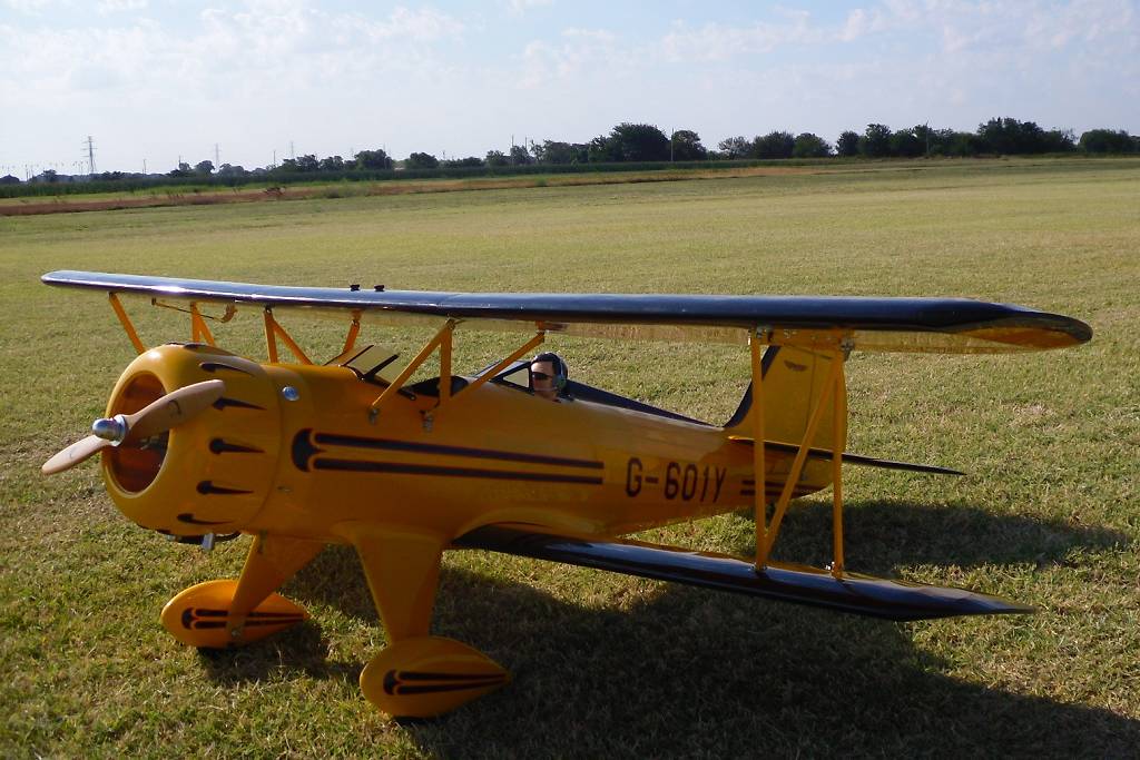

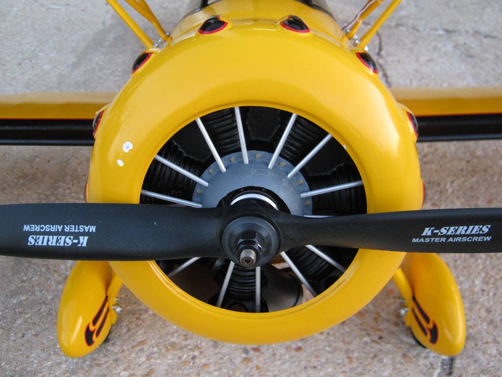

Just finished my WACO. Powered by a Saito 125 (fits entirely inside the cowl), Master Airscrew 15-8 K-series, Futaba 2.4ghz RX, Hitec HS-485HB (Karbonite) servos all around. I'm trying an 1800maHLiFE battery on this one. I used the stock muffler with a Saito 90deg adapter, which, by the way, is a P.O.S. Get the 90deg adapter from Turboheader Mufflers. The Saito adapter sheared in half as I applied modest torque when installing it...it appears to be made of potmetal. The ARF was assembled according to the manual with the exception of Mike Buzzeo's suggestion to JB Weld the nutson all of the upper wing attachment points. That will be a realtime saver at the field. Couldn't figure outthe ARF's registration: G-601Y...a 'G' registration is from the UK, but thesubsequent characters should all be letters.(?) I went with an actual registration of a WACOin the UK, a1940 Waco UPF-7, C/N 5400. Trivial, I know. Topped off with a kit-bashed Dragon Figures pilot wearing some vintage RAF flying gear...with Oakleys. It's very sunny here in FL, but the wind has been roaring for two days. Maiden Friday or Saturday...

Mr. Niven! That's a gorgeous b1rd! Best o' luck on th' maiden!
Regards,
RD
Montross, Va.

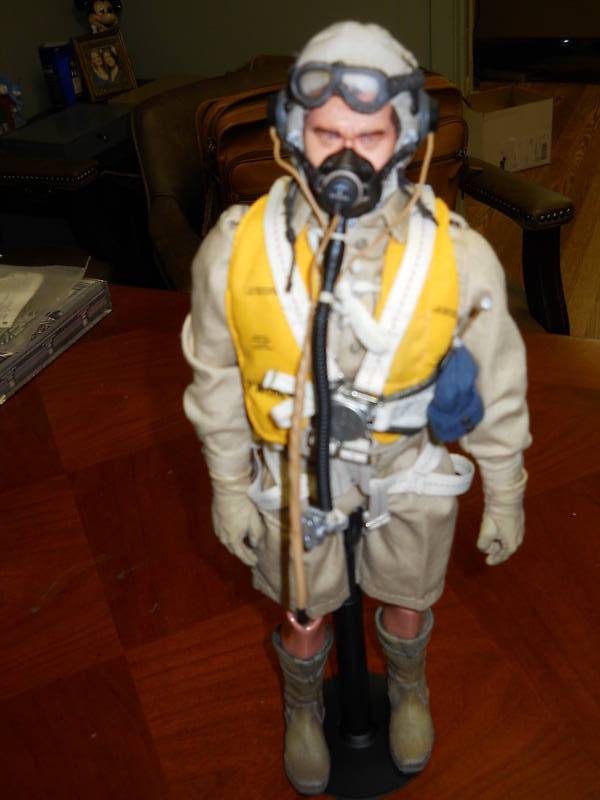

Slick looking Waco! does your pilot have a brother ?
did you get the individual outfit parts for him @ Eb*y?

The pilot was put together using parts from two Dragon figures that I found on ebay:
ORIGINAL: vasek
thanks
v.

patniven
Your plane looks great, That is the same set up I have on mine only I did not over torque the 90 deg adapter. I have used several of those and never had a problem with any of them. I am using a 2000 mah battery in mine. You should have no problems with this plane using that engine. Mine balanced out perfect with no weight required. She flies great.

Thanks Walt. I should clarify...the first Saito 90deg adapter broke in half during a normal install. I didn't overtorque it. I had two of these adapters and used the second without a problem. I'll order some replacements for future projects, but only from TurboHeader Mufflers, after seeing what the Saito adapter is made of. It literally is cast in potmetal. I've never had a problem with these adapters either, so maybe I just got a made-on-Friday lemon. Mine balanced with 2 ounces of lead mounted in the inner cowl. Got the truck loaded for tomorrow's maiden. Should be fun.
