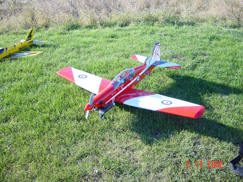

Regardless of quality, PC-9 is beautiful plane. It makes everyone to look at. Once you have tamed it, you enjoy it more. [img][/img] Other day I lost my plane (no clue what happened, it went into axial roll on its own and I lost complete control) no more radio control. Still trying to find out what went wrong. Well I may go for another one but for sure I will strengthen it and change number of things with good one. If Seagull can improve its quality I am sure lot of people will go for this kit.

I am know building my fifth scratch built 46 size PC9 , I love it when i take my 46 size flying and park it along side the arf one mine is a pc9 the Seagull and Vmar dont come near it seagull have all the decal wrong i also have a 1/5 size my e-mail is [email protected] Barry
