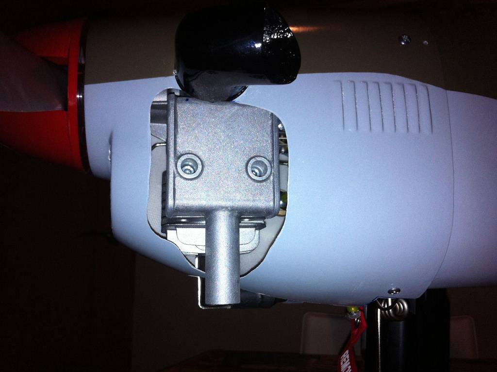

Mounting a fuel tank for a gas setup is going to be a real pain!
The glow tank has its specifically shaped hole inside the fuse all ready, and as usual goes right up to the firewall.
There are 2 problems here:
1, with gas tank so far forward, the tygon will be pressed up against the DLE 20's rear carb...
2, the dubro gas stopper is too small for this tank.
The tank's location is RIGHT inside the nose, in an inaccessible area... So I'm leaving this stage for a while as I need to think it over.....

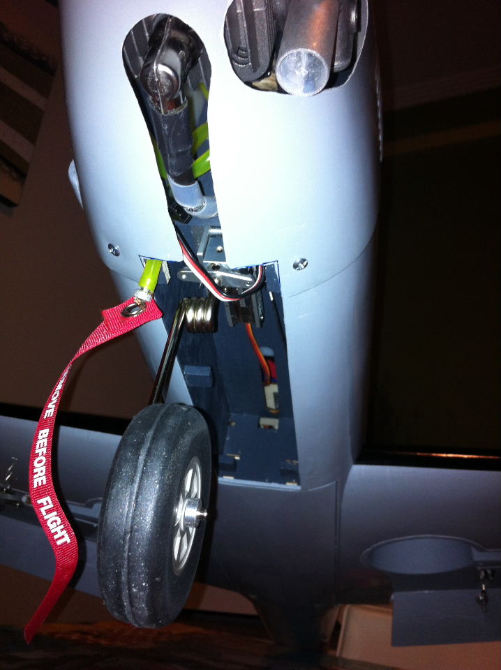

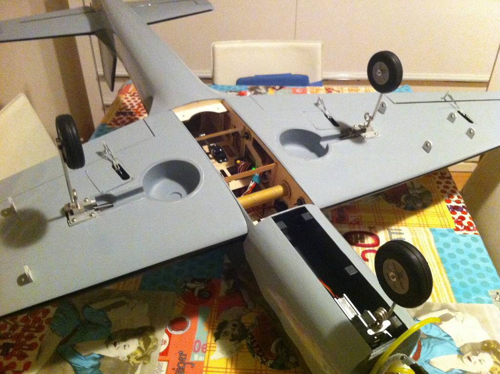

The next flaw in this plane is the retract system.

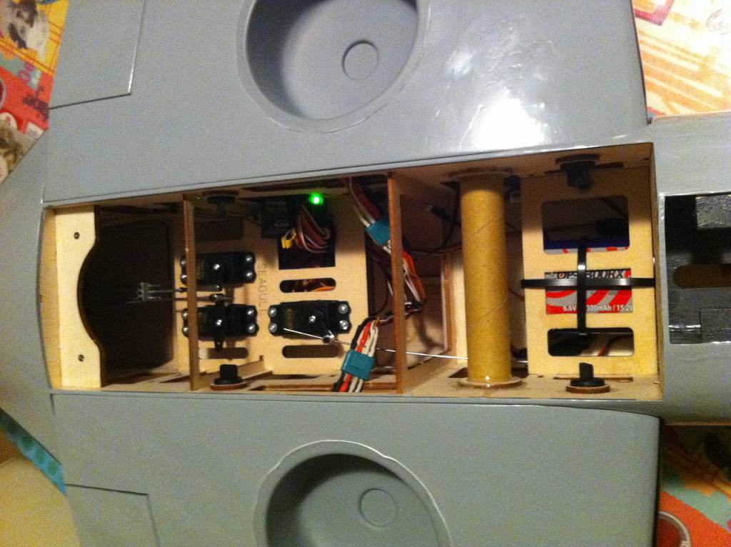

It uses 1 and only 1 servo for all 3 retracts...
Yes I said that right.... removable wings but the retract servo in the fuse..(check the manual). They intend "us" to disconnect the pushrods every time.. NO THANKS!!!
So I have bought some eflite electric retracts (90-120).. They are a perfect fit. I have the wing retracts already installed, it really was as easy as screwing in a servo.

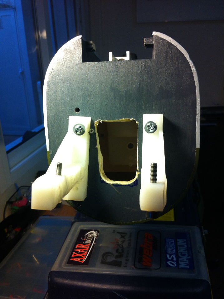

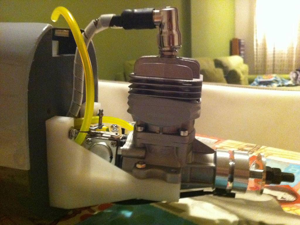

The engine standoffs were 5mm too much together for the dle20, but 10 mins shaving off nylon fixed that... I've test fitted, the LE of the mounting plate of the dle 20 measures EXACTLY to the end of the standoffs to reach its mounting point.. will be really easy to line up to the end of the standoffs to get it straight!
The undercarriage mounting blocks on the wings are "hardwood" and they say to predrill with a 2mm bit before inserting a 3mm screw.. They need to be epoxied in place first..... and in the end.. they split!! I managed to save 2 of them by re-drilling with a larger bit but I need to have another think on how to rescue the split ones.... Would´ve been better if they were ply rather than sold wood..
After so much attention to detail, I find it really silly that the plane arrives with a RED spinner when the original plane has a black spinner.... Not a big issue, nor expensive.. Just not sure why they would do that after going to so much effort in other areas.
I´m using analogue servos (tower pro sg-5010) for everything.. so In the end to save from messing about every flying day I am using multiplex multipin connectors for the servos.
2 +ve pins, 1 -ve and a for each of the 3 servos in each wing.... all made into a special Y cable for each function going straight to the RX... Should make things really fast, and i'll NEVER mix up servo wires!!!

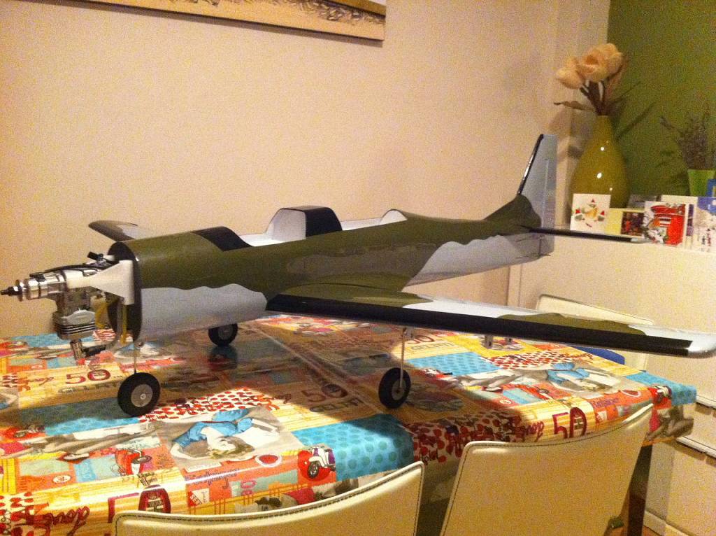

Anyway.. like always.. these threads are useless without pics... so here are some of how far I have gotten in 2 evenings work...
Now what shall I do next........

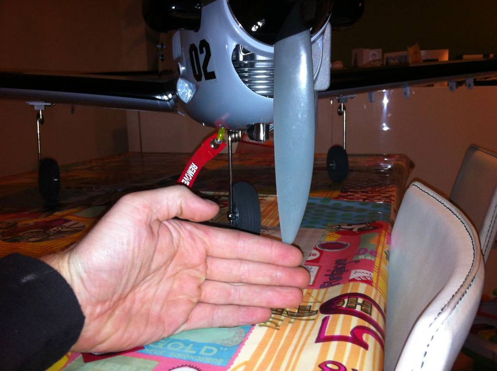

1: Yeah I might later look for a carbon tube... Maybe I just think its "heavy" as I am used to 3d planes with carbon tubes.. once I see how it flys i'll think about if I need to loose weight or not...

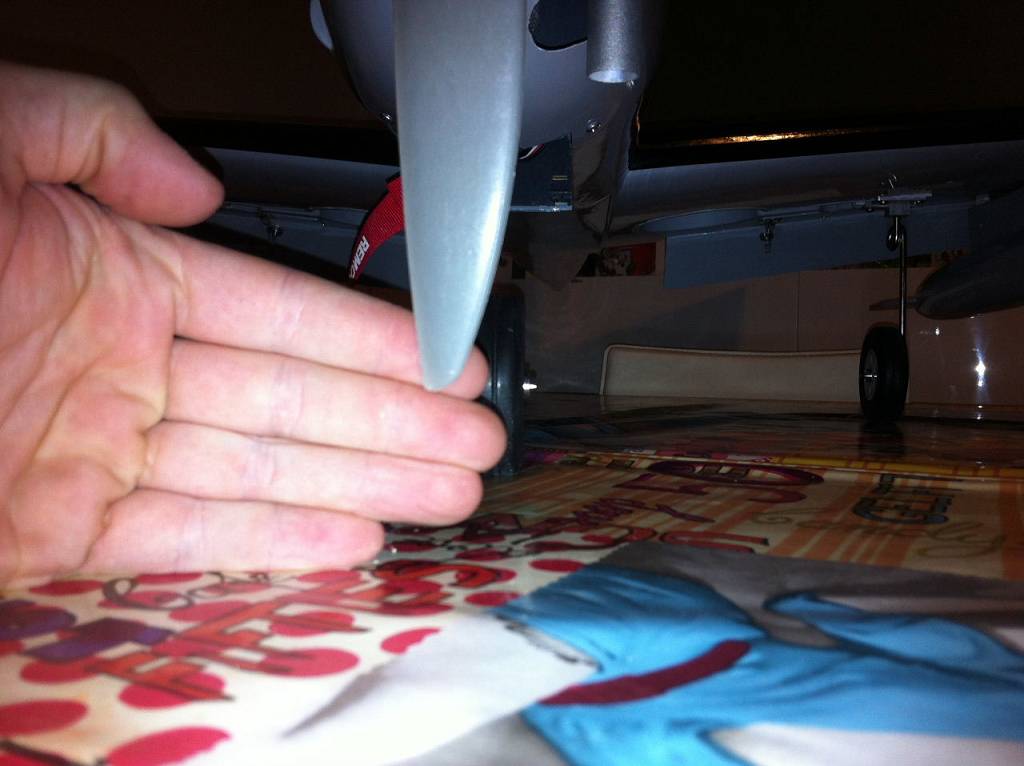

2: The Eflite struts arrive REALLY long.. I cut them so that they matched the kit's struts.. and yeah its kinda close to the ground with a prop on!

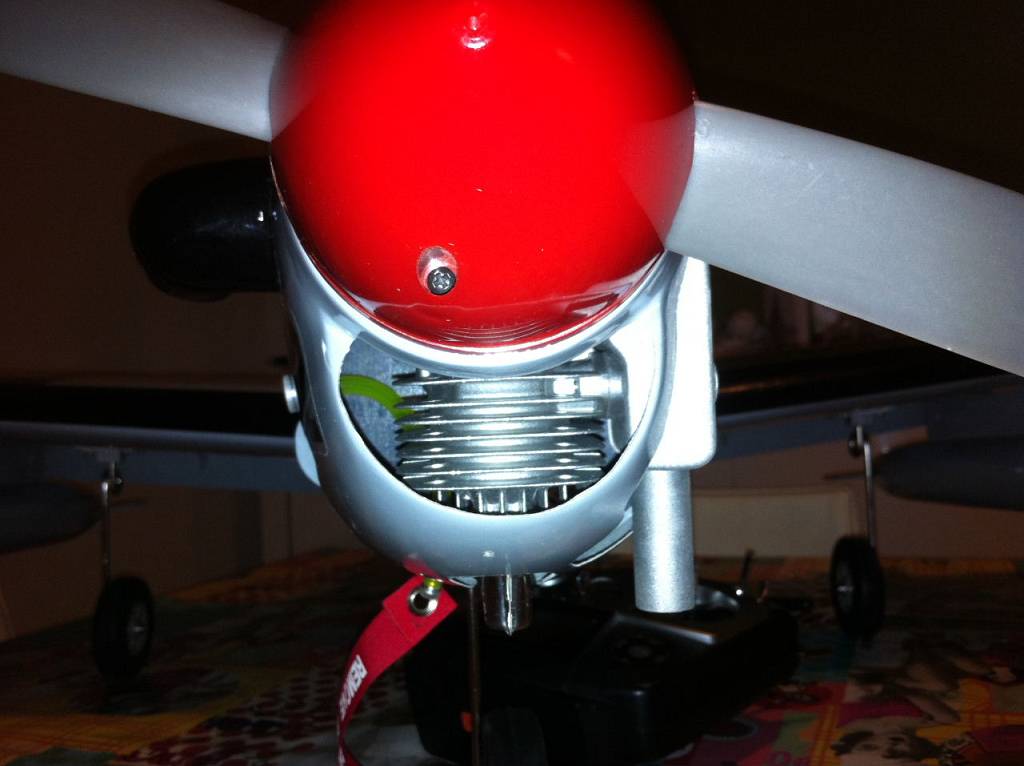

Yesterday I ordered a black spinner and added in a 15x8 prop as well, the extra inch should make it very acceptable. With the 16 there IS ok clearance.. but If there is any large stones on the
runway I dont think I could guarantee not hitting them..

Updates.. Boy you are gonna HATE the fuselage and the fuel tank area.. there is NO access. Its a shame as its a massive open space that is great for the DLE ignition. but you'll never get your hands in to secure it there!
ALso they didnt drill the throttle linkage holes in the former that supports the fuel tank, again in the middle of this inaccessible fuse!... more fun!
Today I REALLY enlarged the hole in the firewall (where the tank is supported normally) if anything because I dont need it to support the tank and I was fed up trying to fish for things all the ferking time!
I now have the wings completed, all servos installed, and all control surfaces moving...
Will do some more photos later!
More importantly!! You will need to order other 3" wheels!! the hub size is too large on the supplied ones to use with the eflite retracts. I have them installed at the moment but only so that they support the plane when I decided to put the wings on and drool over it hahaha.

I may try a 15x10 with it and see what the rpm's come out. May be touching revlimit on a 15x8 but I will check?

Are you using the stock muffler with the DLE?I'm guessing that the stock muffler wont fit inside the cowl?Maybe a nice pitts...

yeah i´m going with the stock muffler for now... spent enough cash haha
I know there are shops already selling replacement parts so if I get a pitts later i'll just get a new cowel too.
I chose the prop from the DLE20 website and its list of recommended props.... we shall see.
Yeah the rear carb fits fine.. but getting a velocity stack in there would mean even more firewall hacking..
I have been using a 10oz tank with my DLE 30, and landing after 10 mins with at least 1/3rd of a tank left over.... so 11oz doesnt bother me too much, remember that gas engines use up FAR less fuel than glow.
Since these photos were taken a few hours ago, I have installed the throttle pushrod and I have something setup to support the choke pushrod.
next stage is work out the ignition location I think.... and maybe a photo of "as is" with the wings on etc
I also need to sit an think whether I will use the pull-pull system for the nosewheel steering or if I will add another servo........ not quite sure, need to think it over.

Is there much roomfor nosewheel steering pull-pull system? How many servos in totaldoes the kit require please? (minus gear servo if go with EFlites )

only altering the retracts it is:
1 throttle
2 aileron
2 flap
1 rudder
1 elevator
(7 total).

Ok so standard 7 servo setup +1extra for nose steering setup.
Does the elevator come with adouble pushrod system? I felt theDLE will definately put more G's through the plane.What do you think?

Some more photos from this evening.
Enough for today I think... Going to take a break from the plane and pass some time playing assassin's creed hehehe
At the moment it is QUITE tail heavy... although I know there is no muffler, no cowel, prop or spinner and the battery is just tied in to be able to power the servos etc, its not a "set" location....
We shall see...

Are you running two separate Batt packs for servos and ignition?What size packs did you use for each?

Another update:
I now have the nosewheel steering installed..
Good god what a mess they made of it! And its obvious, kind of annoyed I didnt notice the problem myself!
I decided to try the pull-pull system, so I got on and installed it and noticed 2 big problems.
First it was fouling with the throttle pushrod and connector, so I had to "invert" that so that the connector is under the servo arm rather than ontop as normal..
the 2nd was that the cable tighteners are the PERFECT length to jam against the body of the throttle servo when the gear is retracted and the plane inverted..... (see first pic in this post)
SO.. in the end i've removed that, and used sold pushrods left over from the retract system I didnt use and installed that...it wasnt exactly easy either.. once retracted I was unable to get full left rudder but right wasnt a problem... not sure why, technically it should be ok but somewhere it is messing up.....

Well the build is coming to an end!
I have got the cowl installed and cut, pilots and seats installed, some of the stickers done, fuel dot and some other things.
One thing I have done to the cowl is really open up the "chin" air inlet.. I basically sanded away the rim... I know its a scale model but I still prefer it to be a little ugly and not deadstick than overhead and be pretty!
The BEST bit is that having just zip tied in a 2300 LIFE for testing/setup, I have just mounted the prop and red spinner (a black one is on the way) and tested for the C/G.... check the photo!! Hows that for luck!!
It just means I only need to add an ignition battery near the C/G and there shouldnt be too much work, I may even just go with a 2200mah 3s lipo and 2 BEC´s.... I have time to think it over before the last few things arrive.
I'm only waiting for the wheels for these hubs, canopy glue (its just taped for show atm), black spinner and a 15" prop.. (see photo of clearance with 16").
I have also been "lazy" but inventive I think.. Getting the air line for the fuel tank back for its loop was a real pain, and again its way inside the fuse.. so I pulled it through with a string, then tied that string to a part inside the fuse to keep the loop in place! I think it can be called a very simple, light and effective setup (i´ll do a photo later).

I will be needing to add some fuel tubing to the wheels to slow them down a bit.. I managed to run off the end of the runway when landing right at the head! No biggy though... also I think it is also a case of me needing to get more used to the model and more confident with landing it slower.

You mentioned about the fuel tubing on the wheels is this to create more friction to slow it down on the runway?

Yeah the fuel tubing is to add friction and work like a break. Most of my RC planes have had this... all except my 3d gasser.. which lands so slowly that it does not need it.
