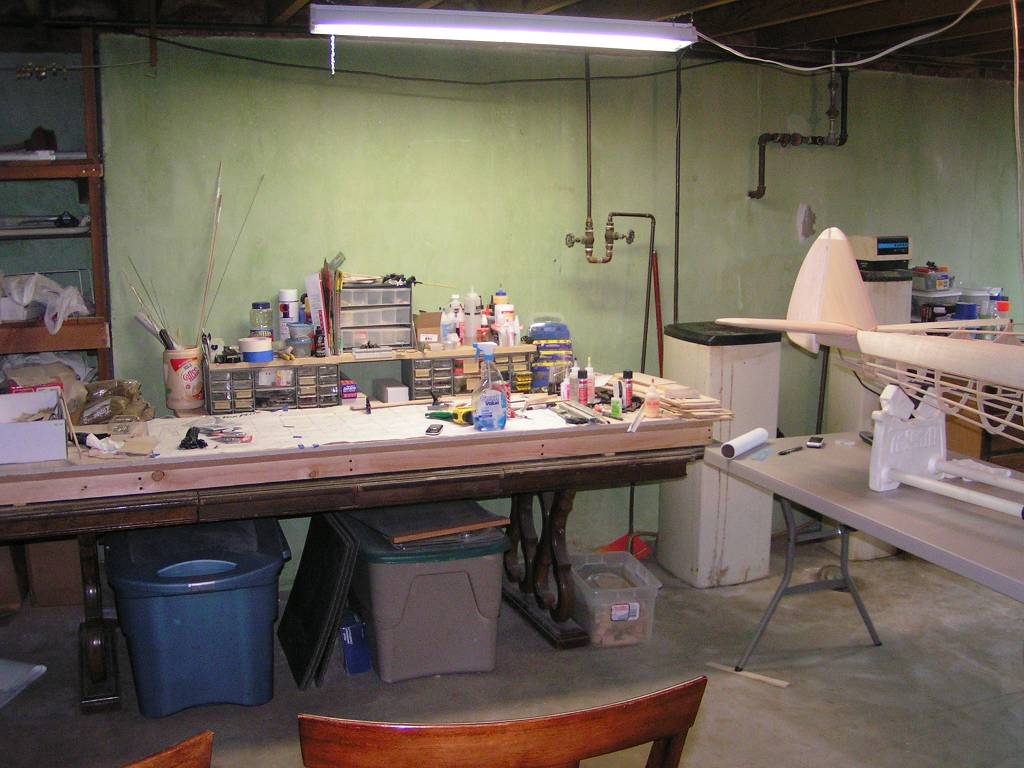

My shop in the basement is under construction, by me, so I built my new benches first.. Here is a couple pics of them, pretty happy how they turned out.. The shop in coming along, still have some work, but it's coming along..

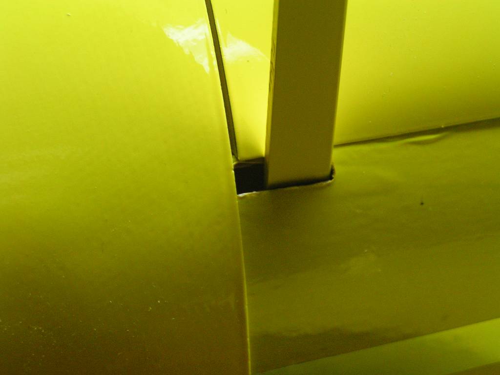

I have a few issues that I need to call Gary at GMP about on Monday and see if we can get them taken care of..
The first is the canopy turtle deck. In the first pick you can see where the paint is cracked and the fit to the cowl is poor, it is also to high at the back and to wide at spots on the fuse... I could live with the paint, a little ca and a decal and it is good as new. But with the poor fit, I will talk with Gary and see if there is anything we can do...
I also have three cracks in the paint on the cowl, tried to take pics but they didn't turn out.. They are on the top side and I plan on getting a big DLE55decal for the nose, so it should cover the problems.. The last pic shows where they left out the wood in front of the center strut on one side, I can fix that pretty easy..

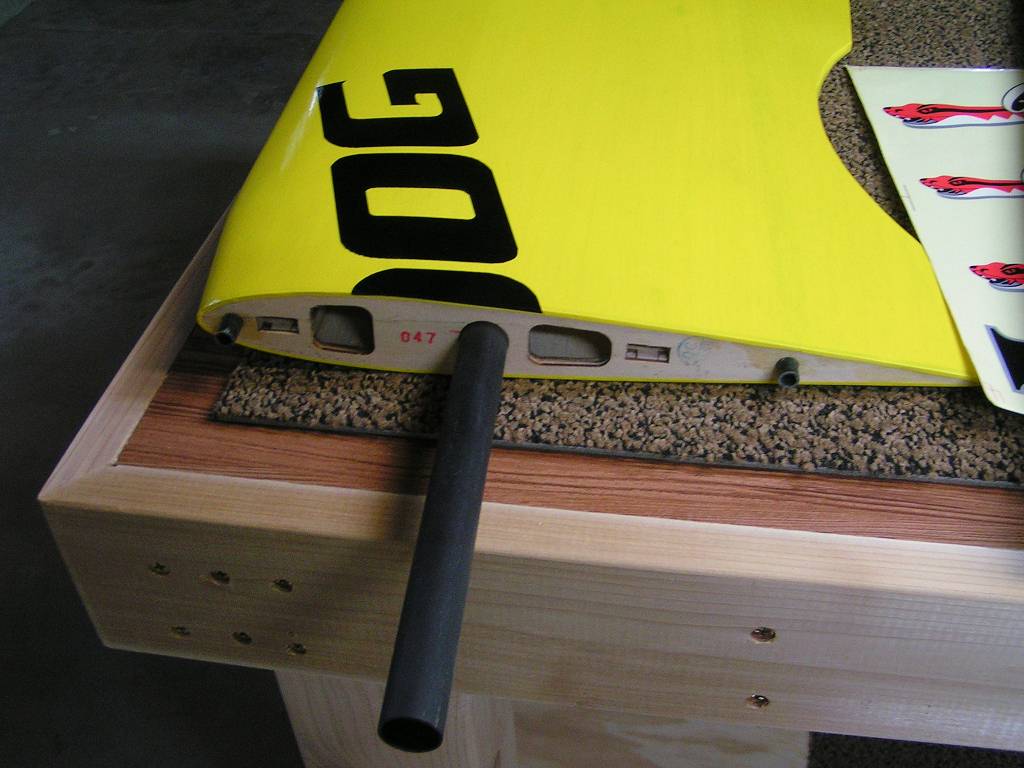

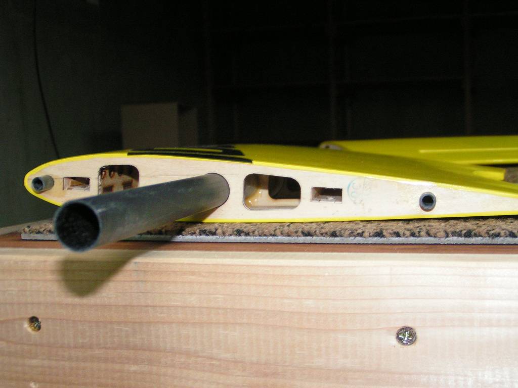

I took some pics of the top center section and the tube does go through the third rib and hits the stop ring on the aft side of the rib.. It sure was a pain in the butt to get the bottom wings on, very tight.. I actually had to put the left wing on and slide theCF tube in, I will work on this to make it an easier task. The tube slides in the panel fine, so it's an alignment problem.. I also have to tweak the top wing holes at the center section a little, not a big issue..
I do see what you mean about the 12 screws that attach the top wing and the cabanes, this was a task in the comforts of my shop, I can only imagine what itis like at the field in 90 degree heat!! Mine are a cheap philip's head with the built in washer with a 5.5mill lock nut on the back, this is being changed for sure.. I think I will make a ply piece on the the nut side and have the nuts locked into the ply and then change to a good allen cap screw...

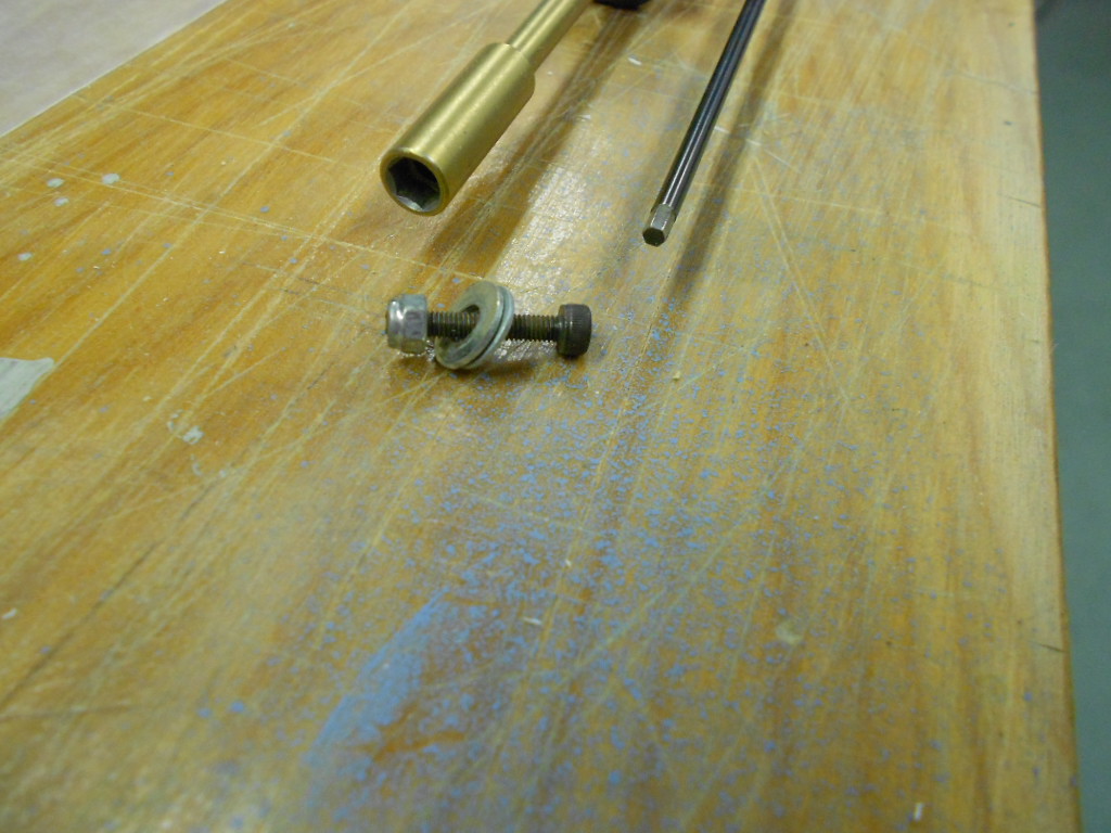

Yeah,, just look at the pictures, LOL
It's obvious the used a computer translation program,, too cheap to hire some one bilingual
I dumped the crappy hardware and use 3mm Allen bolt/nuts. the nut/bolts and wrenches are from when I was racing rc cars,, good tools and good harware is a must

ORIGINAL: scale only 4 me
10/4 on that......... Do you ever have a problem with the screws holding the center section to the struts coming loose? Being they are upside down and just go into a blind nut, it has me thinking it might be a problem...
ORIGINAL: Mustangman40
Scale,
what motor do you have in yours? I went with the DLE55, going to mount it today.. Was just wondering how you did the cooling on yours.. It calls for a 3-4'' spinner, which I still haven't decided on yet..
She fits captain, but it needs some cooling holes...lol[img][/img]
I've been flying it with a Brison 3.2, the original owner had a DLE55 also, the brison fit with no additional cutting,, Lets just say the OO wasn't afraid to remove fiberglass.. I do have a new cowl for this,, maybe I'll replace i t,, that's ugly,, good thing it's on the bottom,, LOL
plenty of entrance air flow with a 3.5" spinner
Yeah I see what you mean. lol
The 3.5" spinner looks like a good fit for the plane, thanks for posting the pics..
Jimbo
No, I use the same allen bolts and crank them down tight,, so far never had one come loose
Thanks a bunch, I think it will go into my pre flight to do a quick check of all the screws....
