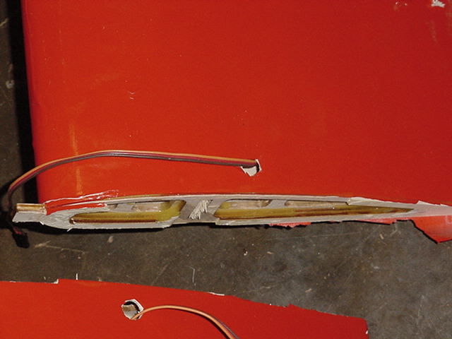

I finally worked the nerve to fly the GeeBee today! With the OS FS-120(pump) it had plenty of power, but it certainly doesn't jump off the runway. I was easily able to achieve long takeoff rolls with little or now rudder input. My first flight I was a little tenative because I could tell the wing loading is heavy. Loops and rolls are very smooth and graceful.
Now for the bad news! The first landing was uneventful except once on the ground it rolled much more than I expected and ran into the tall (unmowed) grass at the end. I'll take that anyday. On the second flight, flew 8 minutes and set up what I thought (and others thought so also!) was a great approach. I got the wheels on the ground and it was like the plane hit a ditch, it just stopped, flipped and ended up on it's top.
After much talk around the field, we came to a few conclusions. The landing was a little hot....despite what I've read here the plane can be flared much more than I did on my last approach. I "softened" the springs in the robostruts, and with the hard landing the struts and wheels compressed enough to allow the wheel pants to dig enough to stop the plane (based on the wheel pant damage).
The damage? The right robostrut basically ripped through the wing. I may do a postmortem on the wing, but I'll not repair it. I've already ordered a replacement. The right robostrut is out of alignment, so I'll try and straighten it, and if all else fails I'll send it back to Robart for repair or I'll replace it (I just need the wire mount). The good news...not a scratch on the Fuselage (that I've found yet) other than some dirt on the top of the fin.
So, I"ve ordered a wing kit, wheel pants, and some new decals. The hardest part is that I'll have to remove the original belly pan as a new one only comes with the fuse kit. At least my old one is already fitted.
Anyway, just like's been posted here before....takeoffs are great, flying is great, landings suck!
