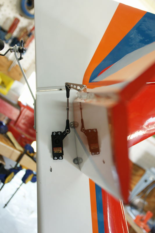

More pics from the build
#8, #9 - at least 45* elevator throw L and R; note difference in rod geometry; servo arms are 1 1/4"
#10 - note that the pull-pull cables change direction on entering the guide tubes. There is a conduit (black) on the port side for the elevator wire; if you use dual cables, there are also holes in the formers on the starboard side to secure the cable for the R elevator servo
#11 - pull pull setup; Aeroworks hardware on all control surfaces
#12 - large fuel tank - note rule
#13 - solder spliced, not plug-in extensions
#14 - AW hardware, 1 1/4" aileron servo arms

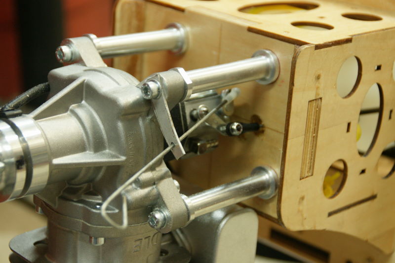

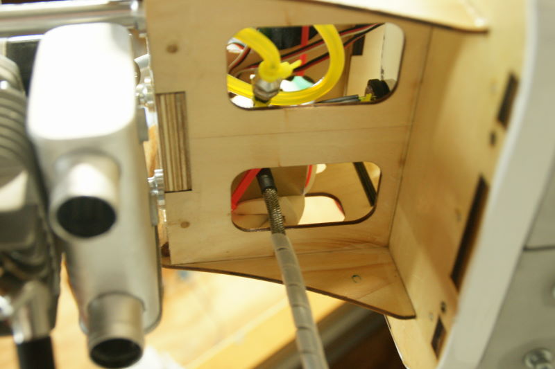

The firewall is solid, and the carb venturi is only about 7/16" away. On the advice of the small engine gurus, you know who they are!, i drilled the FW at the intersection of the centerlines (where the carb faces) with a 7/8" brad point bit to provide unobstructed carb airflow.

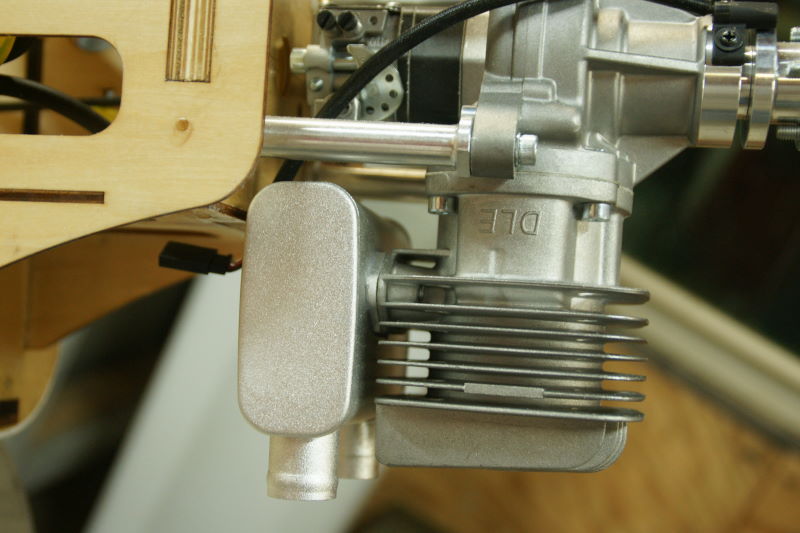

The DLE55RA fits beautifully; cowl requires minimal trimming. The muffler/diverter does not interfere with the engine box at all.
I did find that the ignition does not fit well. Book recommends for it to be on top of the engine box, but if there, it interferes somewhat with the cowl ring as one installs the cowl. There is insufficient clearance to mount it on either of the sides. One option is the bottom outside (or inside) of the engine box, but I chose to mount mine INSIDE the engine box, starboard side (on the port side it would interfere with the throttle linkage). There is plenty of room there (see photo below). I put my ignition battery on top, which does not interfere with the cowl ring.

#18, 20 - muffler fit; it is close, but one can get to the mounting bolts for the muffler with the engine installed. In #18 see hole in FW

#21 - Choke linkage; i used the snap on ball link provided. it is a PULL-ON geometry, not a PUSH-ON
#22, #23 - Ignition module installed inside engine box

ORIGINAL: wjcalhoun

Seams like you would want the full flange on the firewall for maximum bearing and less chance of crushing the wood. WJ, thanks for all your effort in sharing the build photos. Seams like you were able to get alot of deflection on the elevators.

S&S
I hear what you are saying about the direction of the standoffs, but i think the idea is that you can pull them down tight against the FW with a wrench. Actually, i had no problem getting them tight with a rubber gripper and an allen wrench, so i did not need a wrench to snug down my standoffs to the FW.
I would not presume to have everything right, so i am very interested in seeing other builds. For example, Spridal's issue with the plywood support for the stab tubes is something i will address.
On the elevators, yes, there is nice deflection. I'm hoping it will be enough to do harriers / hovering with the R90.

ORIGINAL: wjcalhoun
Spridal:
Is your point that the ball link should be under the tiller arm to reduce stress on the servo bearings? if so, point taken. if not, could you clarify?
Spridal:
I was actually referring to the way you have the control arms mounted to the rudder. The flange appears to be to close. I don’t think you are getting the full bearing strength of the control horns and with the vibration from the engine could cause issues. I would re-drill the holes to get a little more separation at the flange. Take a look at your Ailerons, and then compare those to the Rudder.

RE: 50CC REVOLVER!!
ORIGINAL: wjcalhoun
Another quirk about the DLE55RA, which you can see in Pic 21 above (choke linkage). The standoffs normally install with the flat-sided end against the firewall, and the full flange against the engine. However, the SHCS that hold the two crankcase halves together interfere with the full flange, and one has to install the standoffs backwards, with the flat-sided end of the standoffs against the engine mounting lugs.
