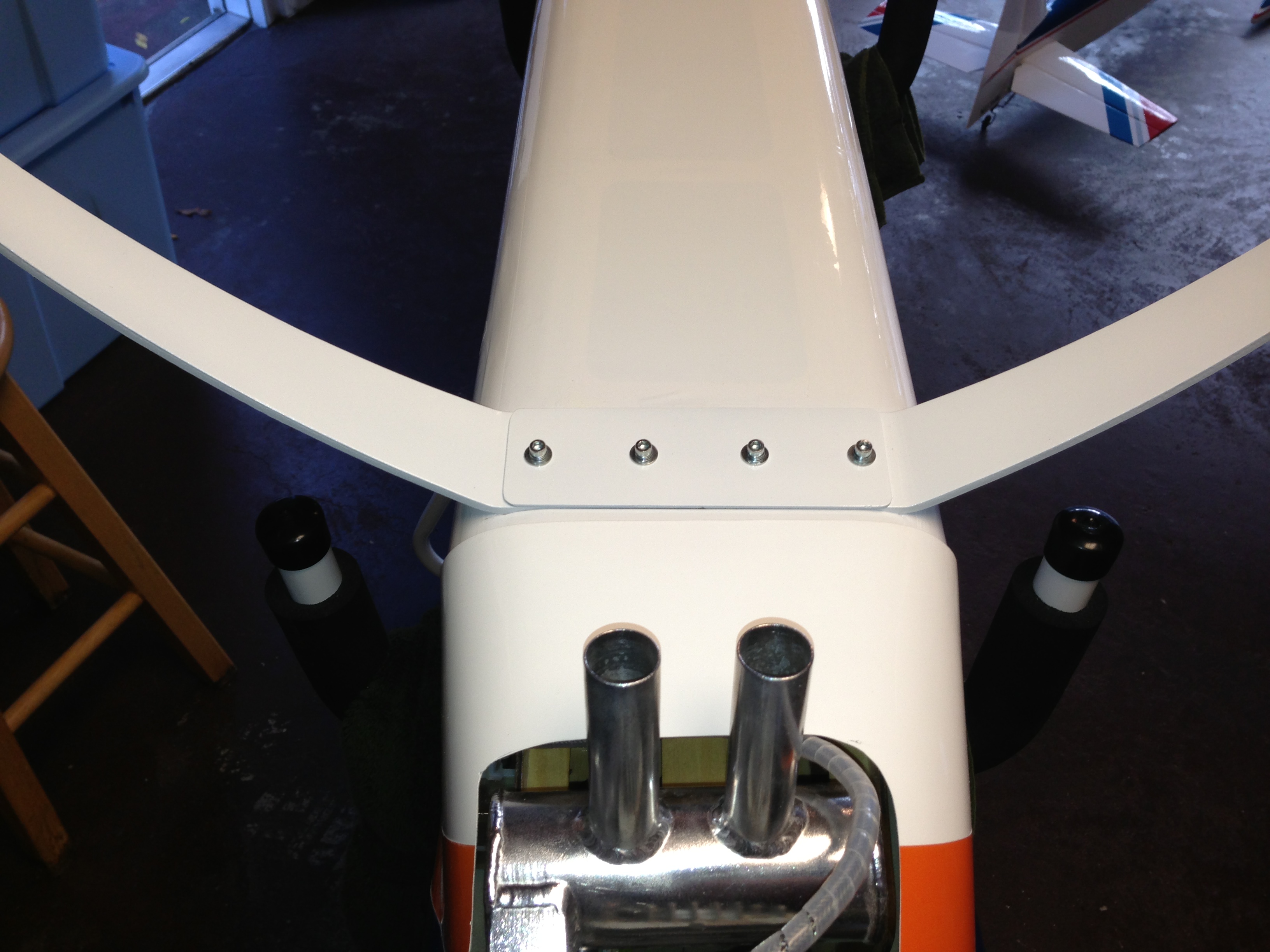

There two methods and two area's to do this. I prefer to tie the two piece's together using a metal strap and all painted white to look good. The landing gear block needs to be tied to the firewall better to avoid shearing the gear backwards when coming against an optical like an ant hill or even tall grass. The easiest way is to use bamboo or 1/8 wood dowels. Just drill a series of holes at a 45 degree angle from the front of the firewall back, at a downward angle to pin the LG block to the firewall. The LG block is so close to the bottom of the firewall that it doesn't take much force to rip it out. I still have my 50cc Revolver and after two years the gear has never given me a problem. My first 70 inch revolver is similar, and the gear came off easily before I did the modification

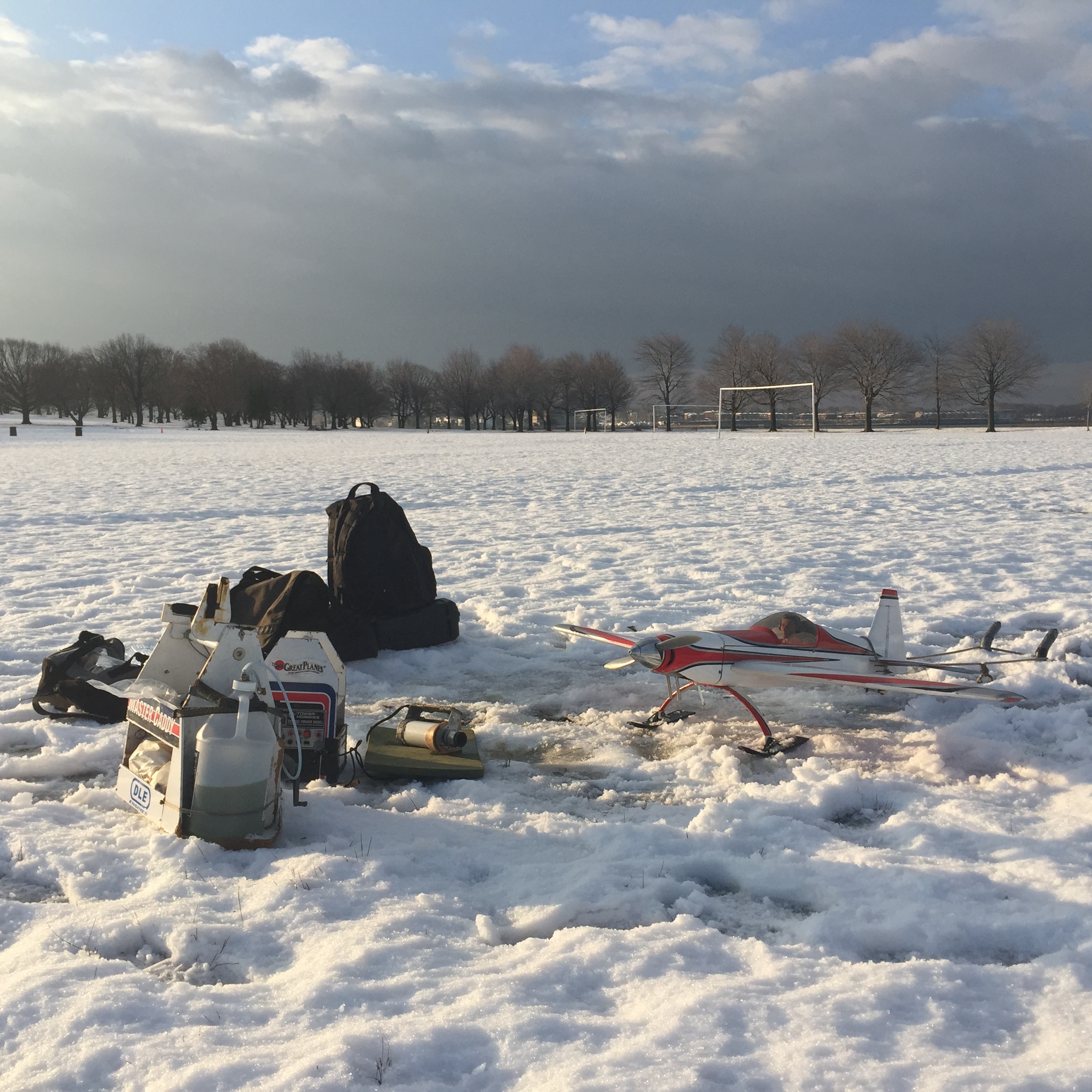

Has anyone flown the 50cc Rev (aka, Rev90) on skis yet? I'm in Queens, NY, and just had my first ski-fly on Sunday with one of my Rev 59's. Love flying off of snow. We're just now getting dumped on - reports are 2-3 feet of snow by tomorrow night and winds up to 70mph (i.e., NOT good flying weather), so we'll have snow on the ground for a while (which makes me happy). The largest RC skis I've seen online are the aluminum ones from Maiden Model Products. Will be flying a Rev 70 and one other plane (tbd) on skis this Saturday. Attached is a picture of "Basecamp 1" from Sunday morning, and another of the Rev 59 (clouds were blocking the sun, so looks dark)
