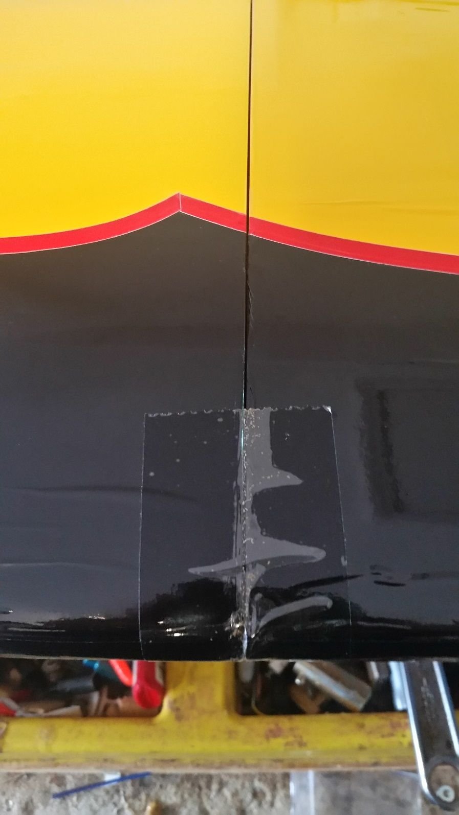

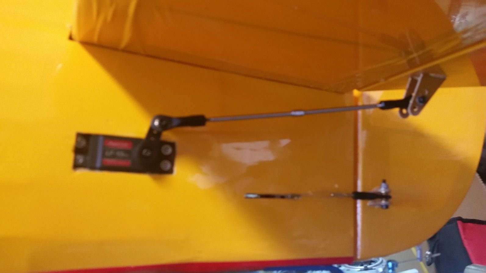

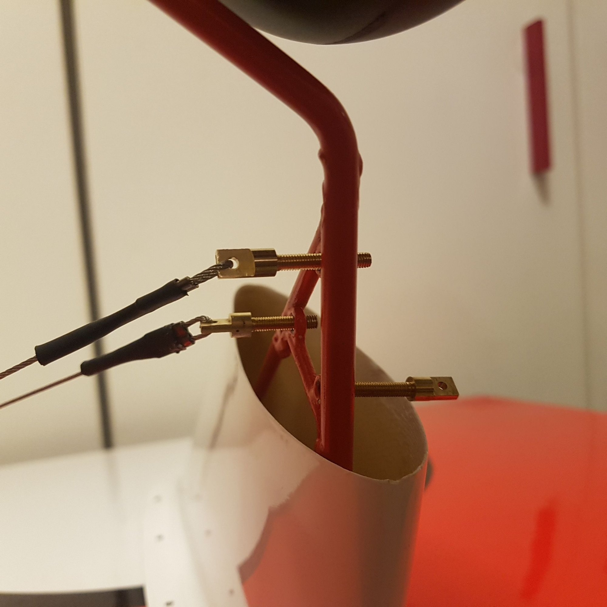

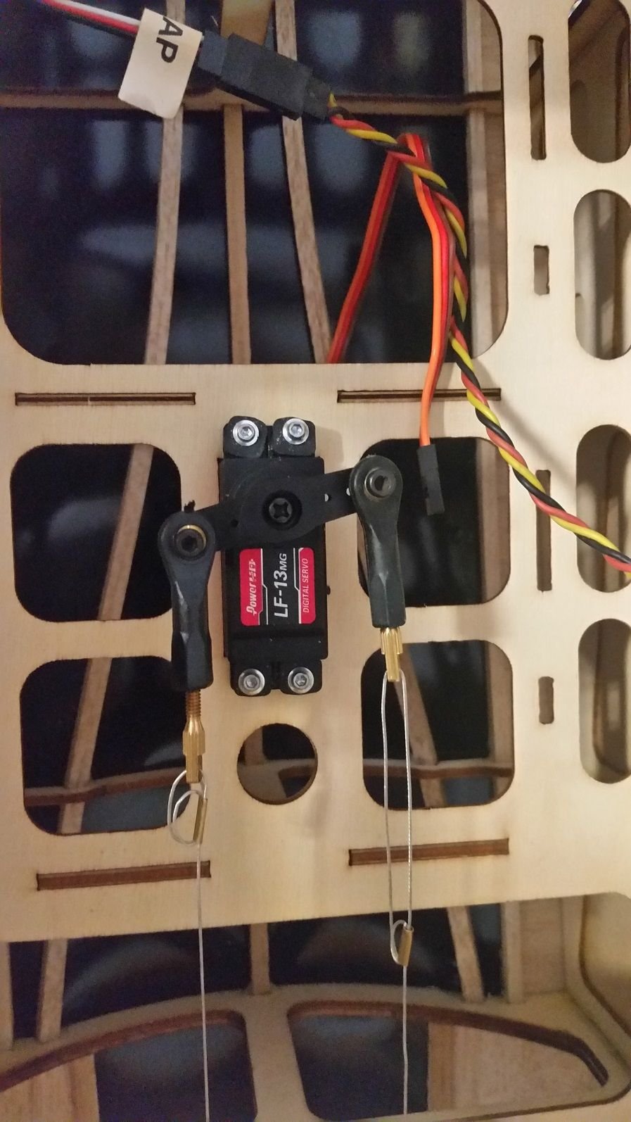

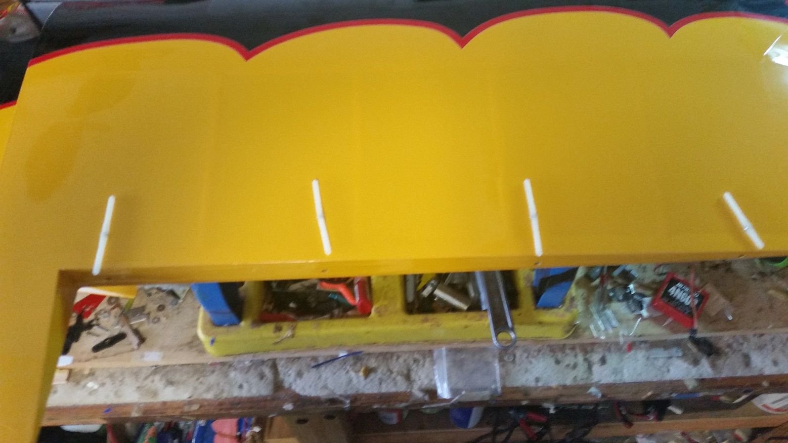

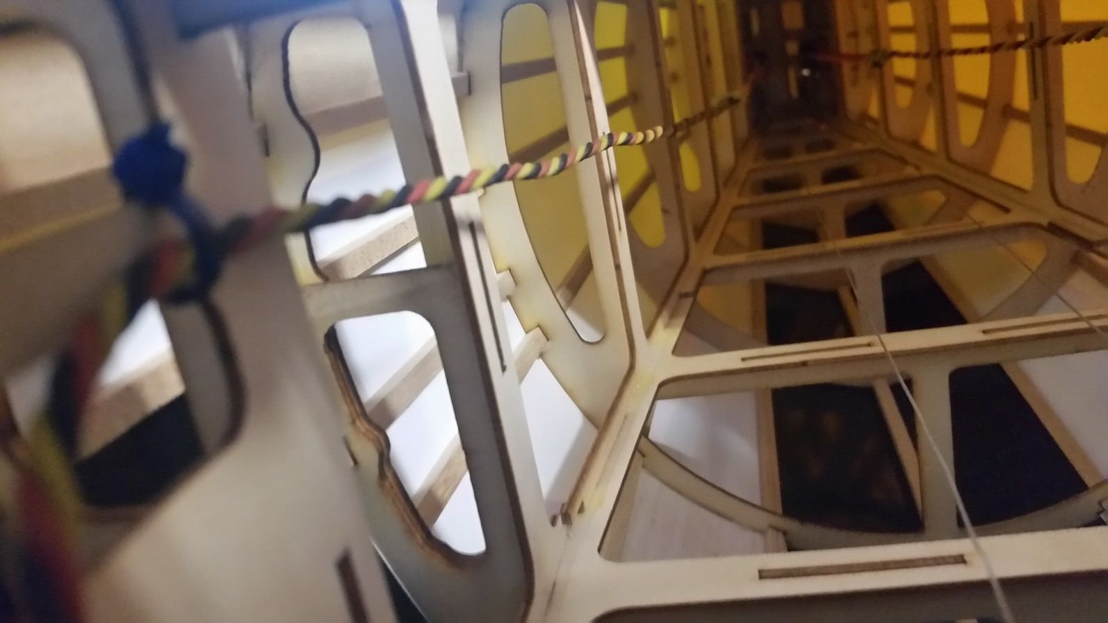

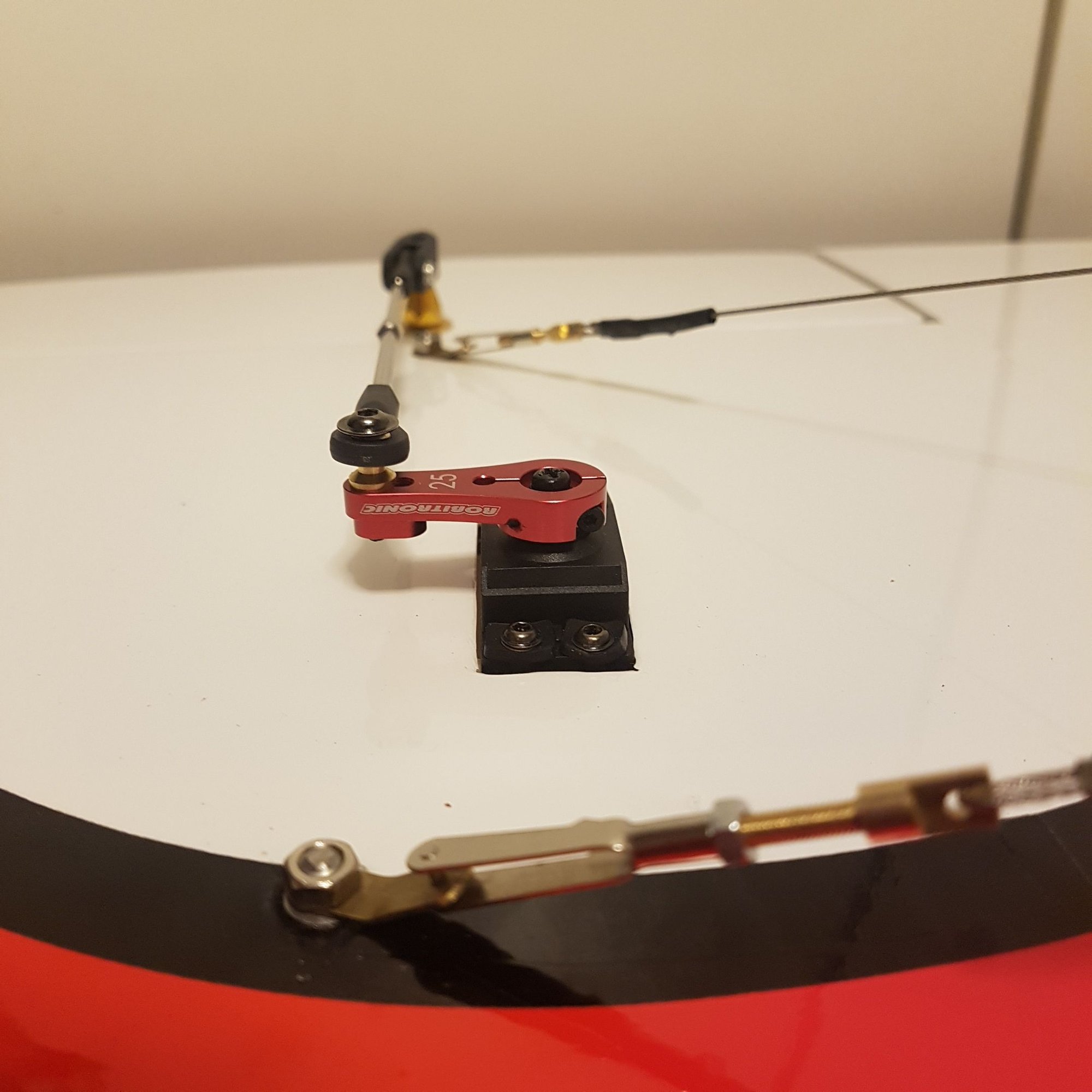

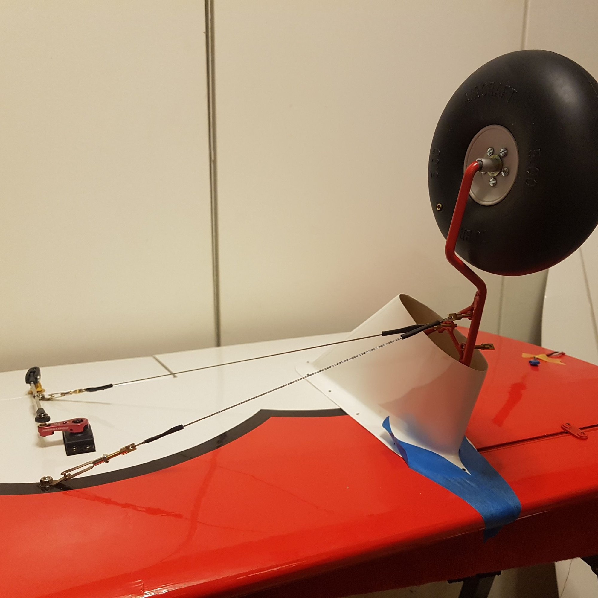

Will I worked on the Gee Bee today and here are a few pics I took. Things are coming along pretty well.
Rudder pull-pull
Pic#1 Rudder Pull-Pull
Pic#2 Elevator servo lead extensions
Pic#3 Elevator Servo and control horns
Pic#4 Robart style hinges for all control surfaces
Pic#5 Tape holding both wing haves together
Pic#6 Elevator and Rudder

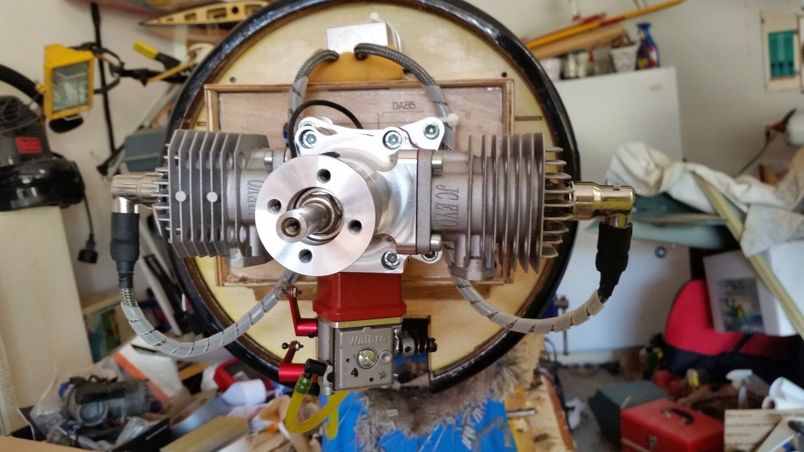

Mounting template on firewall is for a DA 85. I thought this was a 50cc Plane

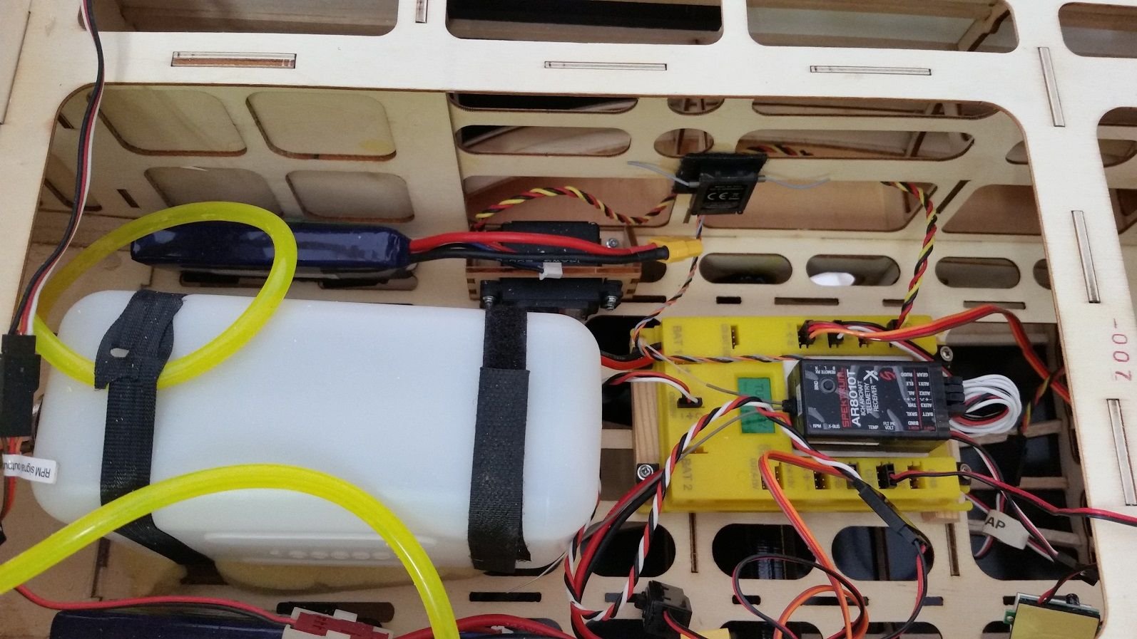

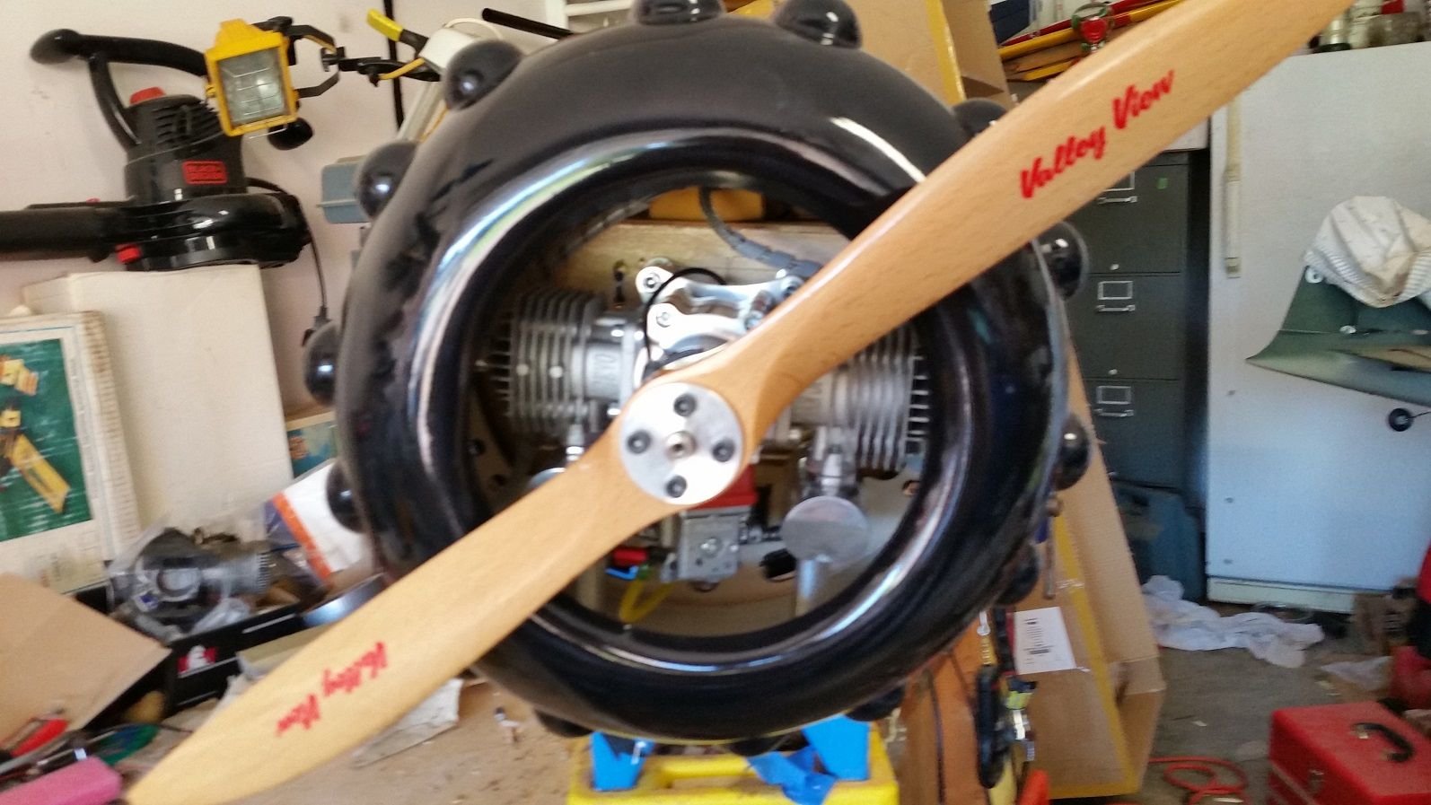

JC 60 Twin
Fuel Tank and power board
I have the JC 60 Twin mounted and I got the fuel tank and power board installed. Here are a few pics.

Here is a pic of the JC 60 twin with the cowl on.
JC 60 Twin fits perfectly inside the cowl

In your opinion, is the mounting bracket for the main landing gear seem sturdy?

I saw the firewall was marked for a DA-85. I had a DLE-60 twin I wanted to use and it fit on the firewall just fine and it is a perfect fit for the big cowl. I have a VV 22x10 prop on it for break-in I just hope it is strong enough for this plane. The web site said this plane was a 50cc bird. I was very surprise to see the firewall marked for a DA-85. I am almost finished and will post more pics when I am done. Just have to balance the plane and test run the DLE-60

from front to back it seems strong enough. Just not real sure about side to side yet. I will be testing it for ground handling before the maiden flight and any bad thing should show up there.

I was thinking it might not be a bad Idea to make a side brace for the landing gear ,even if it had one brace from the side of the strut housing where the rear brace mounts to the root of the wing where it joins the plane .Like a 1/4" carbon rod . we have quite a short field and on a calm day we sometimes have to make a sharp turn at the end of the runway to prevent going into the pickies

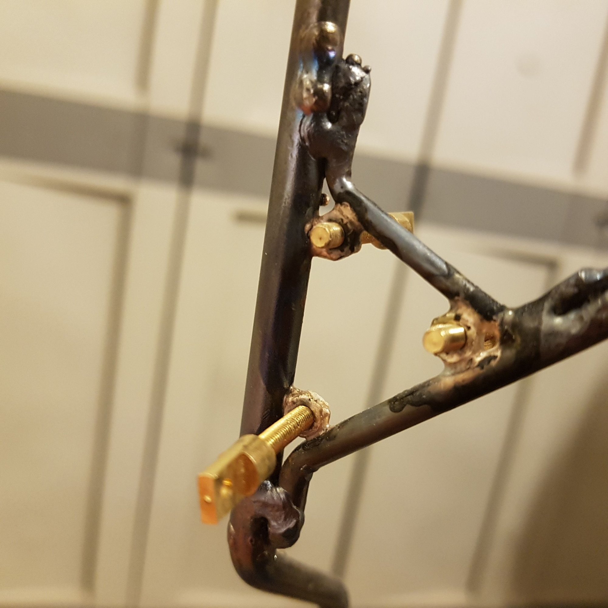

Just to share some of the mods to stabilise the LG laterally. Brazed some M3 nuts and used long eyebolts to mount the flying wires. Painted the wire legs to good effect. Looks like it will hold some skidding.

At the wing attachment areas, what did you do to create a hard-point?

The Maxford kit provides pass-through aluminum tubing preinstalled in the wings, the original intent being to thread the flying wires through. I passed an M4 threaded rod instead and secured it with nuts on both sides. This then acts as a hardpoint for the clevises on the wire runs... Pics to clarify.
