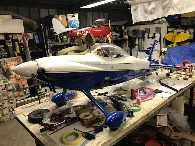

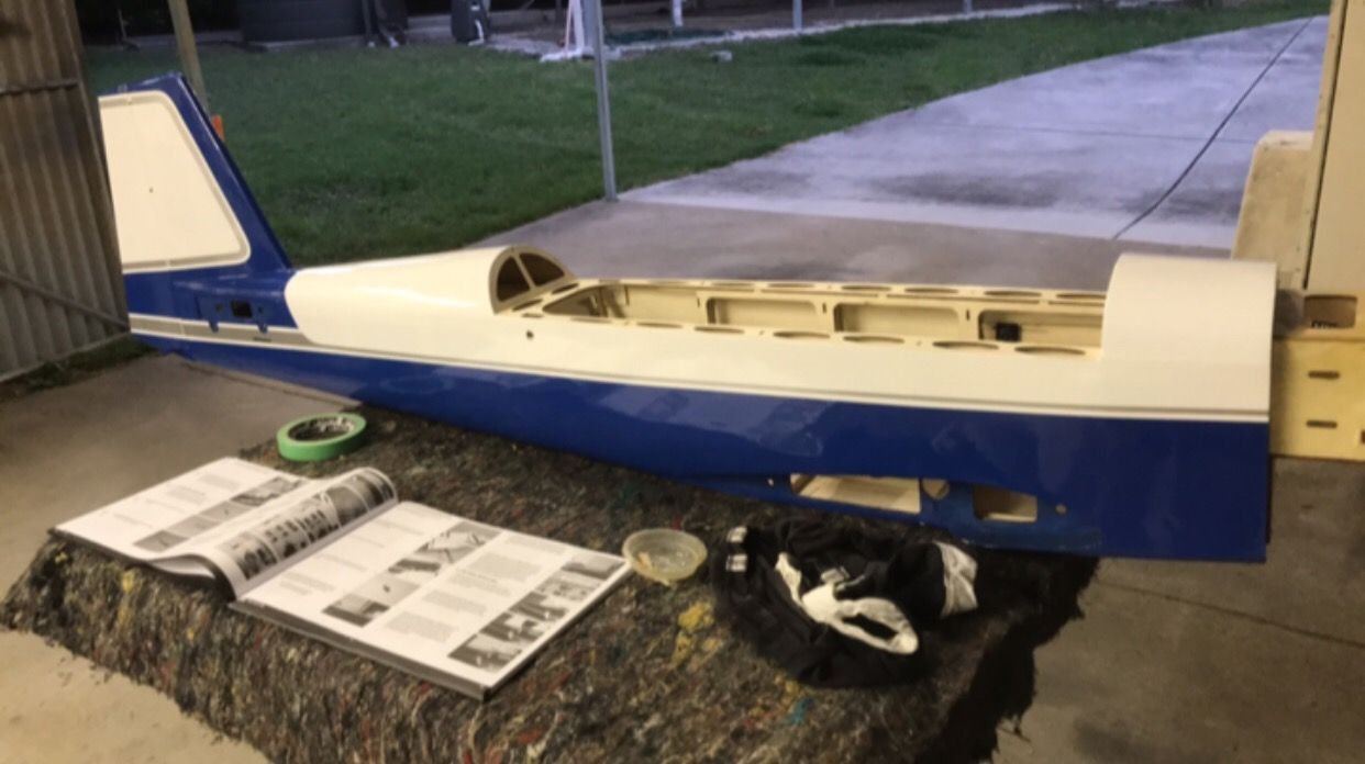

Got one of these recently as a Chrstimas present to myself, being a batchelor these days I can induldge without a nagging SHMBO gettting the crankypants.
Seems to be faily good quaility though the covering has started to wrinkle up, not a bggie as I will hit it with a hardryer and hot glove once I am finished.
Small amount of damage to the upright support on some of the ribs near the aileron hatch, looks to be from pressure applied during manufacture or something pressing weight into that area. I patched it with double thickness of 1/8th balsa with the grain going vertically.
H9 hardware is pretty ordinary, the threads on the rods in particular. Will see how they work out.

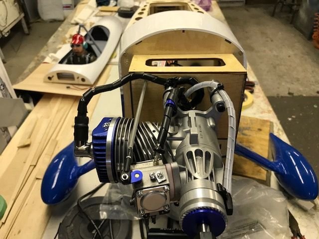

Using the stock Evo 33GX petrol on for simplicity sake and will add a choke servo.
Throttle linkage has been changed to nylon rod and dubro 2-56 ball links. I'll use the H9 throttle rod for the choke but with a dubro 2-56 ball link on the choke arm.
Still contemplating replacing the H9 clevises.
Hoping to get it all completed over this week and Saturday and look forward to flying it. Should be a fun plane for Sundays fun.
cheers
P

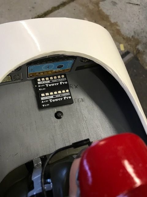

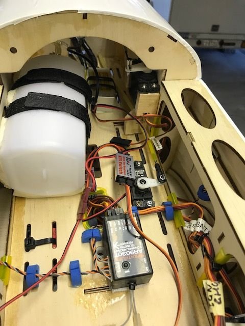

Bit more progress last night.
- fuel tank and dubro large scale fuel port installed
- ignition system installed, still to complete the opto kill switch install
- battery monitors for Rx & ignition plus the ignition LED - will combine the leaqds into a single 6 pin MPX connector.
planenutzz is offline

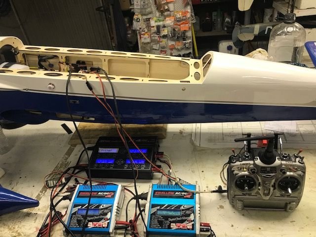

Completed the electrical install in the fuz last night. Might have to move one or two battery packs reward yet, will see when I do final CG check.
Canopy is fitted though I expect I will need to add a bit more canopy glue here and there for areas it did not take very well.
Still to put some plugs on the end of the leads for the lights that are in the wing.
Have done the bulk of the radio programming including flaps. a few tweaks for throws still to do. Should be able to do an engine run on Sat. Manual for the evo 33 says not to go over 1/2 throttle for first tank full. they must be a very finicky engine if that is the case. yup I mixed up a batch of 20:1 with mineral oil.

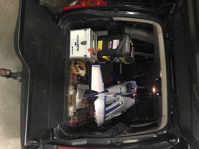

Well the good news is that I test flow the RV-4 on Sunday. Weather not the best with cross winds.
Ground handling was very good and take off roll straight down the middle of the strip with very little rudder required. I did notive it took a fair bit to haul it off the deck, I feel I'm a bit nose heavy and will need to move 1 battery pack behind the spar.
Climbed out ok just a tad steep. Minor trimming on elevator and a touch on ailerons. Roll rate was ok as I had only set it up for moderate throws. Engine being new was quite rough half throttle and below but as its running on a 20% mineral oil mix for bedding in that is to be expected.
Half flaps were tried, no pitch changes and full flaps as well which was like slamming the brakes on! Landing was tried on half flaps and the thing just floated and floated eventually bouncing down, not pretty but ok. Idle was a bit high which would not have helped.
Only one flight as wind picked up then it started to bucket down (rain) so packed up, drank coffee and talked nonsesne with my mates for a bit. Home by 1030.
Taking it out aain on Sunday but will move one battery pack as advised and see how it like that.
It fits nicely in the back of my Landrover Discovery (LR3) too, nose in between the seats. Was worried it might be too long.
