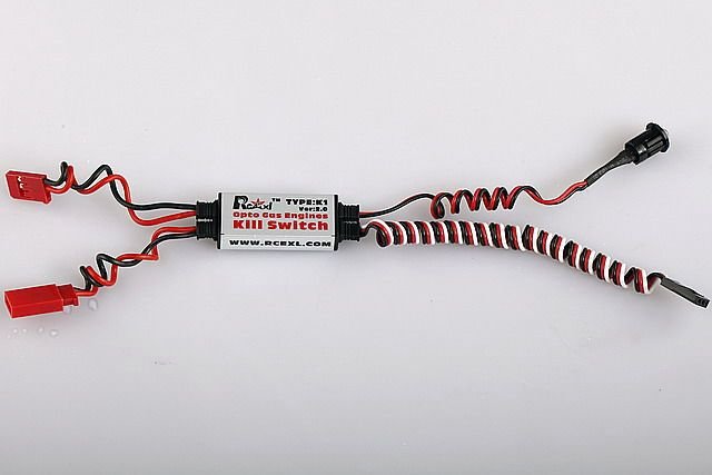

I just finished up one plane and so now the RV-4 is on the bench. Quick question. What are you guys using for a simple controller for the lights? I want to tie them into the flaps so that when flaps down, lights on. Thanks in advance.
Jason
I use the Rxcel opto kill switch. Same type of unit that I use for the igntion kill.
Use a seperate battery, have the Rx lead go to a spare channel and do flap to that channel mix or just use a Y lead off the flap channel.
The unit is an opto coupled sold state relay. Rx triggers it to on and allows current flow from the seperate battery. Do not use your flight batteries.
clear as mud?

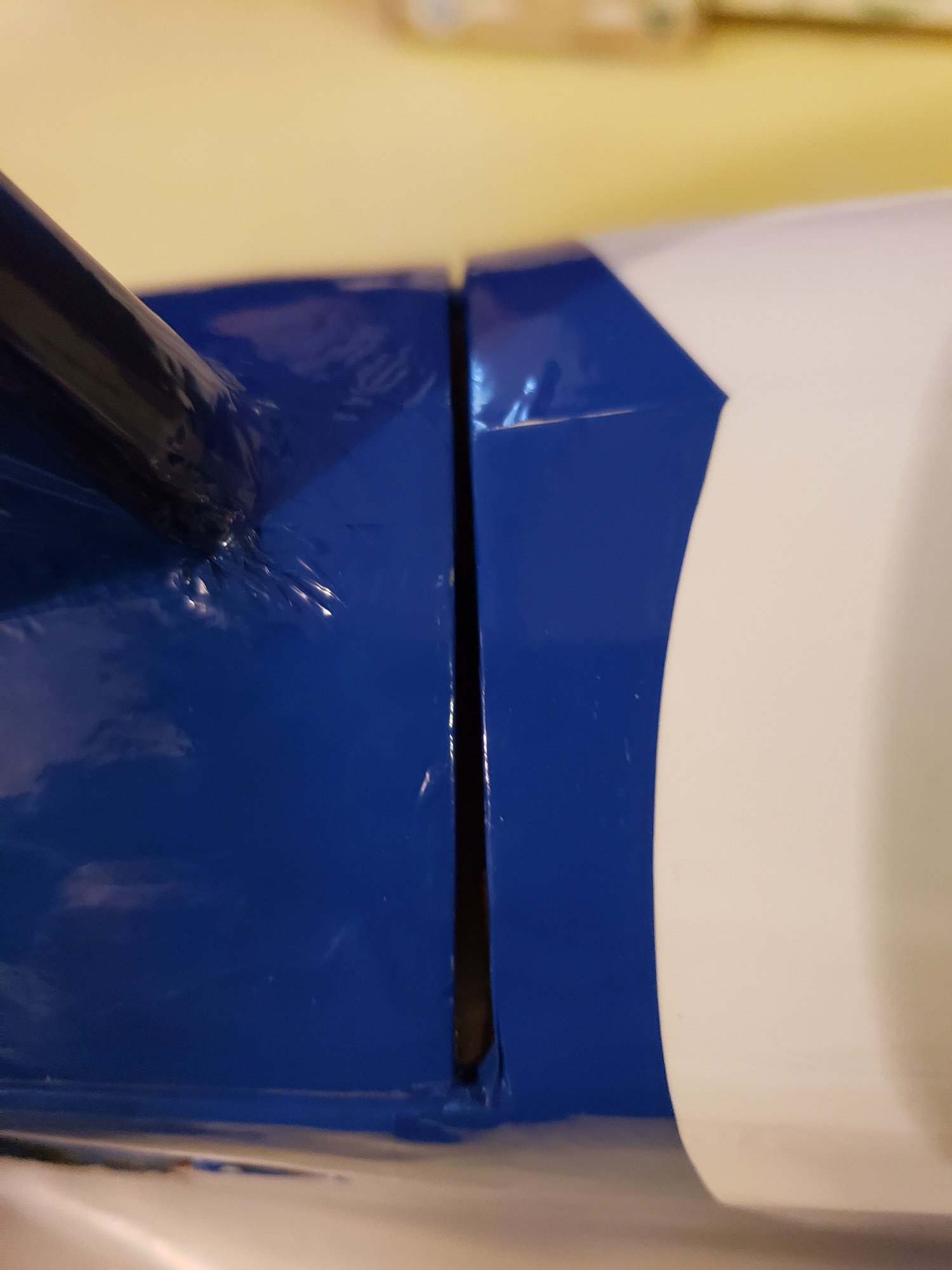

Did any of you have problems with the canopy fitting? This is my first gas plane in a while since I went to all turbines but I liked the look of it. After going over some of the parts it seems H9 has lost some quality on their build up planes. I use to own several H9 planes and loved the quality and parts fit. This one has me a little disappointed. Just hope it goes better once I start assembling

My parts fit is absolutely terrible and II' being nice.
This is the gap between the rudder and the fuselage

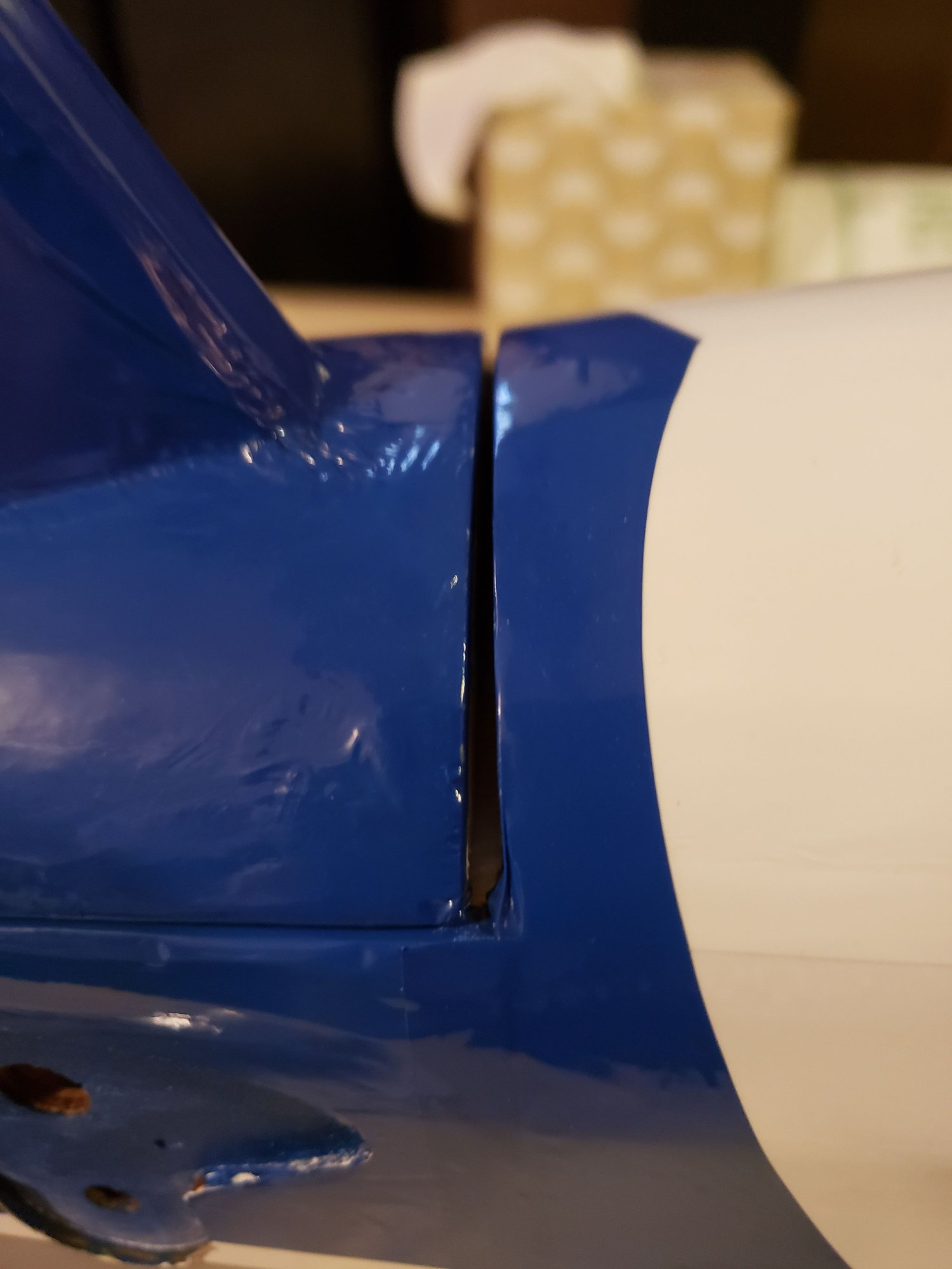

Here's one more
