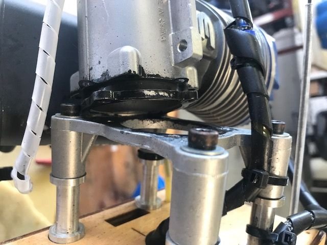

Had a mate who is good with aerobatic models check over the RV, based on his tests he confimed my own thoughts that the CG was still too far rearward, around the 30% of MAC but still forward of where the manual states.
I move two battery packs forward and re-checked CG, now is spot on 25% MAC.
Test flew and very solid in the air and surprise surprise it now longer balloons up under full throttle.
And thats when the fun started.
I did a stall turn it is sort of flipped at the top, blamed my dumb thumbs then tried a loop and it corkscrewed at the top which ws very wierd. I then noticed the engine note was odd, though muffler may be coming close and there was a metalic sound to it. Brought it in for a landing safely though it was quite squirelly on the approach. As I am taxiing back in I could ehar the "noise" again and noticed the muffler tubes bouncing so thought it was loose then saw the spinner was wiggling all over the place - what the? Bloody hell must be the firewall has pulled away.
Got it home and pulled it down to find that the problem was in fact the 4 x 4mm back plate bolts that mountn the engine to the factory fitted radial engine mound ha vibrated out and the whole back plate had pulled out, hence the noise.
The engine is the Evolution 33cc.
Those who have this engine fitted should double check those bolts. I'll be heading to the local nut & bolt place this monring to see if I can get some 4mm x 15mm bolts.
think I was very lucky.
Refer to photos.
