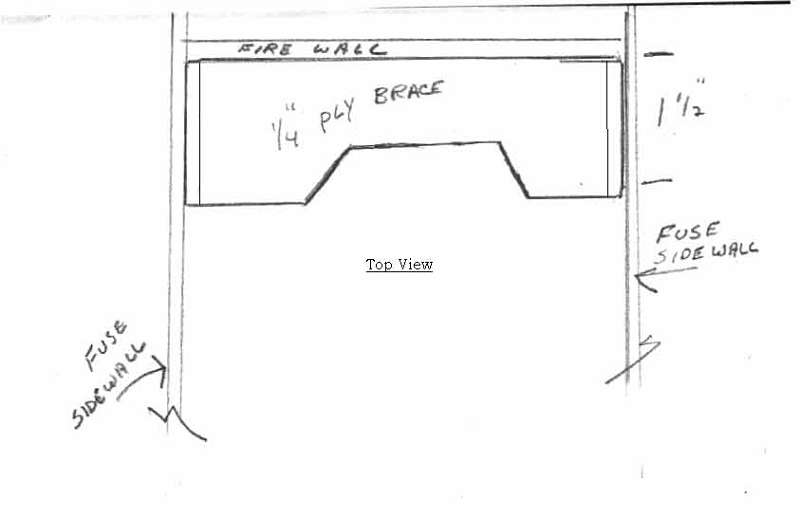

RE: <span class=
I also moved my firewall back 1 1/2 " reinstalled it, fiberglassed and pinned it. Shouldn't come loose now. Am going to reinforce the fuselage on sides as suggested, No opinion about removing foam. Don't think it will make much difference???????
If I were going to replace the turtle deck I would go ahead and bash it into something with the cockpit much further back. Gives it a real sleek look. Landing gear mount definitely needs a little beef but we gotta remember that everything done to strengthen the airframe adds weight and that's what we're trying to get around. Just make good landings.

RE: <span class=
I had a post about this yesterday but it got knocked off for some reason, That's why you see test on my last one.
The fuse should absoloutely be doubled. I went from "F2" right back to the rear of the wing saddle. All stingers have this weak spot, but if doubled they are fine.
I never have removed the foam, but others have some say it was worth it others say no,?????>
I left my turtle deck the way it was and made it removeable, I had my batt. and rec. back there.
Landing gear block isn't really that weak, but that long gear really can put a lot of stress on it. I guess if we all greased our landings we would not have a problem with it...
I did brace the firewall, which I think was worth the effort. I will try to post a crude drawing, then again all my drawings are crude...
