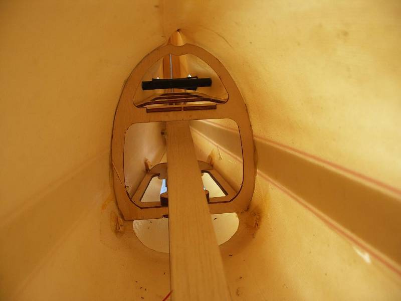

All my mods are complete. No problems found with the stab after delving inside for a look. I did firm them up and Iv modified the main wing connection ( NO GAPS ANY MORE ). I will post a full de-breif after the installation flight to let you chaps see how I got on.

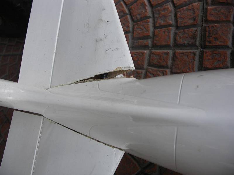

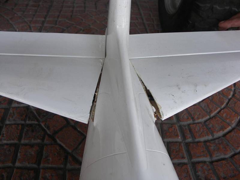

Just got through crashing my Rare Bear, should have read this amazingly long thread.
Built it according to the instructions, including the addendum included in the kit, flew it three times, third flight, decided to see what the beast could do, and bang. The plane did the most violent pull up i have ever seen, accompanied with a very load bang. Thought that was all she wrote, but it didn't snap at all, just went 90 deg straight up. Seemed everything was OK until i tried to control the elevators. Nothing but a very small amount of up, and lots of down. Stripped a metal gear servo real good.
real hard to fly slow enough to land like that, put it in the water at the end of the strip.
Not a lot of damage but enough to write of the fuse and the cowl, and the tail halves have almost come off the plane along with both the rods breaking inside the fuse.

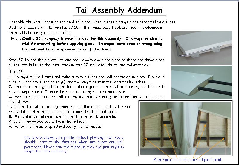

Go back to the TT Dealer here, and guess what, TT has issued a notice to all dealers that the tail fails. I have a copy of this thanks to the dealer. Dated 1 month after i bought the plane, but also 1 month before i finished it. It says that newer stronger tails will be sent FOC to the dealers to be put into any stock they have. Better ribs and planking as well as better fiberglass rods.
Right now i am fighting to get the kit replaced, we will have to wait and see what happens.
I really should have read the 51 pages here first. Will do so in the future before i buy any new kit.

Not sure if the tail failed and killed the servo, or the servo failed and broke the tail. But the tail is broke big time. Hanging by a tread. Both halves pulled away from the rib that is glued to the fuse, as well as both of the fiberglass rods breaking inside the fuse.
Never before have i seen such a viloent pull up, without the snap. The Sukhoi i had before this one was a pig for that. Dont loop unless you are real sure where the ground is. Too much up, and thats all she wrote. But lots of fun in a snap roll.
I am leaving the wreckage as is until TT come back to me about the replacement or not. So far looks like it might get replaced. The notice to the dealers i have shows that they have been listening to the people who fly the planes. More wood in the ribs (3 layers) better planking and thicker fibergalss tubes. All for free to the dealers to put into the kits they have in stock. Doesnt say what to do if the kit is already built or crashed.
As for the tank, i put it under the retract servo tray as well. Three flights, (the second trying to see if it would climb straght up) and i didnt have any issues with the engine (OS 90).
The retracts are TT as well. VERY flexible on the ground. With the Sukhoi, if i was landing too fast i could power slide the beast to slow up, definatly not with this one. I guess if the retracts were more solid the mounting could become a problem. My thing is, it looks good flying, why worry about what it looks like when is is on the ground, as long as it works.
If TT come good with a replacement, the tail will get opened, checked and strengthened if needed, and there will be two micro servos in the tail halves. I want to keep the linkage as short as possible. I intend to use ball joints linkaeges from my helecopter to reduse the slop.

Good news! Just got the new and improved stab and rods for my TT Rare Bear and must say that I am VERY happy with the revised pieces. They appear to be quite stout and I will not hesitate to use them. The sheeting is rock-hard.
I can hardly wait to get it finished and in the air!

OK here goes.
The three pics are my tail, didnt come all the way off, but the servo was trashed, and the control linkage was bent, so i had only a very small amount of up elevator.
The document was sent by email to distributors in the form of a power point. Screen shot it into JPG.
So far it has been three weeks since it went in, and TT still hasnt made the desicion either way to replace the kit or not.
Hope this doensnt mess that up. Oh well, what ever.
